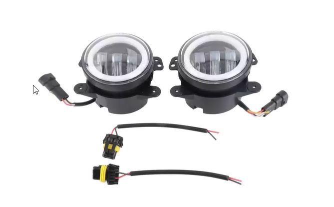

  9. You could try this EU supplier, know others in the forum have ordered ok from them. They trade under a couple of online names Check and enter your Reg no, as not sure I have specifed your exact model in this link. https://www.autodoc.co.uk/spares-search?keyword=HEADLAMP&maker_id=111&model_id=1972&car_id=28327 No idea if they are for LH or RH, assume you need the actual UK part number to be sure ? You should be able to find the part no here, agian check your exact model. https://www.megazip.net/zapchasti-dlya-avtomobilej/toyota/corolla-38234/ee111-54077/ee111r-aghdkw-921612/headlamp-17876795
  10. If you search on those names it will show you those mentioned sites, then just select your car type - eg https://www.megazip.net/zapchasti-dlya-avtomobilej/toyota/corolla-38234 You might want to PM @Flash22 if thats not what you want as he provided those links and is very much into all these part numbers and sites.
