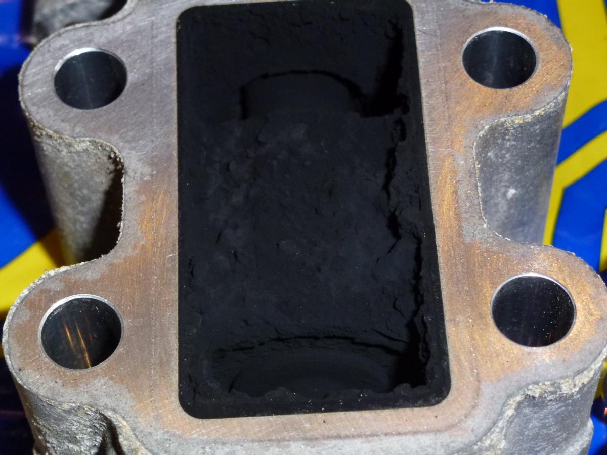

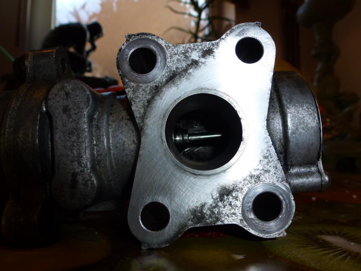

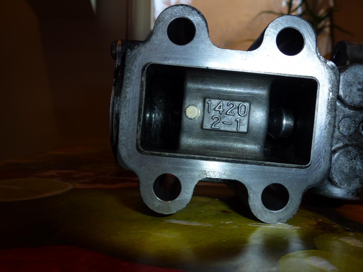

Update on my power loss problems: Today I removed the Egr and it was really coked up and almost blocked. Gave it a thorough clean and flush with carb cleaner , fitted new gaskets and reassembled it. Only took 1 hour to do everything but alas the fault is still there . It is 100% temperature related as the first 5 minutes of driving from a cold start the car is faultless and drives as fast as you wish to go. But after 5 minutes the rpm won't go above 2000rpm or approx 50-55mph. Someone has suggested it could be the 2 Suction Control Valves (SCV's) as being the likely fault or even the Boost Control Valve. Anybody know if these could cause my fault ? and where the SCV's are located on my 2007 2.2 D-4D corlolla verso. It is off to the garage on Monday afternoon if it can't be sorted before then . I trust my garage but I don't want to throw money at it if it does not need it. Thanks in advance
The 1st pic shows the EGR before cleaning and the other 2 show both sides of the egr after cleaning.

Hmm filth!
