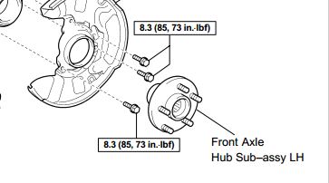

Asking for the front right Hub should be perfectly straight forwards, as they should be looking at a diagram similar to this ; it probably comes with the bearing fitted.

If the scrappers want £72, plus the price of a new bearing that will put the whole hub to over £100 so if Toyotas new price was under £200 I would go for new.
Problem is even looking at such a part, which will naturally be very corroded on the outside, no one can really tell how good the hub is until its stripped and inspected or even not until refitted and road tested.post-95973-0-85513400-1412776648_thumb.j
