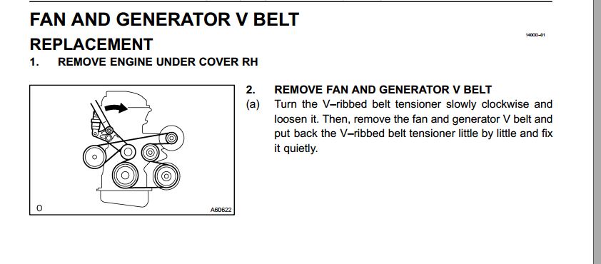

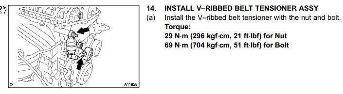

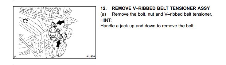

Hi Sammy,
Just pressing the aux belt probably won't show up and wear in that damper as its still under tension.
Its best if you remove the belt and the damper assembly so you can check the joints without any load on them.
You will need an extension to the spanner to release the belt, its surprisingly tense.
(is your belt due for replacement anyway - mine was at 8 years old)
Removing the damper and arm, just 2 bolt/nuts, is easy and allows yo to properly inspect the joints and also the black idler; seems its bearing can be a sorce of noise if badly worn.
As said, I cannot understand how such wear could cause the judder, but cannot see that guy bothering to post about it if not.
These pics might help...

Good Evening
Thank you for those diagrams mate, much appreciated, I might give it a check once I am done with the drop links, then again I might just leave alone, the belt is still good nick, hardly any sign of wear, its a Gates so they normally last like forever, but going back to the tensioner...its a real shame that they don't sell just the shocker looking thing instead of having to buy the whole arm with it, at £80.00+ it isn't cheap.
