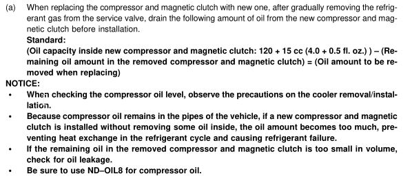

Don't know anything first hand about A/C but everything I have read shows that to replace a compressor you need to have the old  refrigerant  removed properly and then new refigerant recharged afterwards and also the right amount of oil for the compressor, similiar to a 2004 manual  below .
Have you done all that ?  is the replacement compressor a new, recon  or a proven good s/h one ?
