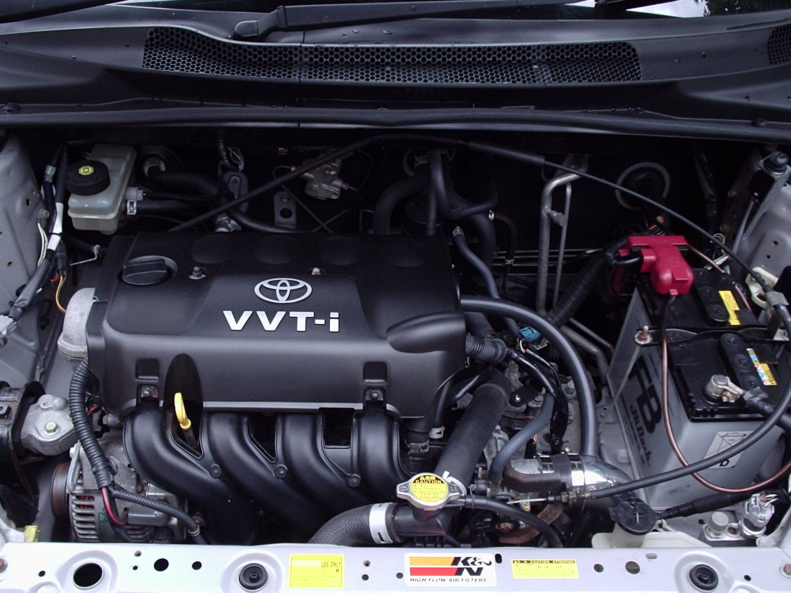

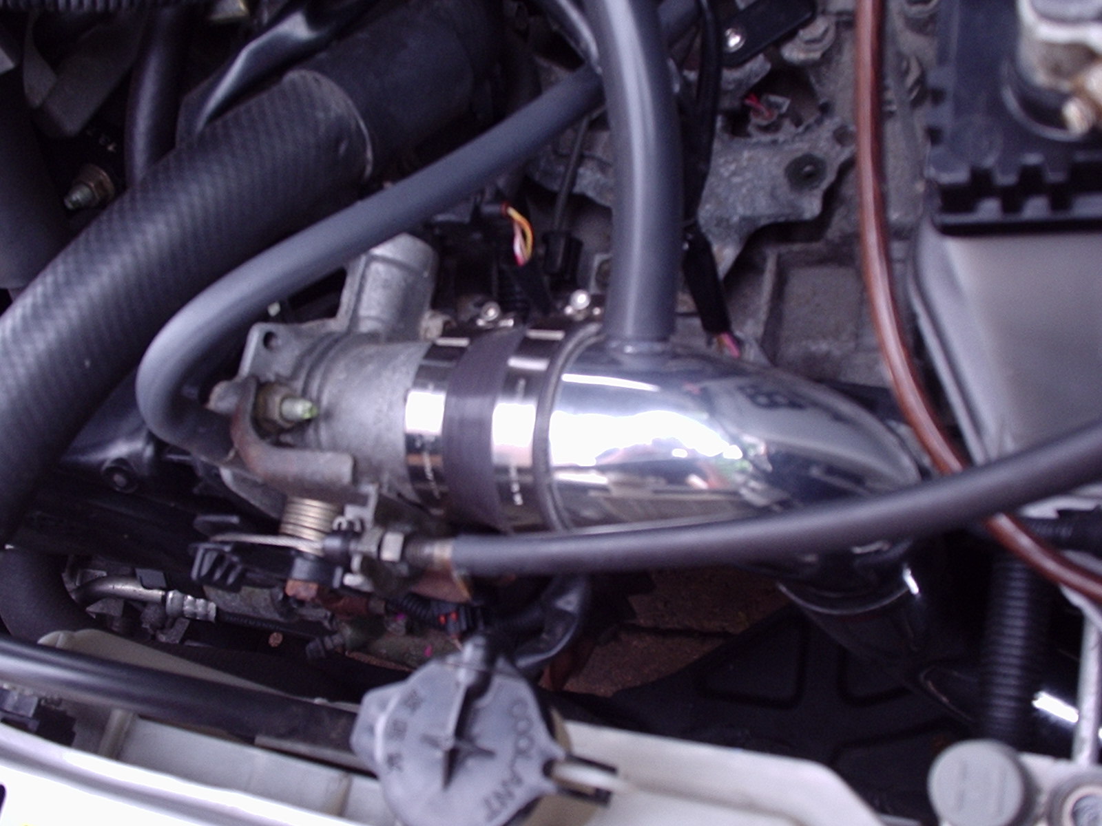

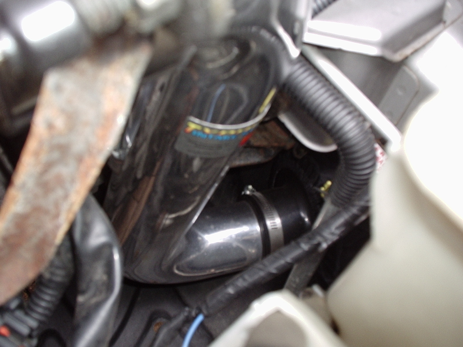

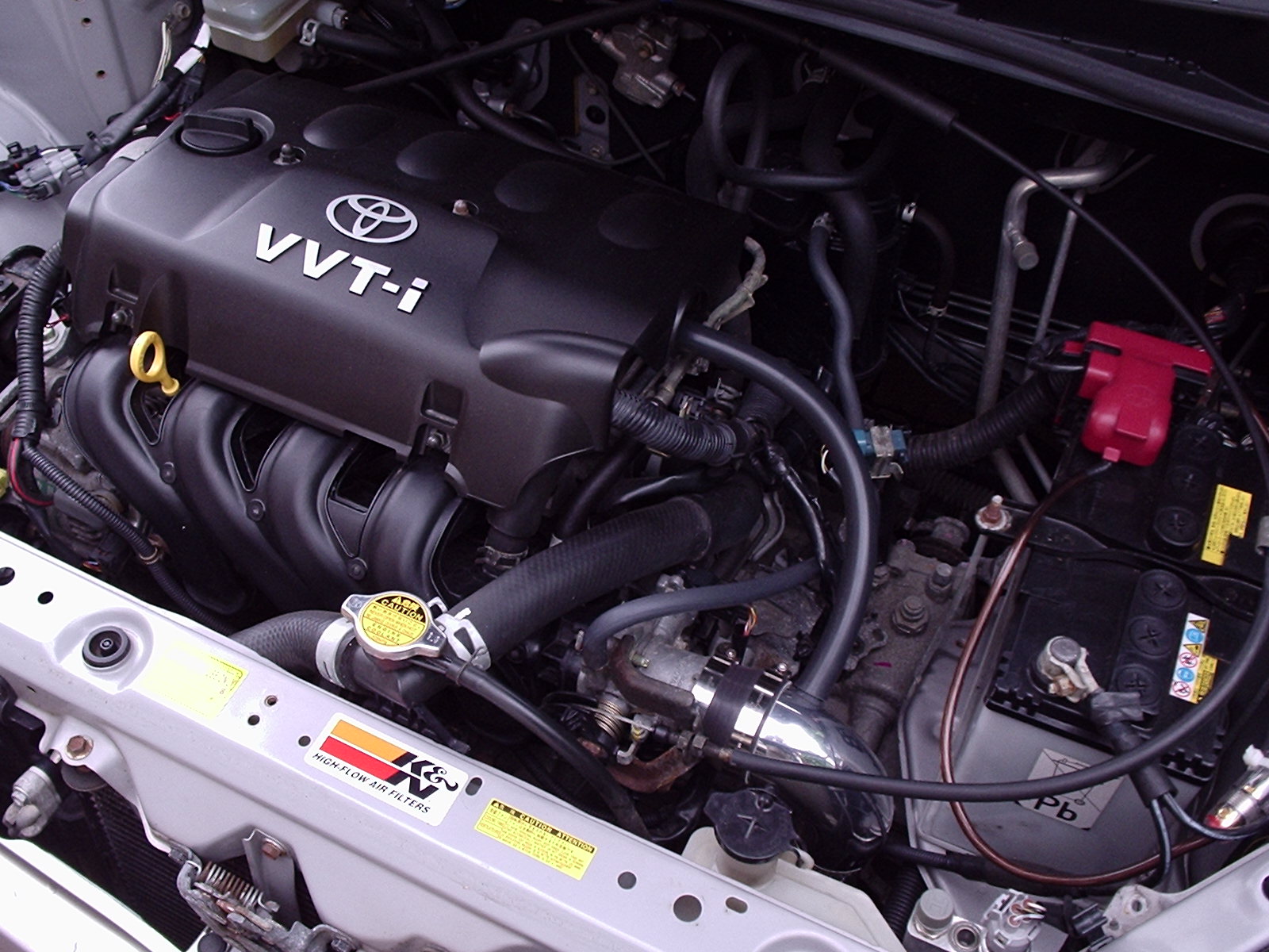

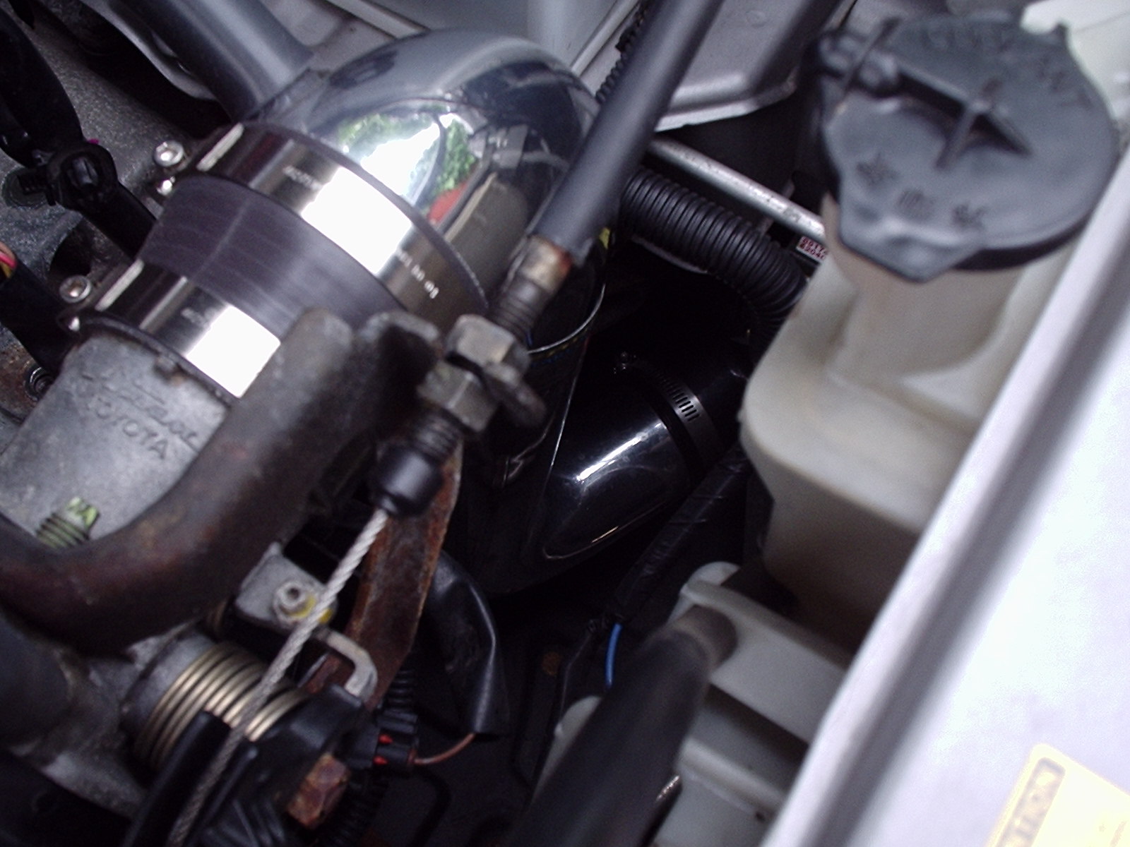

ive got a K&N Typhoon induction kit. and id seriously recommend it. Big difference in power and a beautiful sound.....sounds like a scooby in 4th doing 30 with your foot down! mmmmmmmm pictures attached
