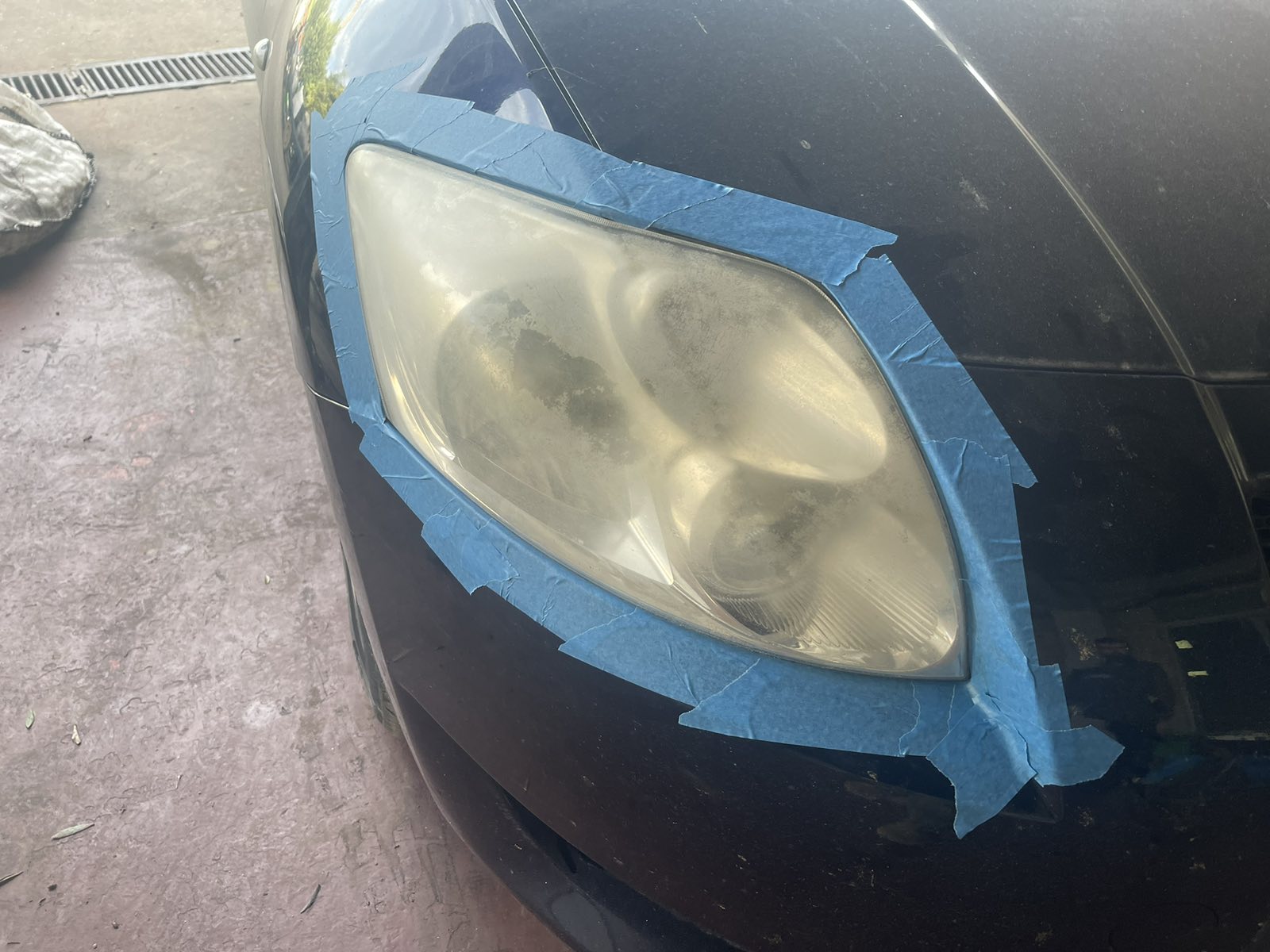

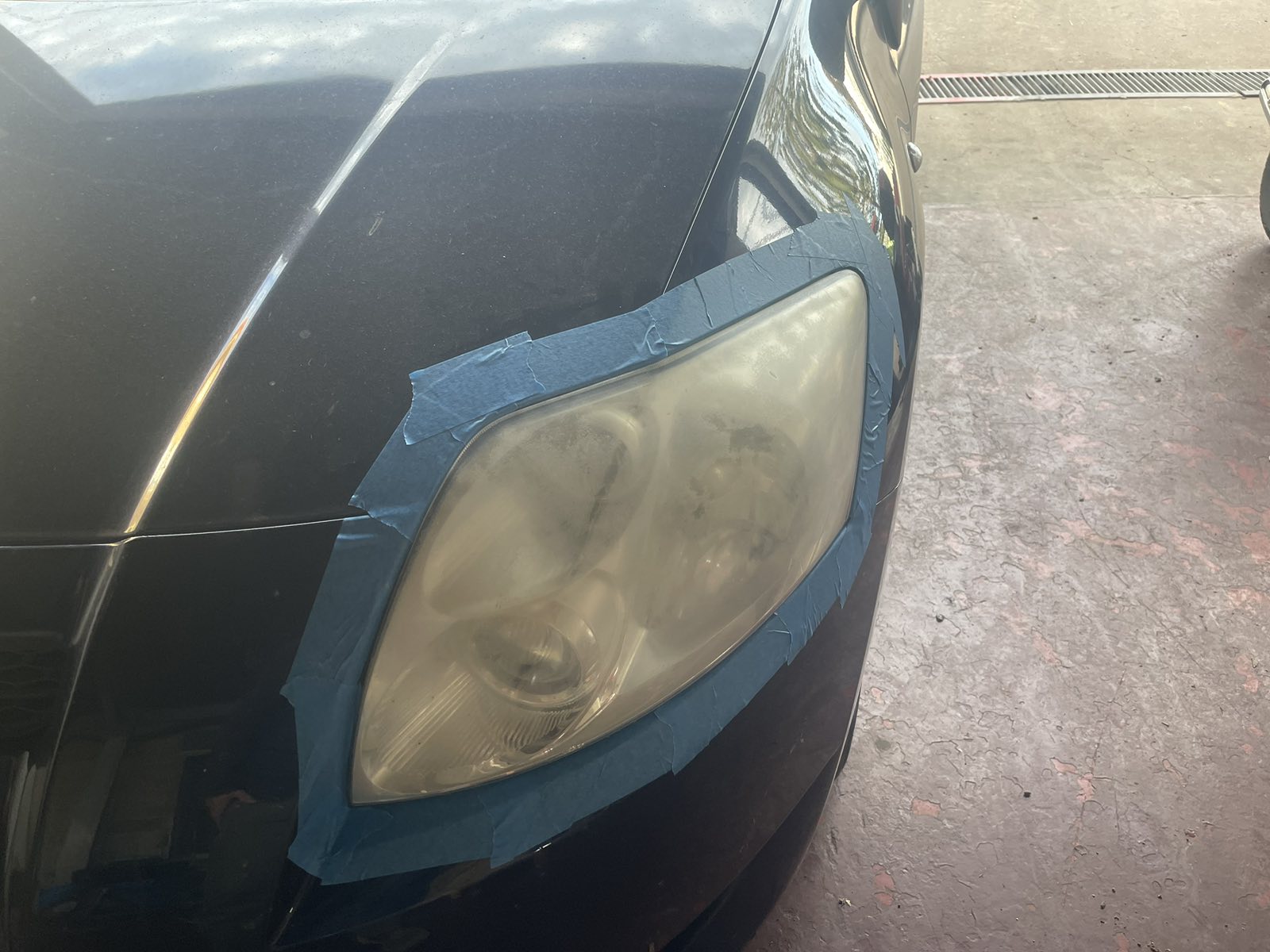

- Start by covering the bodywork around the headlights with masking tape.

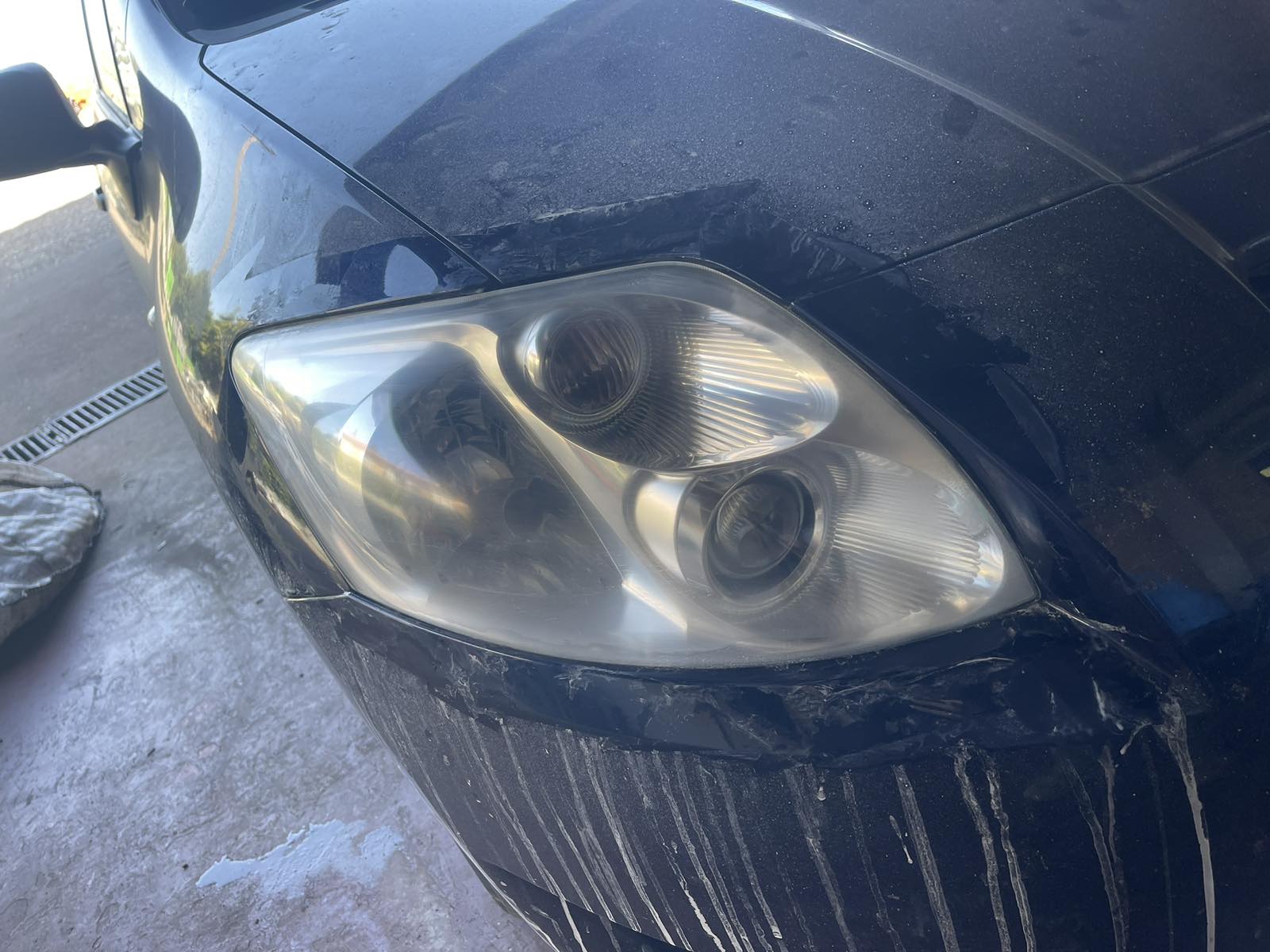

- Spray water and start sandingBegin with 400p move to 600p then 800p and finish with 1000p.

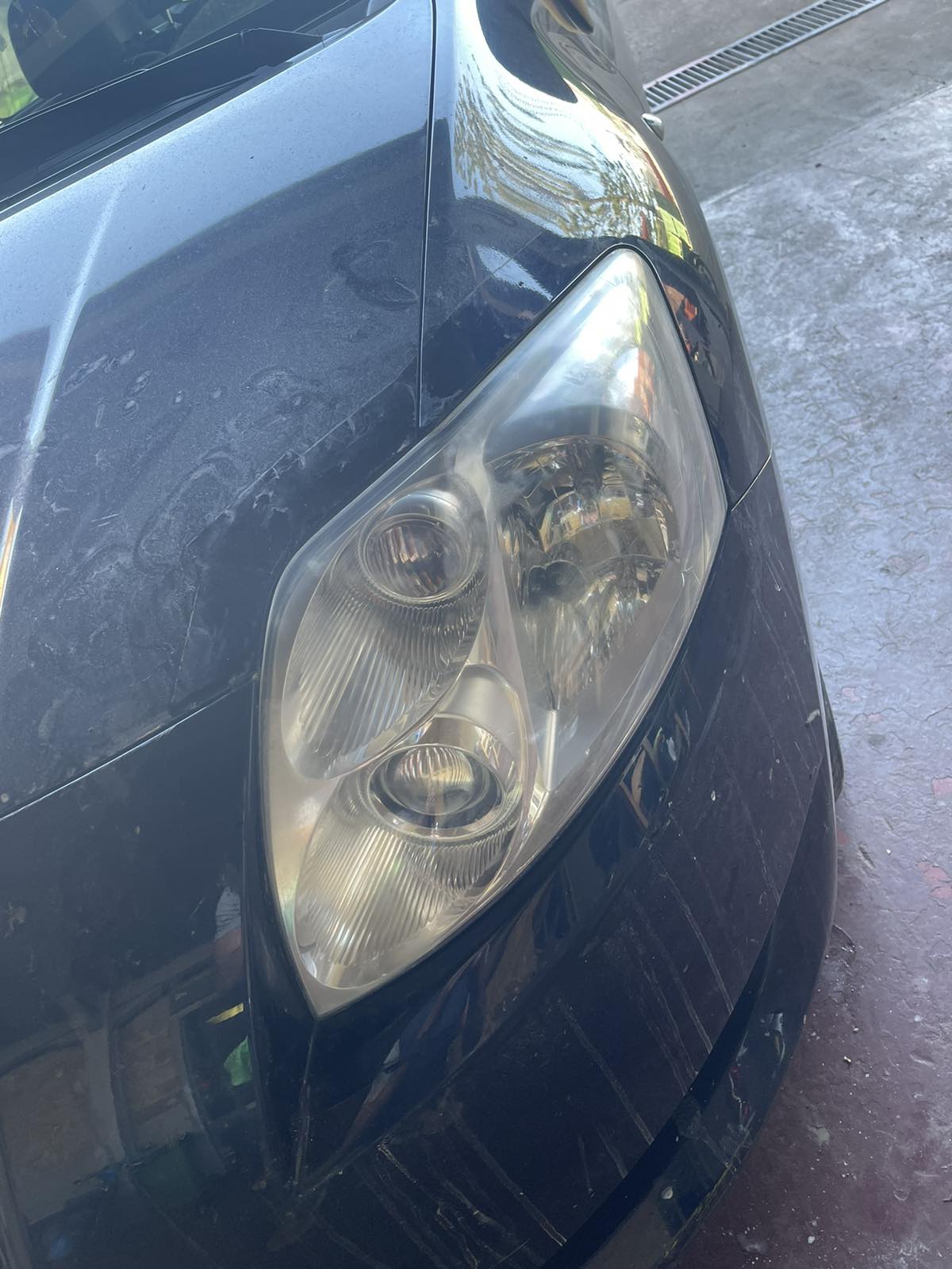

- When you finish give it a good wipe with a microfiber towel.(It should fog)
- I am using(Bosch Professional 12V System GEX 12V-125 Cordless Orbital Sander) to aply BODY POLISHING HB BODY 805 - super cut HB BODY 806 - power polish - 807 SEAL POLISH it is a 3 step and you should use the correct polishing pad for each cream
- Finish by wiping with a microfiber towel to remove any left over cream and you are done!
