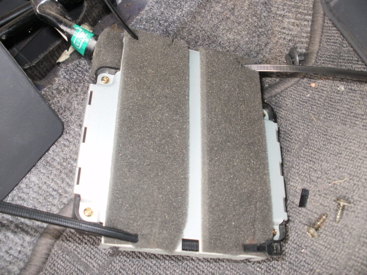

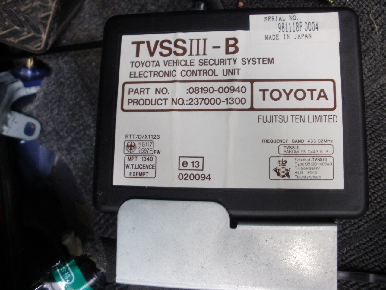

Thanks MrBilly I done what you said up untill "you will see one rivit and a screw" I cant find them. I've included pics in case we have a different system. There are 4 small gold screws on the back of the ecu which i did take out but to se if I could get access but could'nt. This is driving me nuts :ffs:

hold the box like a sandwich, 4 screws on the bottom and tvss label on top. on the first pic you took there is a metal plate(lower part of the picture). have that facing you and you will see a rivet and a screw. the button is behind there.

Mrbilly your a star. The Rivet and screw were hidden by some protective sticky foam but i got it. Many thanks :yahoo: and the alarm is working a treat. ps thanks again to Goggy for donating the fob.
