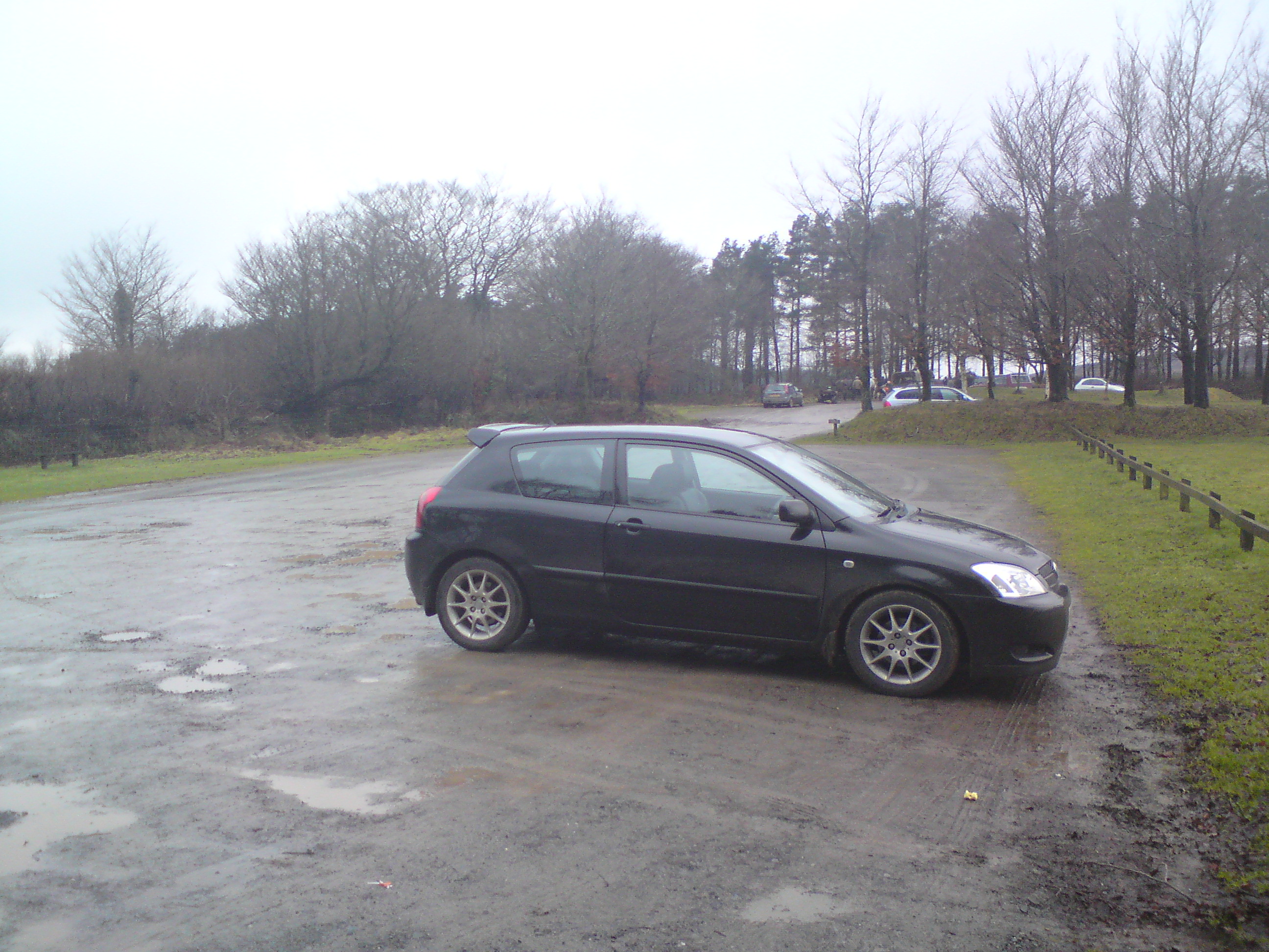

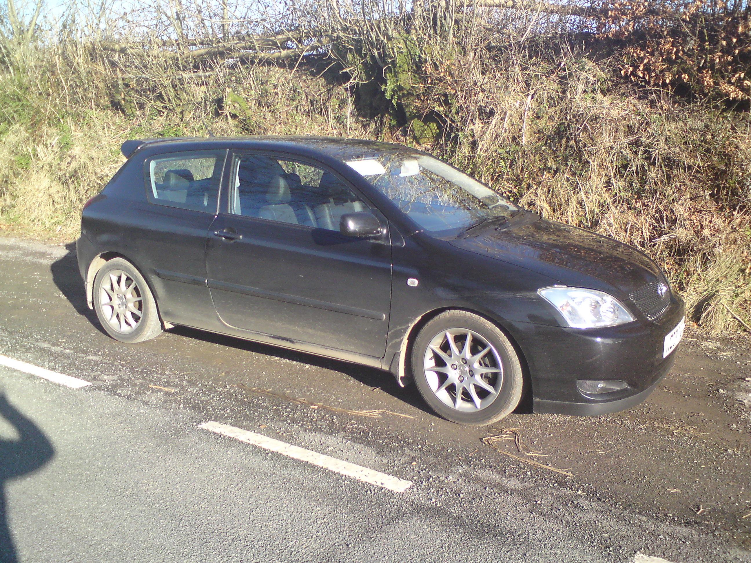

This what i'm after
So you are using Eibach pro kit springs on standard shock for 23000 miles, no alignment done and tyres are not scrubbing?
If so i'm surprised but chuffed at the same time, standard shocks must be very strong
Any more pics please?
Thats awesome man really appreciate the info and the pics, i'm still a bit surprised it doesnt wear tyres unevenly to be honest!
Sits nice too, not too low, not too high, good stuff.
Whats it handle like?
I see you have Typhoon too, is it really loud or just nice?
Oh believe me the Typhoon is loud... ooh Lift with the Typhoon :drool: !!! :yes:
no worries glad to be of assistance . it handles much better than standard.like you say its just the right height .never any problems with speedbumps etc.add a whiteline rear ARB for even better handling.the typhoon sounds slighty deeper than the usual engine sound when not in lift, when in lift it is quite loud and the sound is very pleasant.throttle response is improved and the car is easier to keep in lift.i highly recomend you get one.
Winner winner chicken dinner thanks again
I'd really like one in black too so that helps a lot

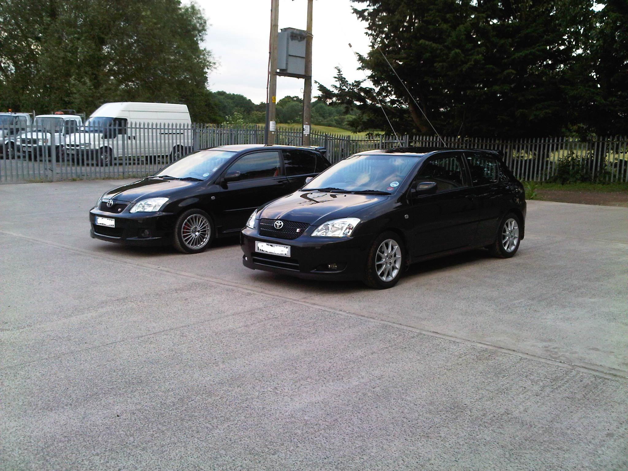

Here are some pics of my car on the eibachs (sorry I can't find any with the stock wheels and the whole car, but I'll take a couple at the weekend when I am cleaning it up smile.gif )....
This is a good comparison between standard and Eibach springs:
Nice one looks good, blue's another colour I wouldnt mind after black.
Are you experiancing the same as the others, IE no uneven tyre wear, no need to have alignment done, no shocks failing just a case of fit the springs and be happy?
Do note that the extra weight due to the longer wheel-base, extra doors (more metal etc.) will lower it slightly more, even if it's by a couple mm. But it's that last 2mm that gives it the perfect stance is it not?...
so ummmm... are you saying that 5dr looks better than 3dr then???? Controversial or what! hahaha
Can't disagree mate, I do prefer the 5-doors! ;)
What I am saying is that the extra weight would surely lower it slightly more considering they share the same suspension? :yes:
However, I do like our CTS I'd prefer it to a 5-door but I'd have Ponzers white FL 5 over it any day.
