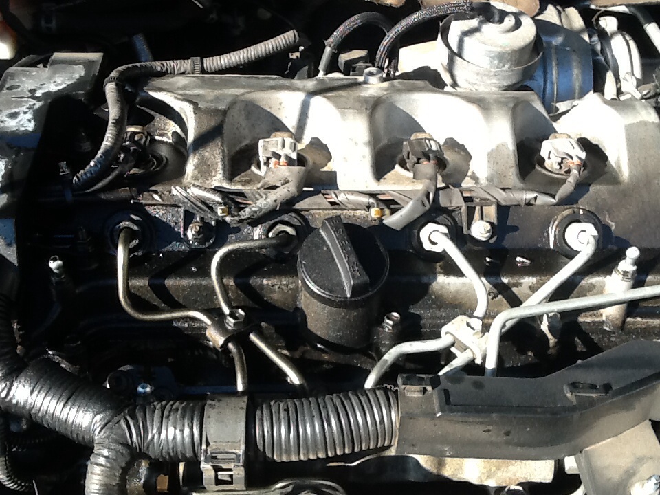

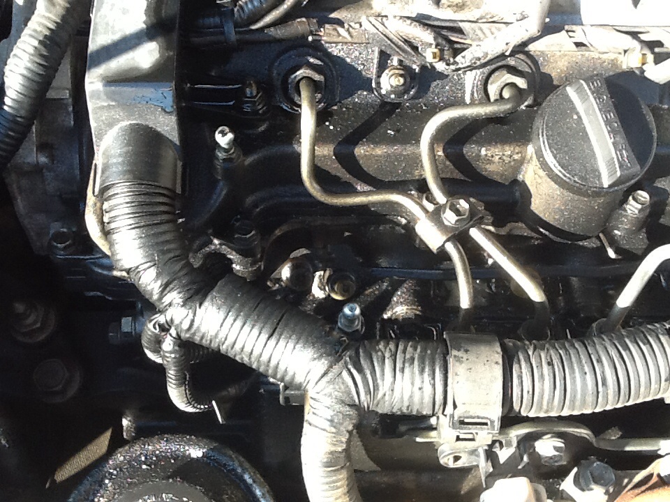

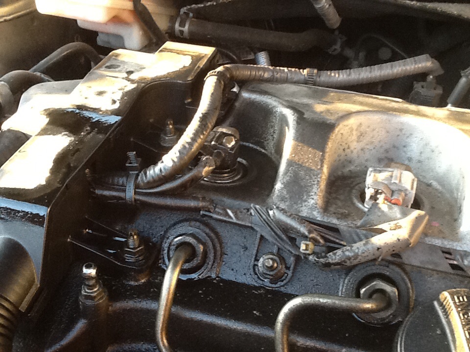

I've just had an injector go. Car was running a little rough yesterday - removed the engine cover and there's injector #1 spitting fuel out, as if the union fitting is not intact. Also the injector seems not to be centred in the injector port?? It seems to be sitting off centre especially compared to the other injectors.
Does anyone have any ideas?
^^ This is a 2.2 litre D4D version ^^

I don't have a picture at present - I never thought of taking one. I'll take one this evening and post it on here.
I have a question though: What do you mean by "popped out"? Surely a high pressure common rail fuel system such as this would be torqued etc. such that an injector could not "pop out"?

They are usually just pushed in and fastened at the top,
You said " injector #1 spitting fuel out, as if the union fitting is not intact. Also the
sitting off centre especially compared to the other injectors."
So from you description sounds like its not sitting in the cylinder head correctly
Yes, I agree, with what my description sounds like. I was querying the possibility of how the injector "pops" out?
From another thread where somebody had posted a diagram of the assembly I see where it appears that the injector is clamped in place. It sounds as if the clamp may have loosened from your description / response.

Photos attached
I hope these are appropriate. If you need any more detail, just shout. I can take more photos if required.

Have you tried to tightening up the union nut on the injector? Is it this union nut that you are saying is not sitting straight?

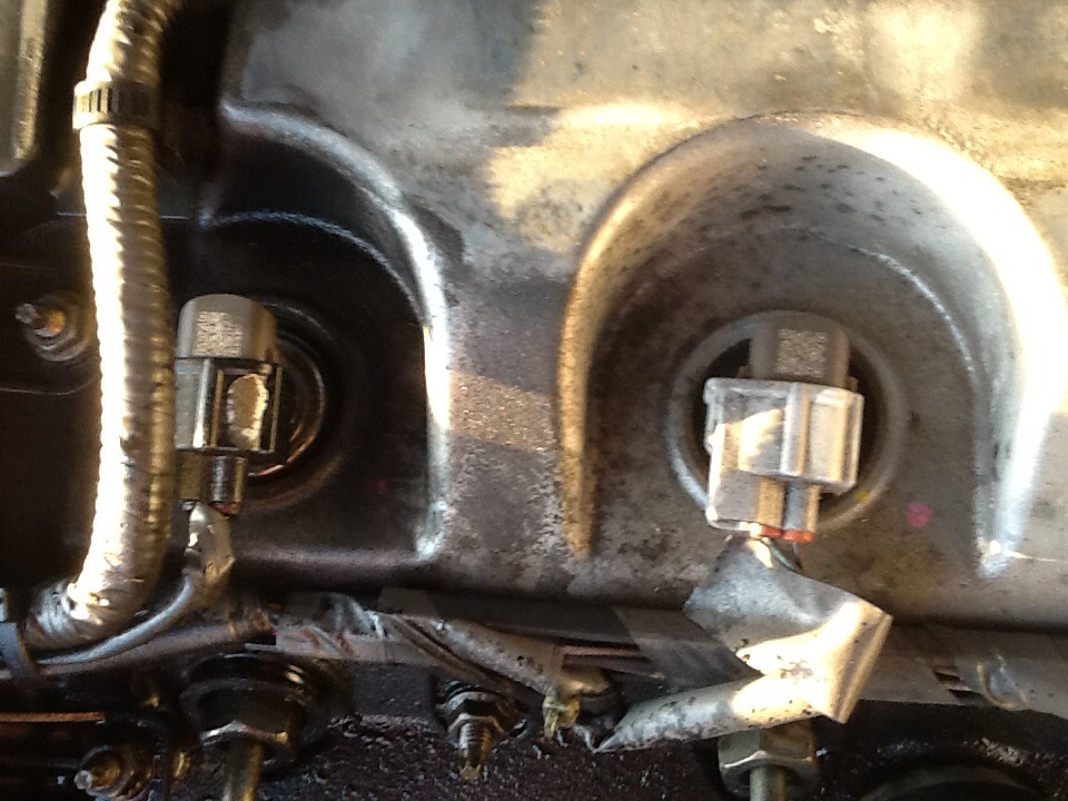

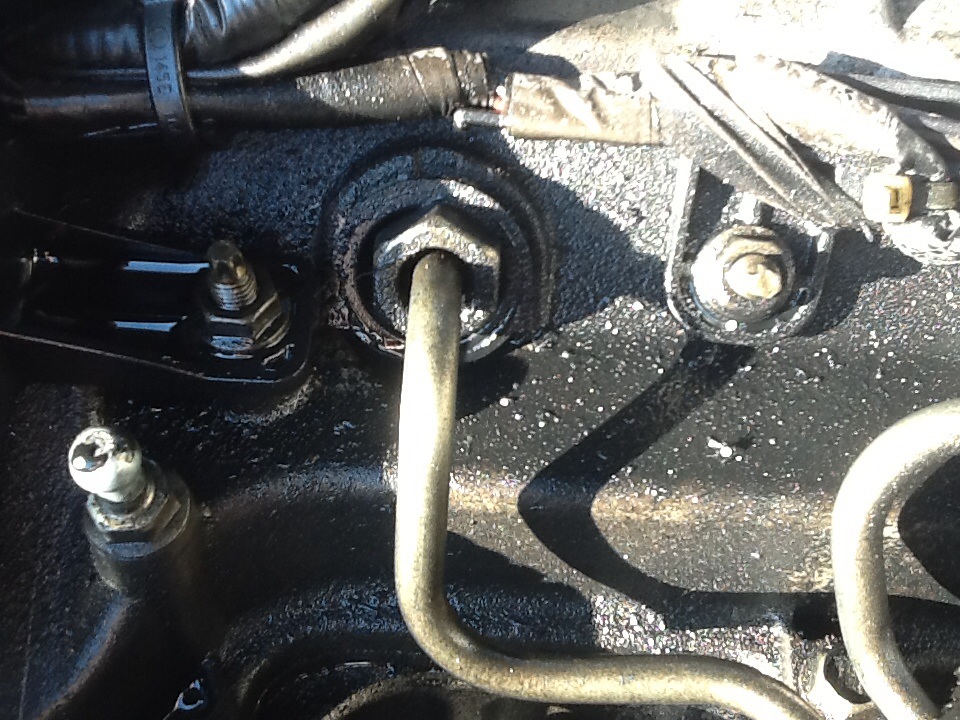

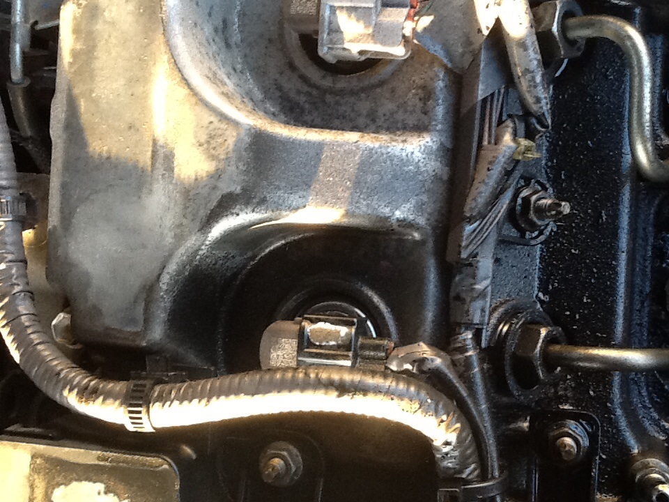

Can you take a picture of #1 injector from the top, where the wire goes in..is this not sitting straight either?
Is it Definitely diesel and not oil spraying out?
what exact year and engine type do you have...
It's a 2006 2.2 D4D - engine type B21? I think.
I was reasonably sure it was diesel spray ....
post-124112-0-35278000-1402949616_thumb.

I just had another check - it's actually oil.
Also as I look at the photos above I notice that the top of the injector #1 (where the electrical connection is) seems to be sitting higher than the other injectors. This, and the fact that the fuel line is offset above the centre of the port, would have me think that the injector has actually been displaced upward.
I did start the car and there was no oil being sprayed out, although this is maybe because the engine is cold?
It may have come loose or maybe a seal has gone? Will it push back down?
I dont know this engine type....im pretty sure you have dreaded 2AD engine....with all the problems.......might be worth looking at the 2AD engine problem sticky in the Rav forum...
heres one with the cam cover off maybe the clamp bolt has come loose?
