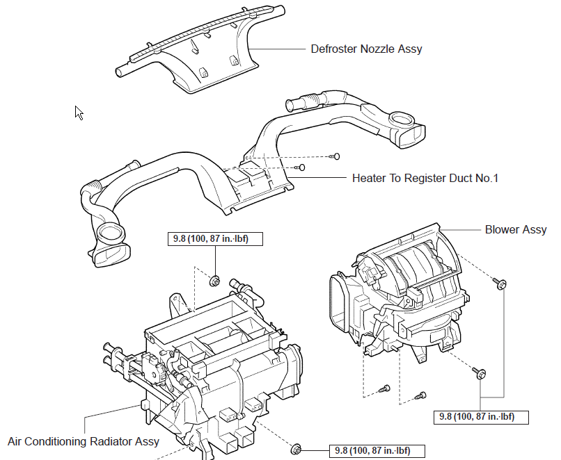

Either the part has been removed by a previous owner, or it fell into the duct and down into the heater/airconditioning assembly.
Anything that falls or rolls into the vents (children... :ffs: ) ends up on, or between, the valves in the heater/mixer unit, making the desired distribution of warm/cold air impossible.
I've added a drawing what the system looks like.
post-84513-044274000 1291065155_thumb.pn
Of course it is, like everything else in a car. ;)
But not without considerable effort.
If something is stuck in there, prepare to take both the blower- and heater assemblies out...
