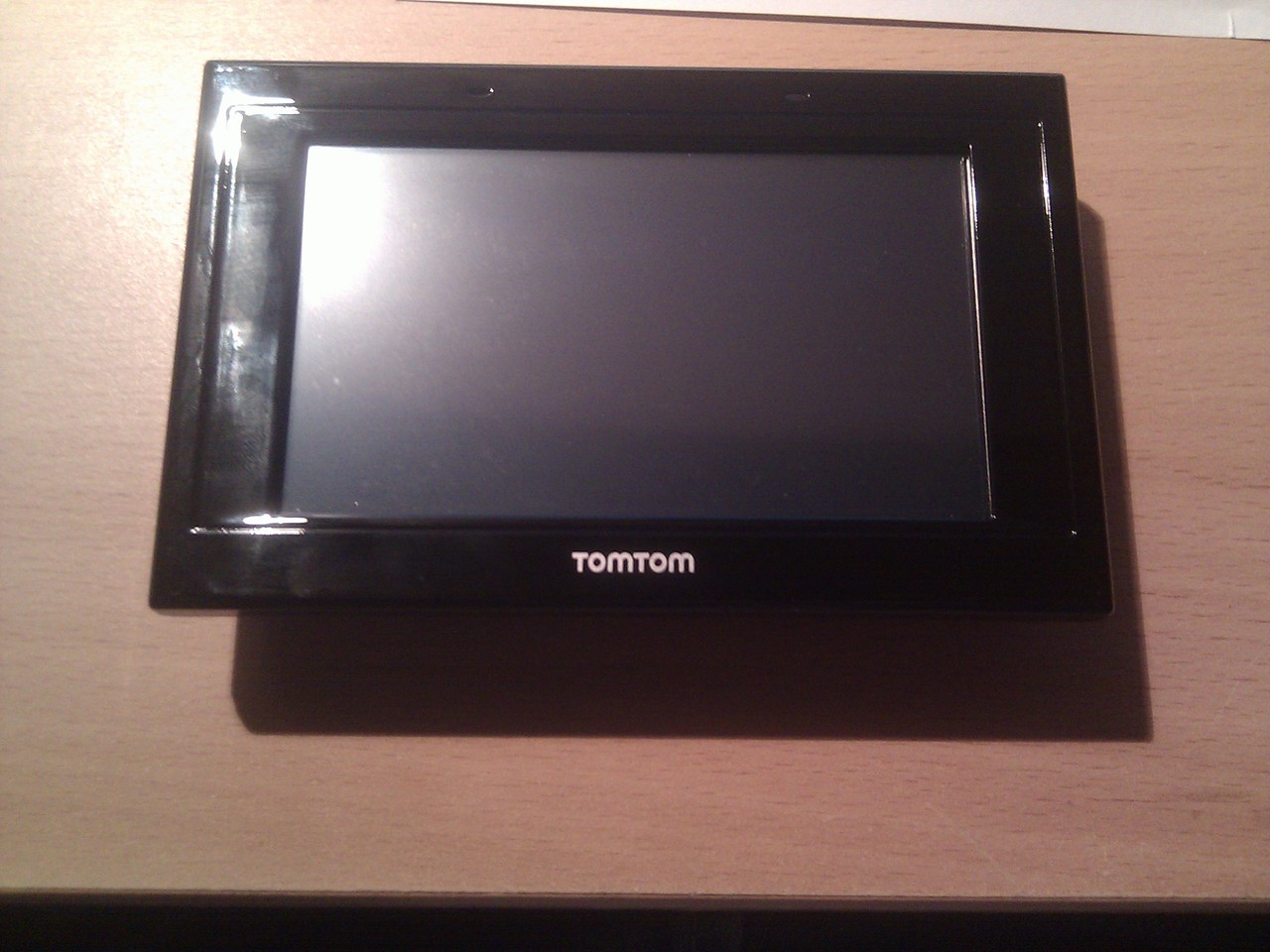

Hi daveinuk,
I have the same issue here in the Netherlands. Just bought a Aygo Aspiration Green Navigator, with a Toyota Aygo Connect Multimedia device/TomTom Eclipse II/.
After my informative calls to both Toyota (2 dealers) and Tomtom I came to these statements:
TomTom: "Based on your type and serial number, your Toyota Aygo TomTom device DOES receive RDS-TMC. It's a matter of connecting it the right way. The Radiocable does not seem to be plugged in correctly. When this has been done in the right way, your screen will show the vertical trafficbar on the right side of the screen."
Toyota Dealer 1: "There's no such thing as connecting it the wrong way. The device is connected the way TomTom instructed us."
Toyota Dealer 2: "The TomTom device was connected in the Toyota factory and we have not too much to do with it. I have not heard anyone on this issue yet. But it's worth figuring it out. I will get into this and get back to you."
My concern is that, despite the fact that the TomTom device has the TMC capabilities (and also states this in the Toyota Aygo Connect Multimedia manual on their! site!), Toyota has gone too lazy on this! I hope there's a workaround, TMC is very useful here in NL!
I hope we can help each other out. I will inform you if I hear something from the dealer.
Grts,
outrage.
