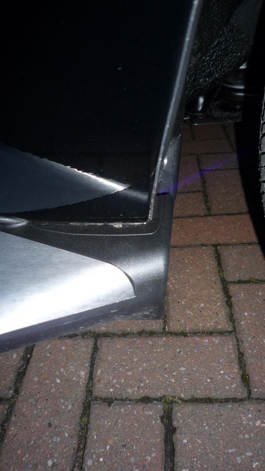

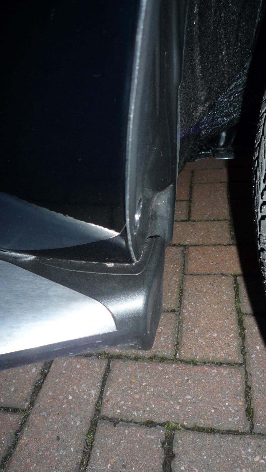

I negotiated the price on the basic car before adding all of the available factory fitted options. Still gutted that Toyota have cocked up the front mud flap fitment with the new “Style” running boards, but Mr Dremel will hopefully sort that issue out :0)
Has anybody spoken to Toyota UK about the mud flap issue?

They consider the car doesn't need mudflaps as the steps stop a lot of dirt. TBH the mudflaps do some good but in the interests of wind resistance they are quite small and you still get a lot of crud slung up the sides.

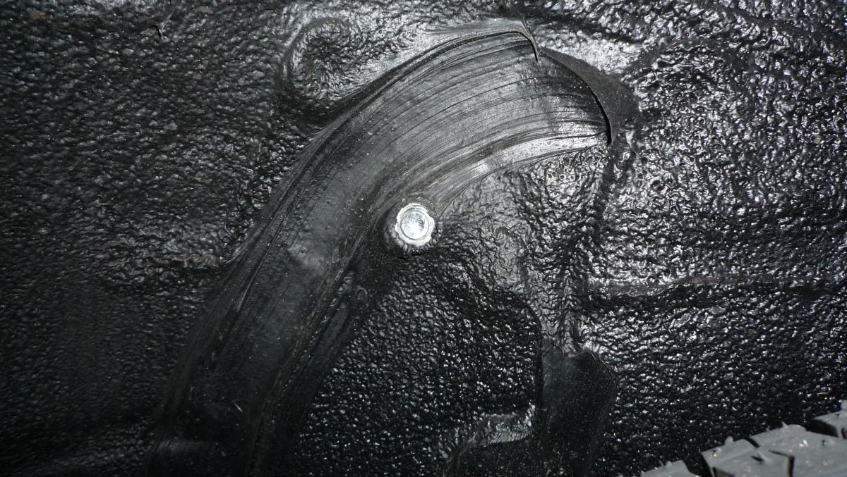

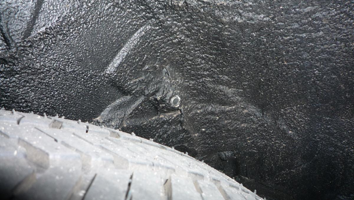

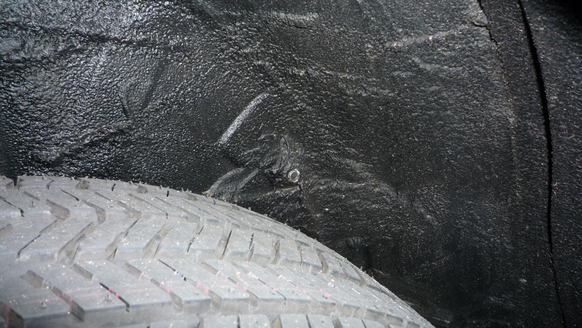

Looking around my new Rav4 XT-R today and spotted a small issue with the underseal in the rear wheel arches. Looks like the body is sealed before the bolts are installed from the inside which punch through the underseal leaving exposed steel bolts. I'm sure that over time if this is not treated you could get water ingress, or at the very least rusting.

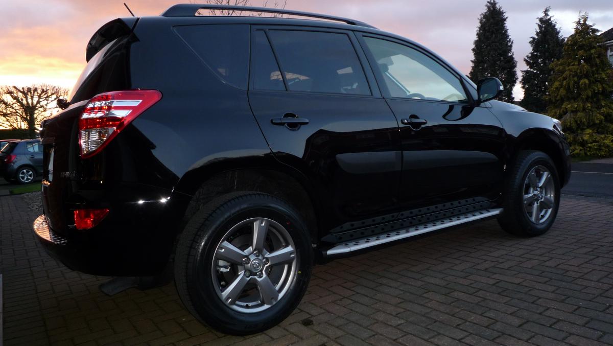

I have also attached a couple more photo's of the new style side step which is preventing the fitting of front mud flaps. There is also a picky of my car :thumbsup:

Looking around my new RAV4 XT-R today and spotted a small issue with the underseal in the rear wheel arches. Looks like the body is sealed before the bolts are installed from the inside which punch through the underseal leaving exposed steel bolts. I'm sure that over time if this is not treated you could get water ingress, or at the very least rusting.
Same on earlier 4.3s too. Good dollop of Waxoyl does the trick :thumbsup:

I am going for it on a dry day, I am going to do a test run a couple of times on a cardboard mud flap :lol: but the only way round it as I see it is to cut a hole in the mudflap that matches the end of the side step.not sure if Hoovie has had a go or even if he has the same issue.
Gus
Fitting flaps to the new type steps really is very easy.. Using a cardboard template wont help as the part You file away with the dremel is on the curved part of the plastic....
Mark out with a sharpie marker pen and cut less than needed. Then pop in the top bolt to ensure the height is right and pull the flap away but leaving the top bolt loose. This will allow taking just a bit at a time away till the fit is perfect...
My 2011 SR has the identical steps so have same issue as you. Can't see it being that hard to adapt the flap but I will be practising on a sheet of styrene first to make a template for one side and can then flip it over to do the other.
Charlie, did you take any pickies of the install that you did please?
Gust, it would be worth taking some pickies and doing a write up. I have have also picked up a set of mudflaps and a Dremel 300 so will be having a go at some point in the near future.
Incidently, I contacted Toyota UK today and had a rant at them about the issue, they told me that I was the first to report it... That I find very hard to believe..!
