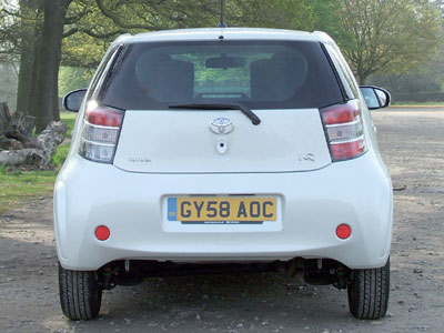

eg, UK model from 2008/9
Here the single white reversing light is to the left, & the single Fog light to the right.

I have the same rear light arrangement as the brits (but the other way around of course, since we drive on the right side of the road).
Clean IQ by afeman, on Flickr
I think the reason for fog light on only one side is that it should not be mistaken for a break light.
would anyone like to sell me their iQ tail light with that rear fog in it? :)

btw you could get 2 light clusters with the double clear sections (i.e. a lhd & rhd reverse which imo would look more balanced) but simply fit a red 21w (or equiv. LED) bulb to provide the fog light.
i actually like the off balanced look :)
