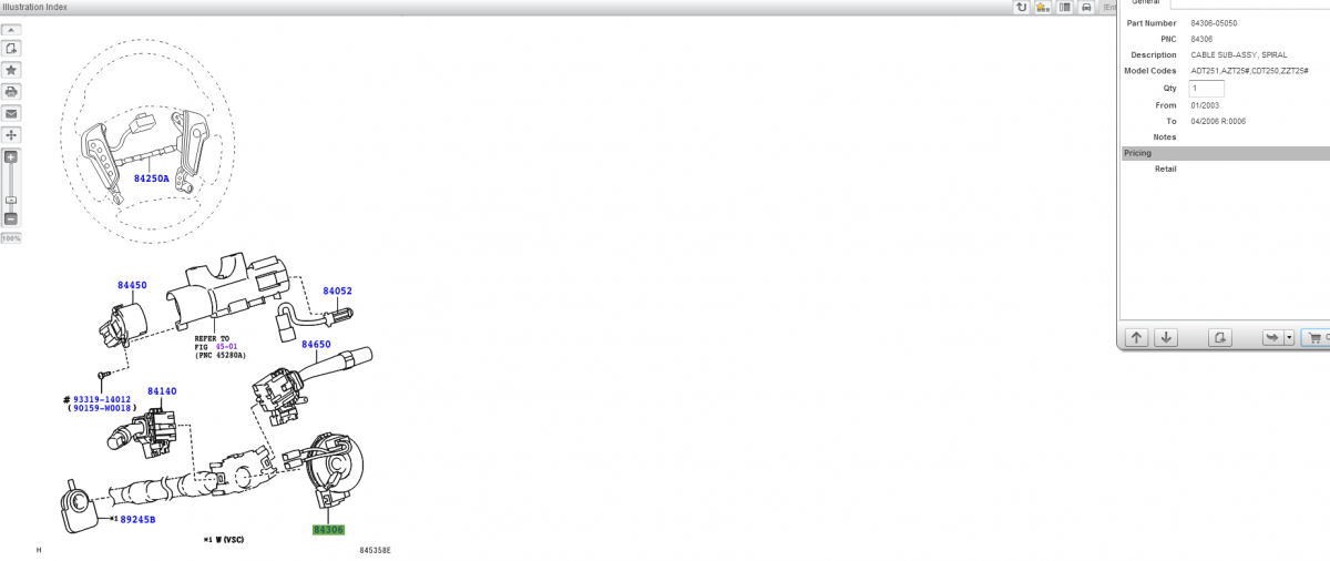

Either the dealer is supplying the wrong part, the part is incorrect in the packaging or maybe part of the old squib is still on the shaft ? PM your chassis number and I can check the part number for you,
Thanks for the chassis #. You should have been supplied 84306-05050
post-45863-0-02713300-1373128922_thumb.p
Thanks very much. I'll check it out.
