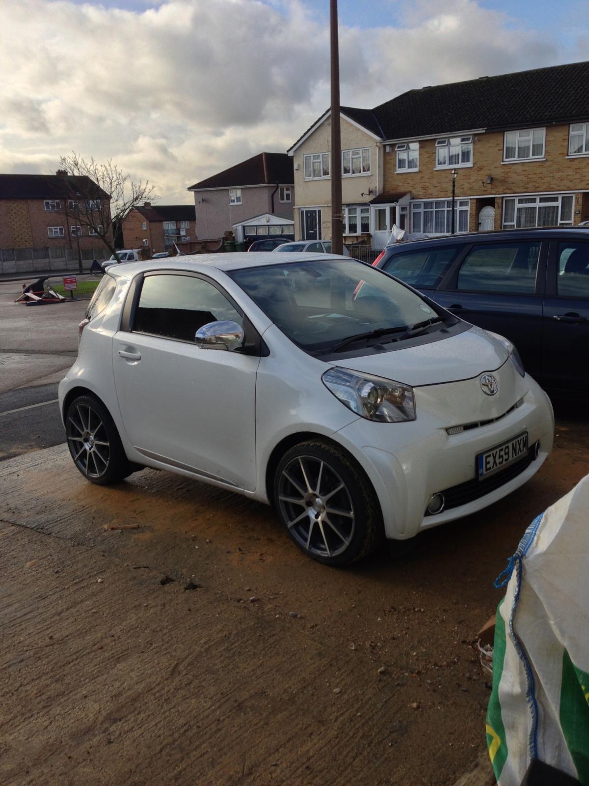

I have 215 x18x35 on mine and lowered. Handling is out of this world
David
post-109788-0-40769200-1374685907_thumb.
