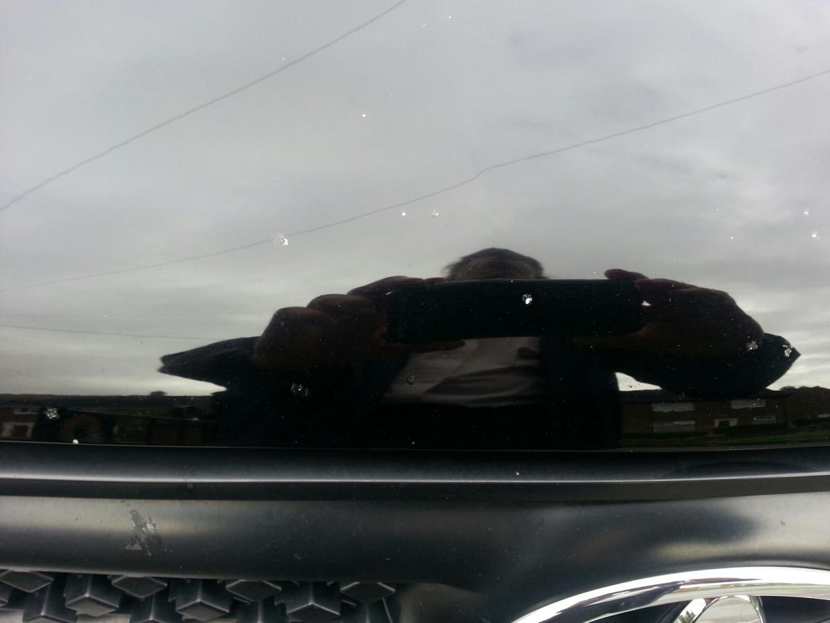

This is the stone chips on the bonnet . . . all the way along the front edge up to about 10" back from the leading edge

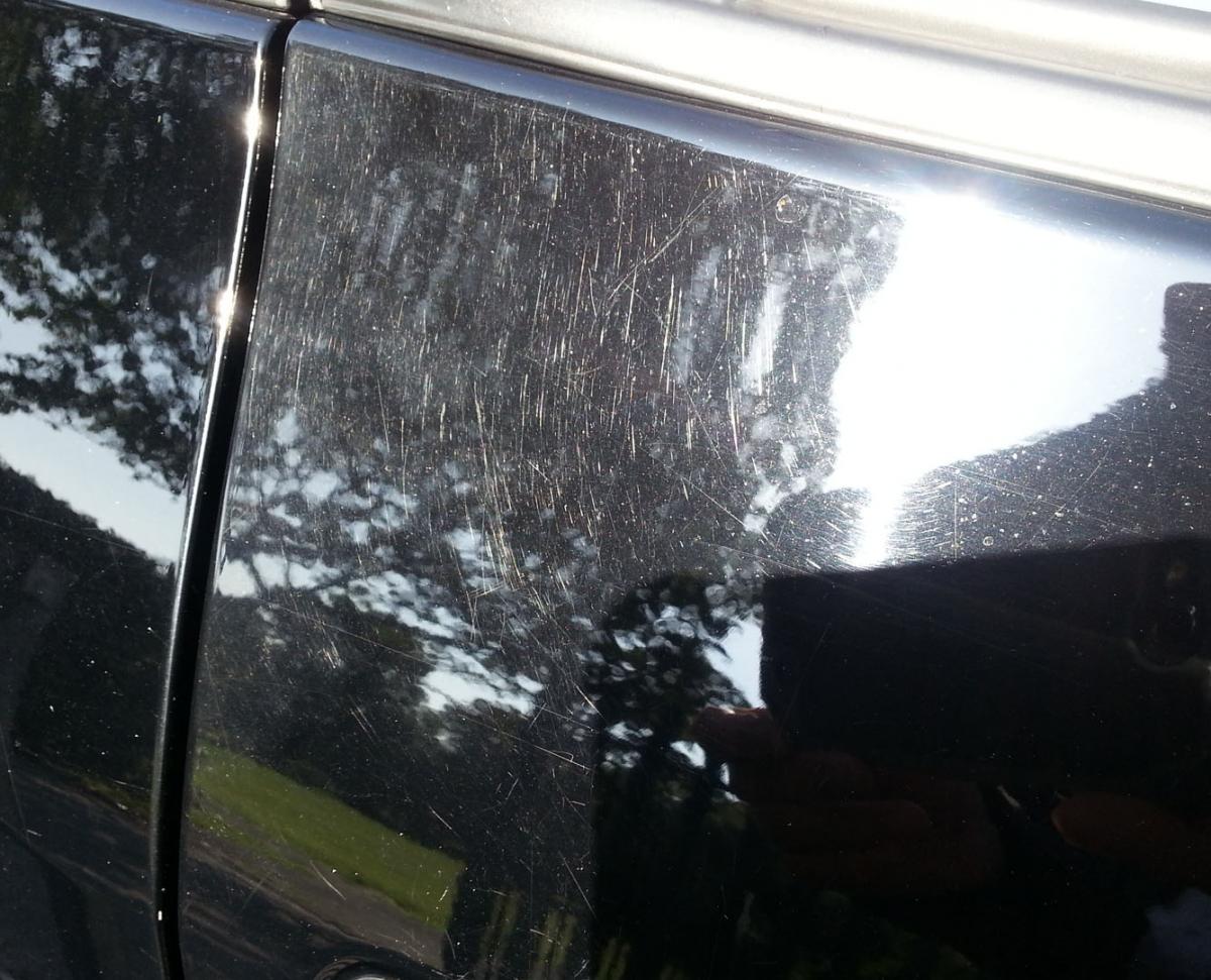

One of the doors have these small scratches (detectable with the fingernail) , and the light scratching in the top left hand corner is fairly widespread, but not feelable

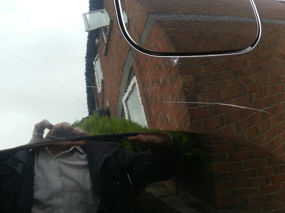

This scratch on the wing is again feelable with the fingernail

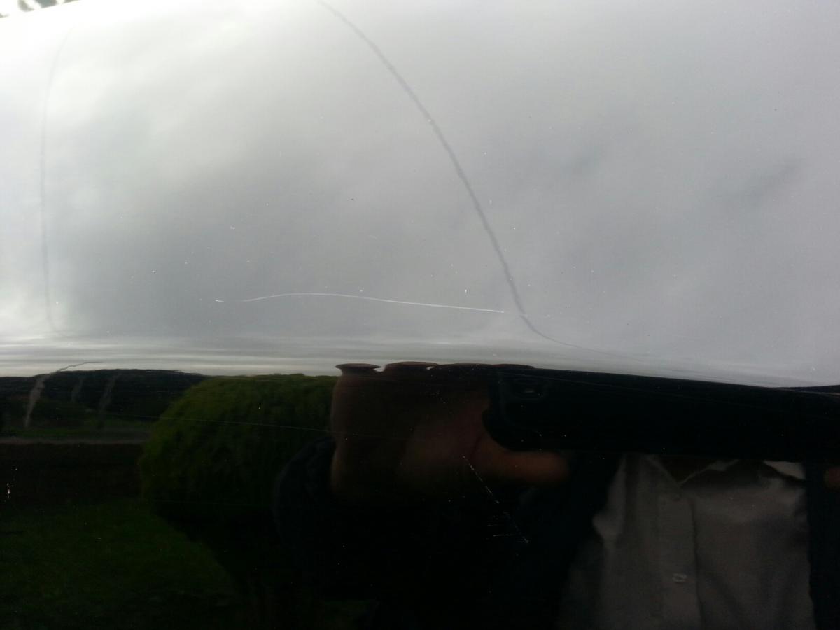

This scratch on the rear quarter is really p*ssing me off no idea where I picked it up, but it's at least 18" long, and fairly deep.

Very bad stone chipping ! Has that bonnet been painted ? Fair bet it has been !
I will be doing a how to on stone chip repairs in the future when time allows but that lot can be got rid of with very careful touching in base coat and topping with lacquer then flatted down with 3500 grit wet and dry then careful polishing. As said that's a topic for later on I'm afraid
Some of the deeper scratches will need a similar treatment as they are showing the undercoat which sits below the lacquer.. But lets deal with the main question which was swirl removal and light scratch correction..

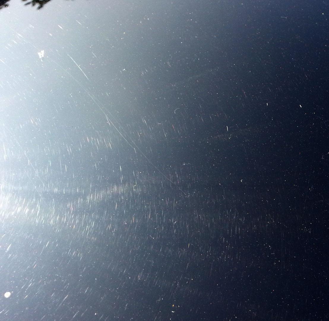

Did you reply before I edited the post and added the two of the swirls taken this afternoon (once the sun had come out to play)? . . . First is drivers door and second is the bonnet, I think the drivers door shows the worst and the bonnet is the best. . . . although the roof might well be better than that . . . but I'm not tall enough to take any pictures of the roof :)

Mate you have quite bad swirling there !
This can be removed with a DAS type machine but would respond better to rotary..
I would start with a medium cut polish. Some may say hard cut but lets remember this it Japanese paint which I repeat is very soft..
Use a medium pad ..
There are two ways of increasing cut when polishing . 1 is the level of cut of the actual polish its self the 2nd is the hardness of the pad..
So lets start medium/medium which will give you a decent cutting/correction rate without being risky to that paint..
A word of caution !! Mate that bonnet has large stone chipping.. This says to me its been painted. I would say the paint on the bonnet is after-market or resprayed if you like. This is indicated by the size of the stone chips. Why ? Well soft paint chips but its not brittle so we normally get just wee tiny marks. When paint is harder and especially resprayed harder paint it chips badly just as on your bonnet. The word of Caution then is to take HUGE care when polishing that area . After market or resprayed areas will cut at an altogether different rate to the rest of the car...
