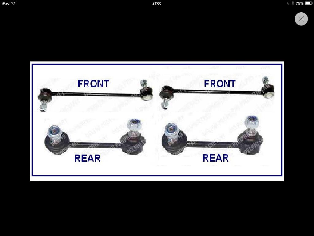

Hi Konrad . No there not anti-roll bars there stabiliser links bars two front & two rear . There short bars with a ball joint at each end, the fronts are longer than the back ones. They might be part. of the multi-link suspension . post-131343-0-34173000-1380571230_thumb.

Those are 'drop-links' they connect anti-roll-bars to the suspension strut. Fitted as standard.
http://toyotamarket.ru/gr/273350/003/2/4803/1/48684A/
They are not a suspension 'upgrade'. There is no reason to use anything other than the stock drop-links

Thanks for the picture response. Yes they are called stabilizer links, but like Gazza, I call them drop links. The anti-roll bar is the stabilizer.
Gazza is also correct that they are standard part of the suspension.
If your current links need to be changed, the job is straight forward and easy.

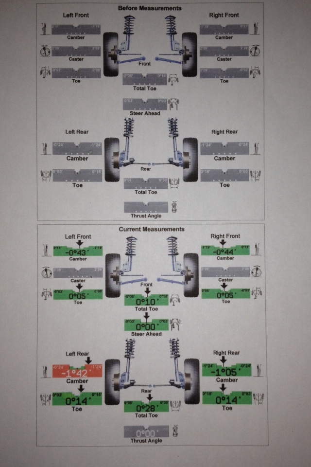

Hi Exvec, took my car for wheel alignment nothing wrong with alignment , the guy who did it said try an extra 3 pound of pressure in forint tyres so I will let you know how I get on attaching the print out .post-131343-0-22957200-1381661319_thumb.
post-131343-0-27637100-1381661352_thumb.
Dog 7 Hi,looking at your print out there does appear to be a problem with your left rear ,on the current measurement part its in red which means it needs adjustment to take it back into the green segment,??they told you it was ok.
