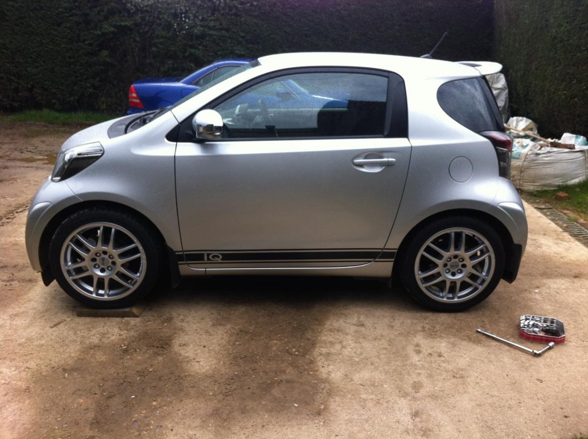

Reason I have never used it is my car is lowered and no trolley jack will fit under the front. Actually it's kind of hard getting the trolley jack under the sides too so I have some short lengths of timber I drive the car onto first before I jack it up.
I also have the rear skirt with an extended towing eye so wouldn't consider jacking on that now either. The extension is a flat plate about 2" long so quite flexible if loaded wrongly.
You can see the planks in this picture.
Craig.
