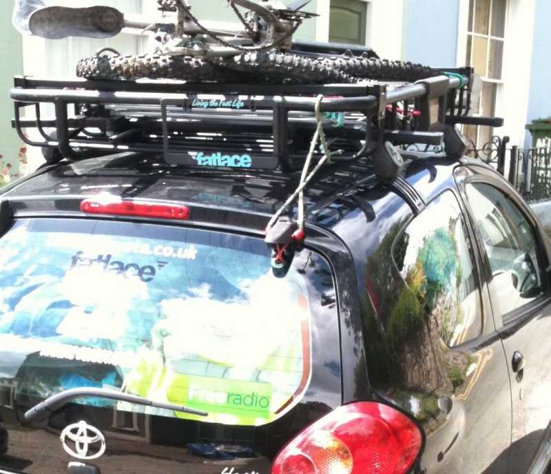

So recently I moved out and my boot hinge decided to break. The hinge is plastic with a metal nut encased in the plastic for the bolt to screw into. I haven't ever forced my boot closed and I am usually very careful
when closing it, due to the boot being all glass. So I held the boot on with some good old bungee cord just to get home.

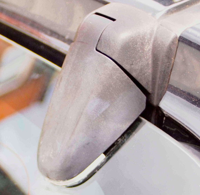

I managed to push the nut back into the housing and filled the gaps with epoxy resin, placed the broken bit of plastic back in and covered it with more resin. I left it for a day to set then the next day screwed the nut back in hand tight, but this first fix failed. I noticed the hinge was levering itself away from the glass when it opens breaking the resin. I decided to follow what I had done the first time, but used epoxy putty to sandwich the nut in the hinge, then added a big washer between the putty and rubber seal, to give it more surface area so it would not lever itself off. screwed the nut back in and left it for a day to set. Many people have had problems with the boot leaking and not being able to find the fault, I think it must just be a design fault and my boot doesn't leak any more. Now I just need to give my Aygo a good clean. cool.png

Haha that stuff is flexible it wouldn't work, the Unibond epoxy putty works fine. It's like white tac then when it sets it's rock solid and can be sanded and painted.
