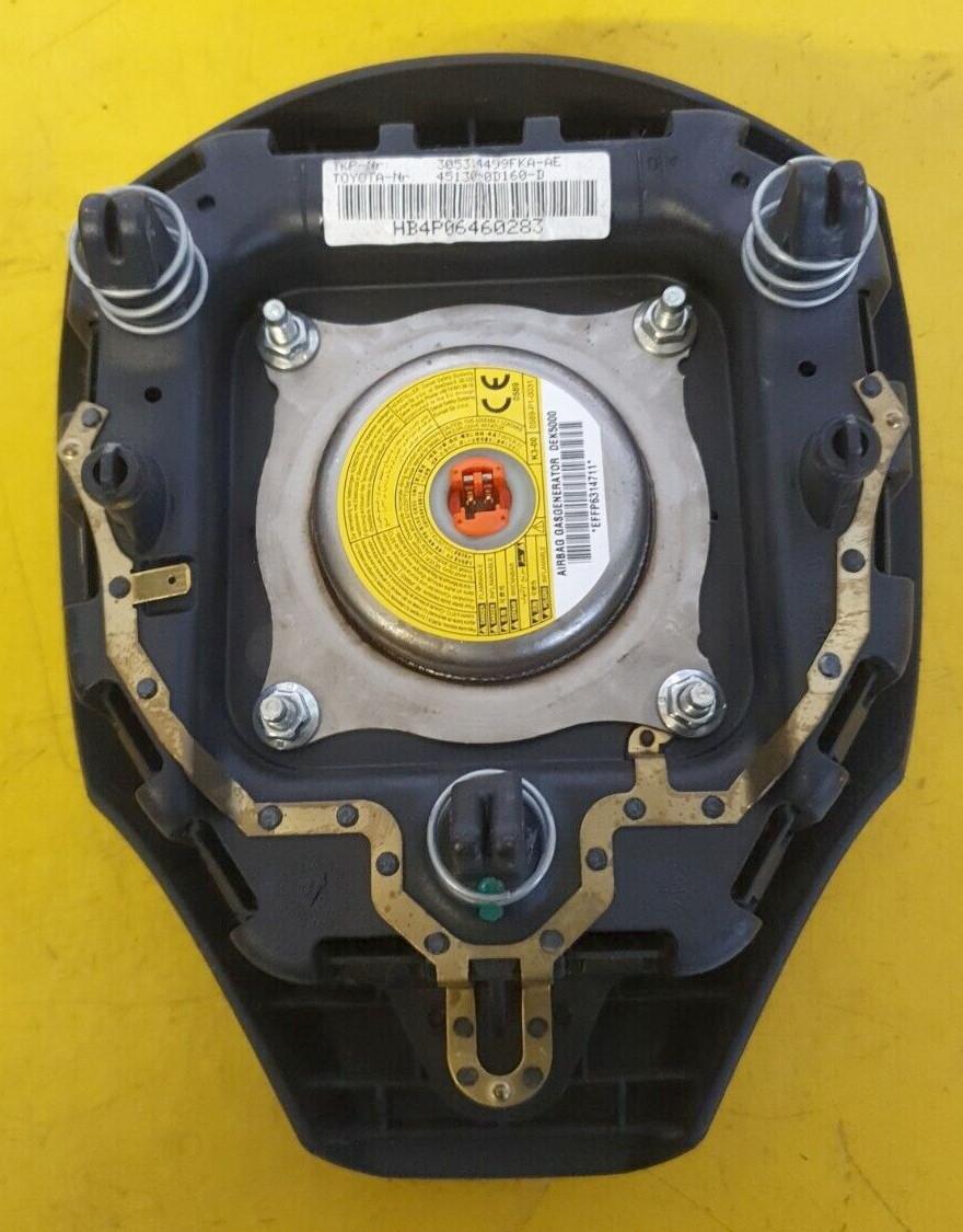

This is the same question I have. I'm needing to replace the stalks and the two torx points aren't there as shown in the manual purchased and in most videos on youtube etc. I have the same model as the original post author. The video being in another language and starting after the 'leverage' attempt has been made isn't directly informative, but I will try again looking for release points as per the authors reply to himself. If you are still here -- 2016 to 2022 -- I'd be grateful for a pointer or two. Thanks.
Now I know what I'm looking for -- 5 minutes and I found this having dismissed it without watching a dozen times in youtube searches -- hope this helps someone else too. Thanks.
This picture (courtesy of eBay), allegedly shows the rear of a 2006 Yaris airbag. Perhaps this helps show where your three clips are located.
