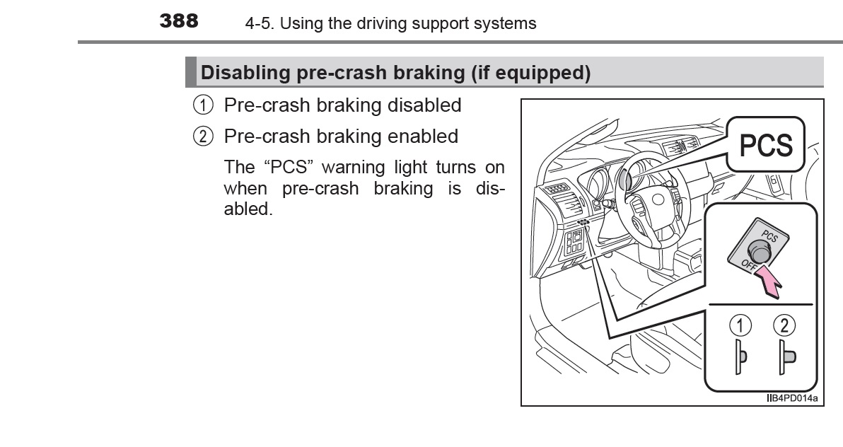

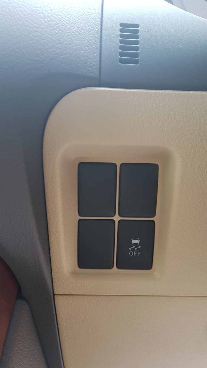

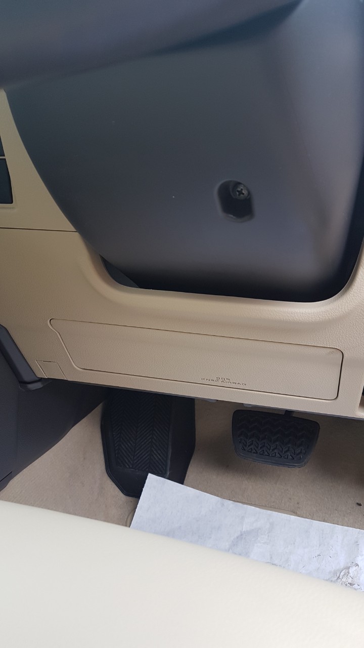

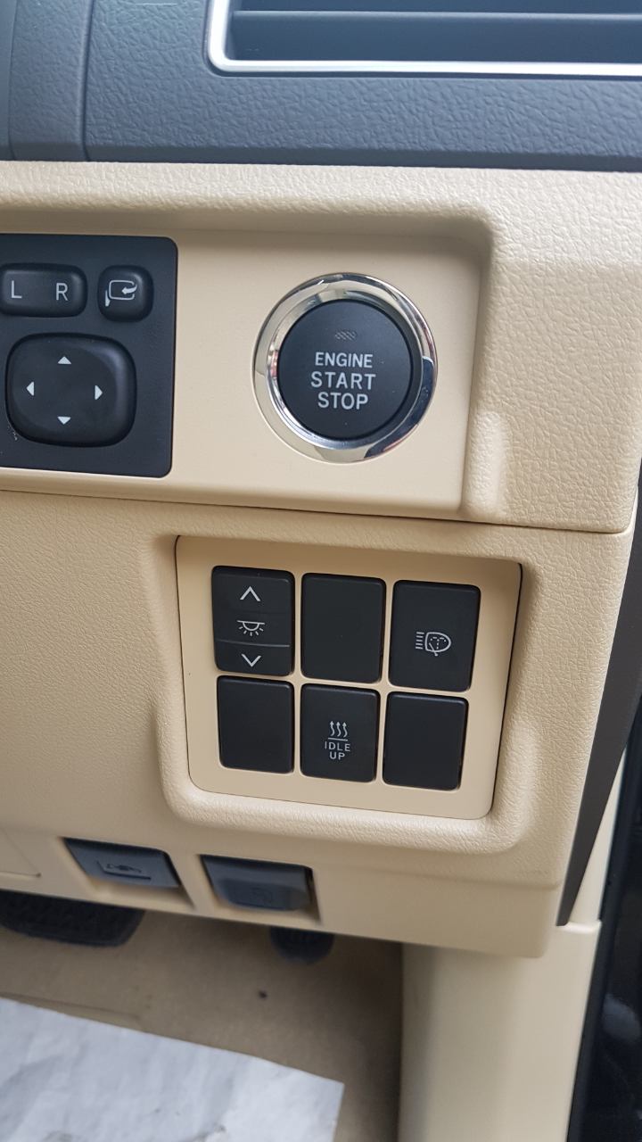

Thanks. The online manual states that there should be a button that turns it on and off, but it is not where it says it should be (please see picture). I am going crazy here...
OK. I found it.
From another Forum:
Sale guy struggled to show me, but eventually we found it. It's under the steering column, at the base where it is under the dash. Small indented button, sort of like the tire pressure button, which is closer to the driver, but that tire pressure button is to the left, not as far away from the driver as the PCS button is. We had to get a flashlight and get on our knees. Good luck…best I can describe. It was a demo, so can't provide photo.
 I quit using my yes and just began using my hands, feeling around blindly for it. I found it just as you described it; completely hidden up under the base of the steering column and 3"=4" to the left of center toward the driver's door. I'm not sure how you would ever see it- but I was able to test it by pushing the button and seeing the "PCS" sign light up on the dash indicating the system was disengaged. I re-engaged it and went to bed satisfied. LOL!
