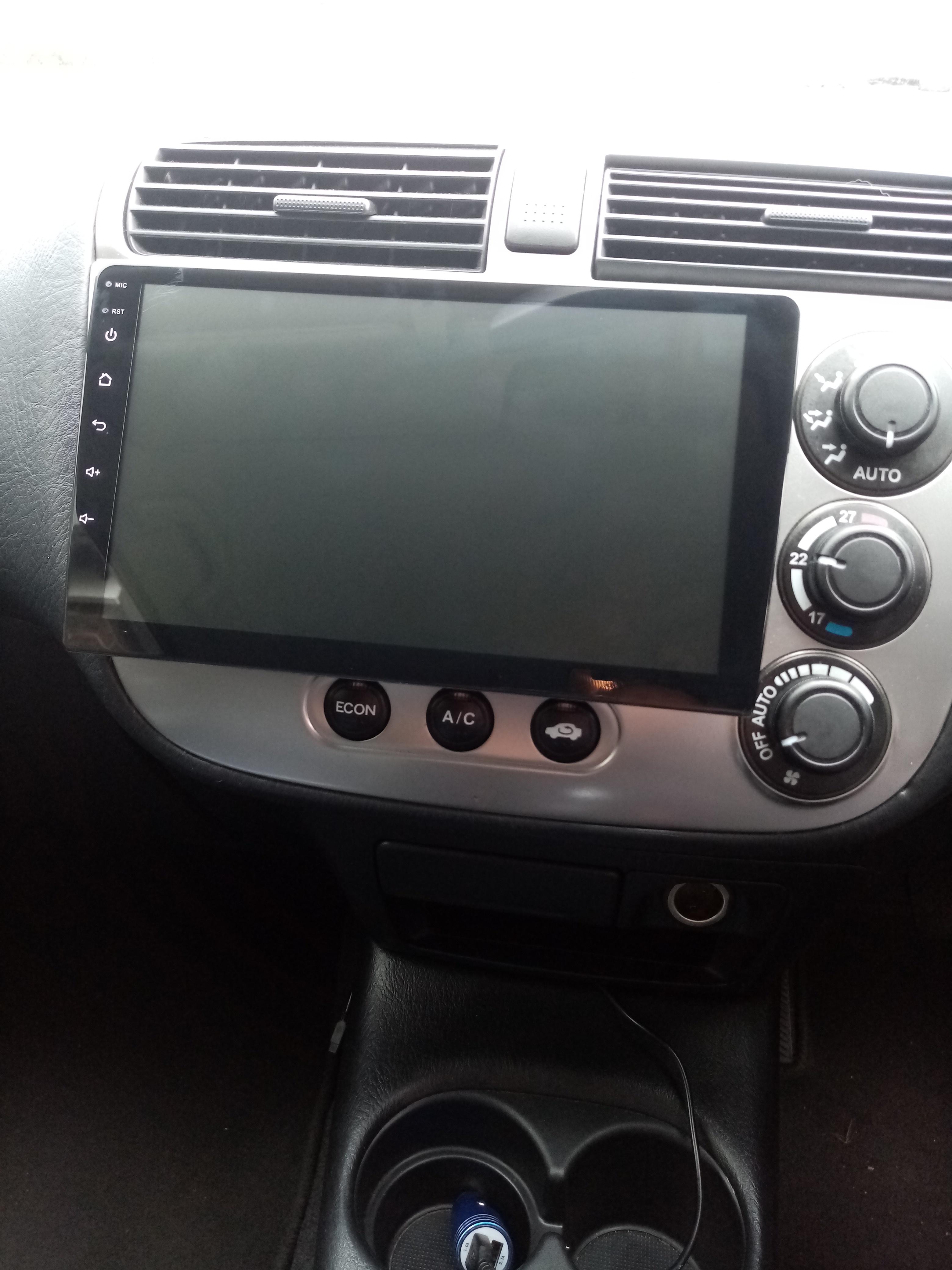

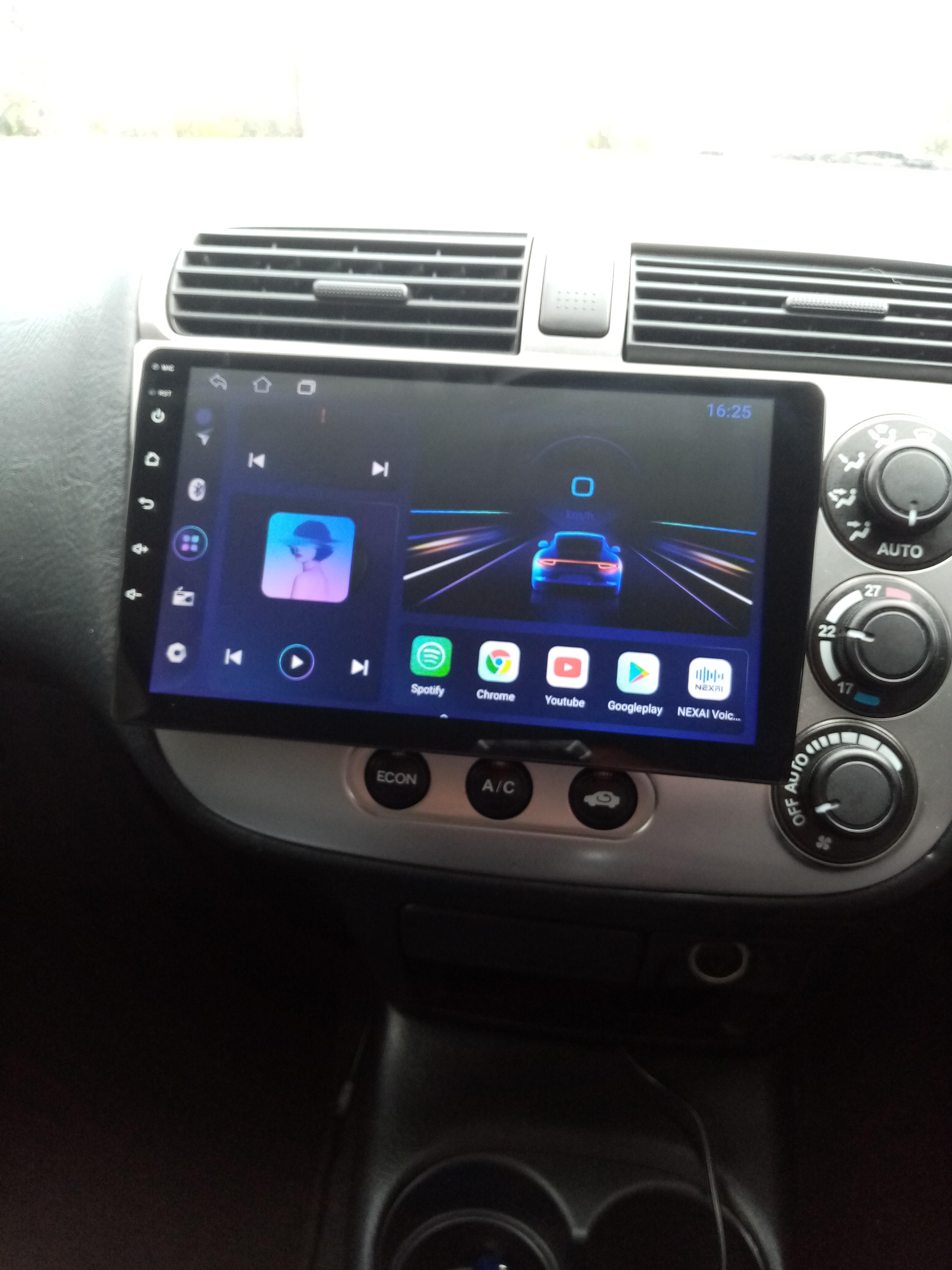

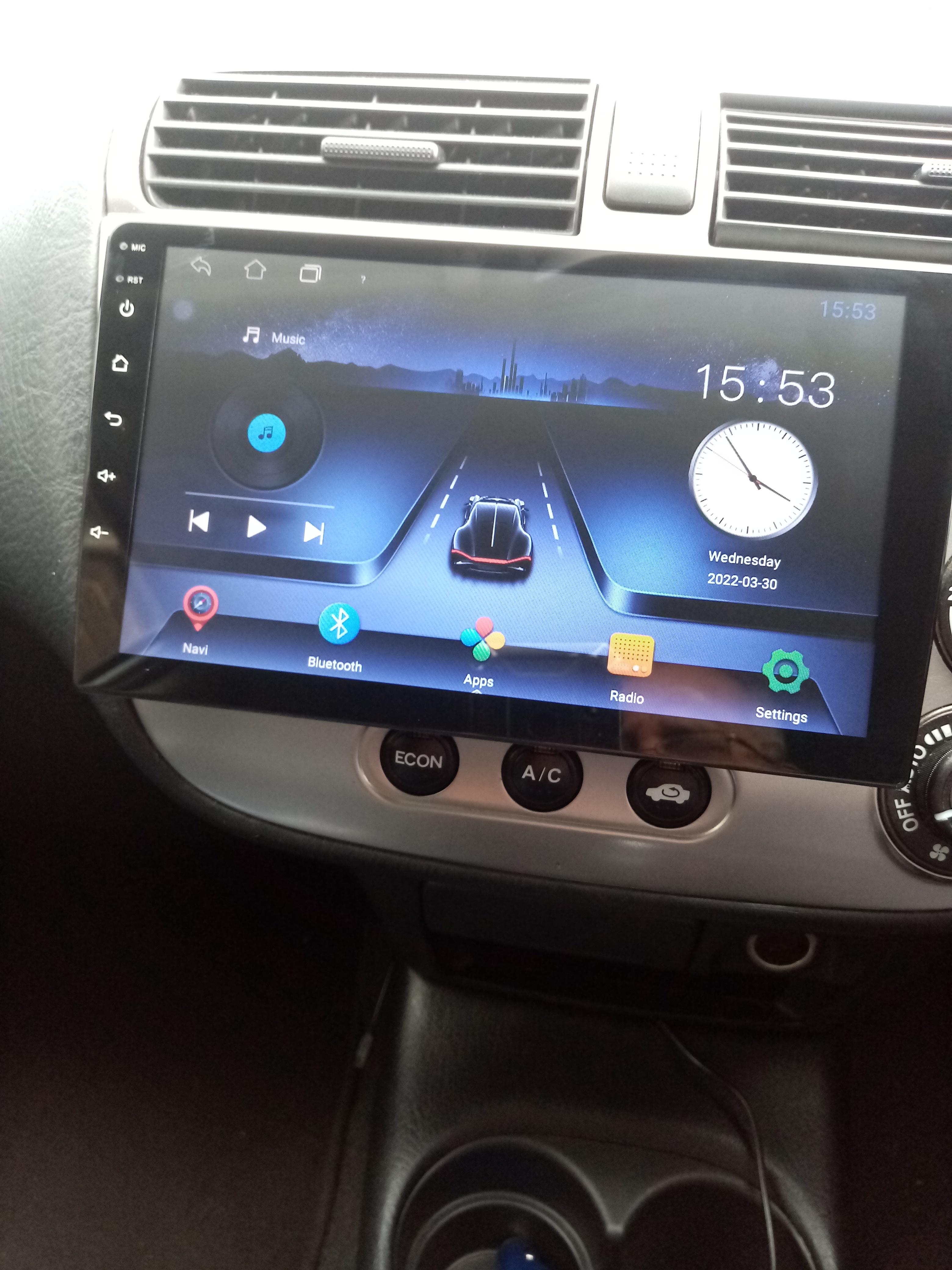

I know it's very expensive I bought android 10 from China for my Honda civic hybrid 2004 and its beautiful map updates are free as well. IMG_20220330_152512.thumb.jpg.8f2bc3f998dd66b4a64593aa896aeac6.jpgIMG_20220330_152512.thumb.jpg.8f2bc3f998dd66b4a64593aa896aeac6.jpgIMG_20220330_152512.thumb.jpg.8f2bc3f998dd66b4a64593aa896aeac6.jpg
Why I use Google maps via CarPlay 😀
