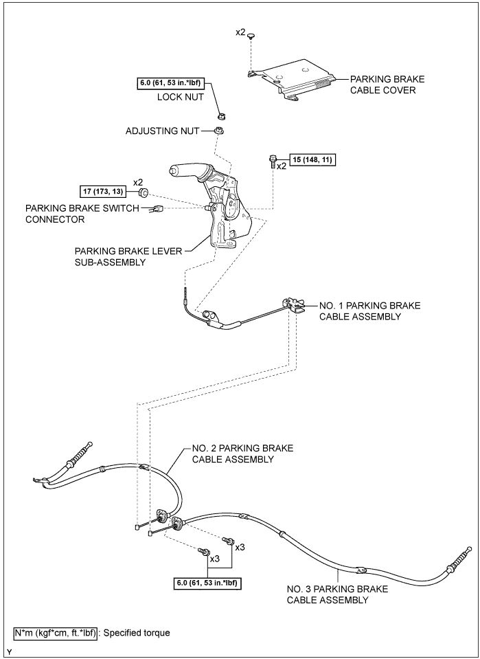

logically i thought i'd adjust the handbrake cable on that side at the compensator if its a 2 cable handbrake. lifted the centre console around the handbrake leaver and found the 1 adjusting screw........... So having got under the car to find the compensator, all i could see is there left and right cables exit the body of the car and go to each rear wheel assembly.
having looked in all of the obvious places i can only assume that the handbrake compensator (where all 3 cable join up) is located behind the handbrake, under a cover and under the interior mat.
Does anybody have an experience of this or am i just deluding myself.

According to the manual the brake joiner / spliter thing is under a plastic cover under the carpet behind the lever. It says to remove pretty much all the trim from the back of the car to get to it!
Not sure finding it will help though as it has no adjusters on it, the cables have ball ends on them and that is it. Seems all the adjustment is made at the caliper ends.

Now that is the sort of assistance I was hoping for! Thanks for this. No need to do anything now.
i took the calliper off last night and wound the piston back in. Then adjusted the Caliper out to get a better closer fit. Test drive it and measured the temperature of both rear discs to see if there was excessive heat from dragging. All was ok.
