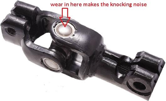

 the Auris and maybe the Lexus Ct 11 plate onwards where this rattle is prominent
the fix is a new Universal Joint on the steering column once these start to wear you
can then hear the rattle and it will only get worse with time.
if you hold the joint and turn the steering wheel you wil be able to feel any movement (wear)
below is an image showing what a universal joint looks like
