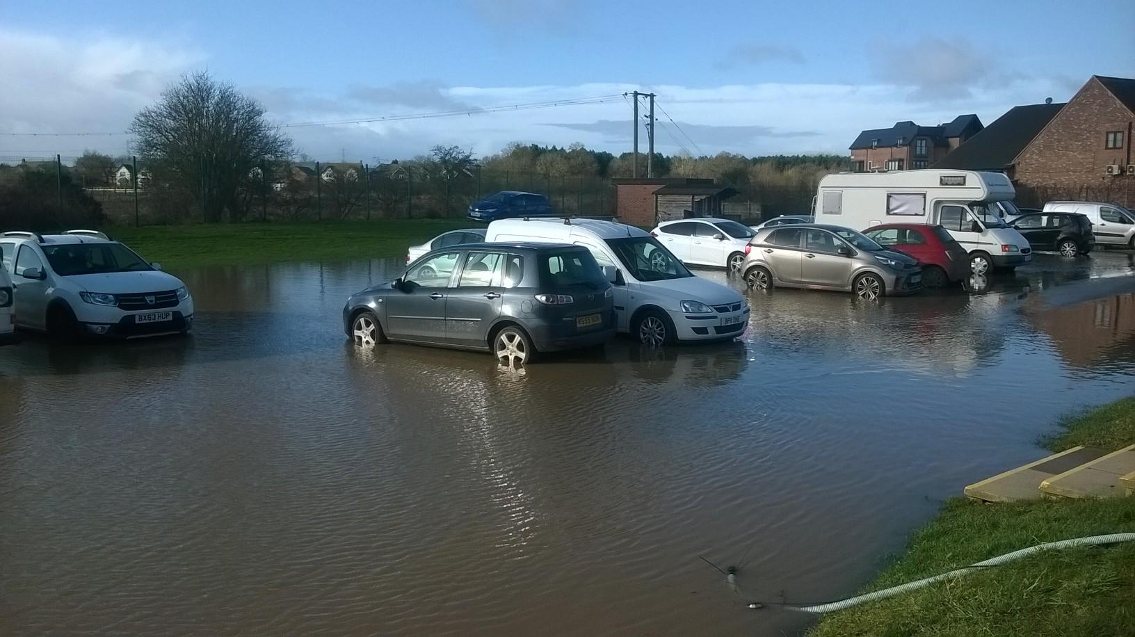

can you turn it off? Useful in winter to get going in snow. Today our car park is flooded so wanted to get up a slope onto the grass bank like I managed to yesterday, but couldn't get far today as  wheel spinning and power cut. Annoyingly my rwd Volvo with winter tyres sailed up! My Auris is the blue car on the far bank!

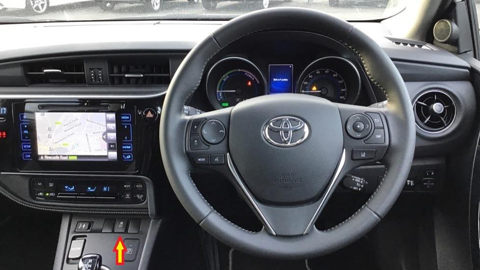

There should be a TRC/VSC switch just in front of the gearlever where the heated seat switches live. Picture of a car, with a squiggle under it and the word OFF.
Quick press should disable the traction control. A long press disables the stability control as well.

Sadly, this was not fitted to the  ->2015 model cars.
TC is part of the ESC/TRC/VSC+, you should have the ESC/TRC/VSC off button (pic of a skidding car and the word OFF)
edit. its shown in every manual 2014-18 as a standard feature
Mk2 Auris hybrid. Its not unheard of the production line running out of parts and not fitting the part and taping the loom up, Have a look and see if the loom is there if so add the switch
Thanks. Want to pop in to the dealer and upgrade the headlamp bulbs to optibright as not great at night. Need to take one out and see if not done by previous owner. I'll as about if the wiring is there.
