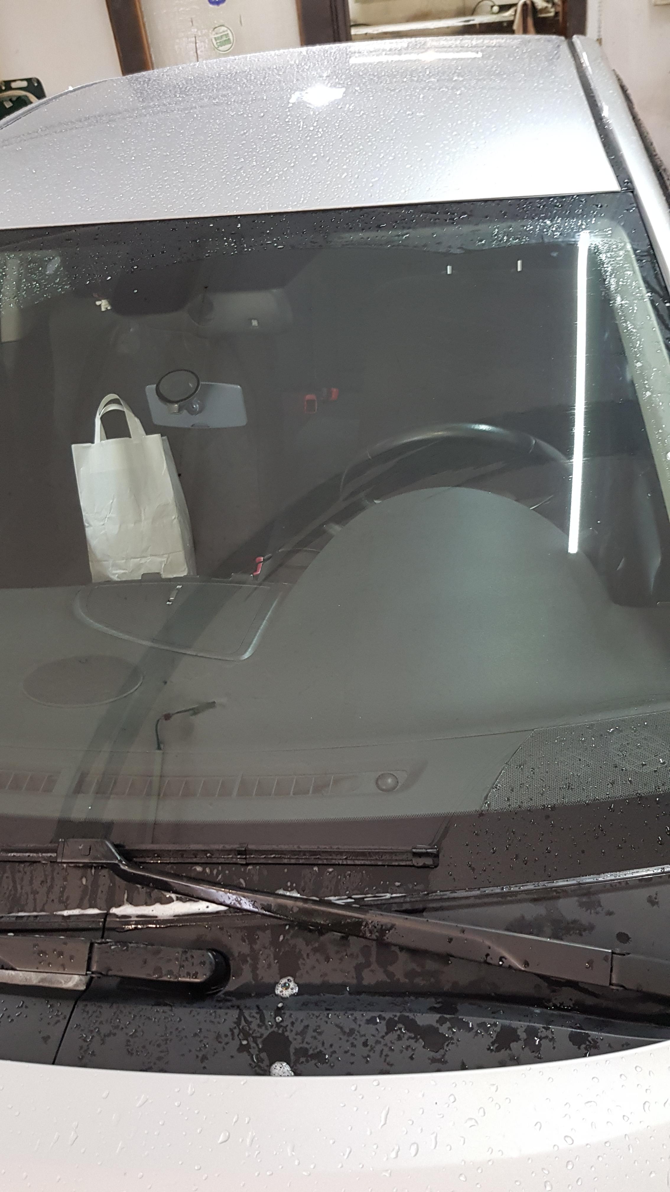

Does anyone have the same issue?
After changing several Wiper Blades (Valeo, Bosch etc.) it makes stripes on the windshield in the area right in front of me...I tried to crook, bend the wiper arm, but nothing changed. It is right at the connection where the arm and the blade connects.20200618_111905.thumb.jpg.81c1f7c788f1a6c9bbb051406018471c.jpg
Please see on the picture attached
Do you use a car wash ? looks like the arm is tweaked, the spring has started to go weak or the wiper linkage may even be worn (check for play)
I use car wash.
I have checked for play, but it doesn't seem to be any.
Is there like a trick bending the arm or something else or just change the arm first...
i would change the arm, if the linkage feels ok (lift the arm up straight a give it a wobble)
It wobbles, but just a little bit, which I think is normal.
I will try with another arm, but any further suggestions are highly appreciated
