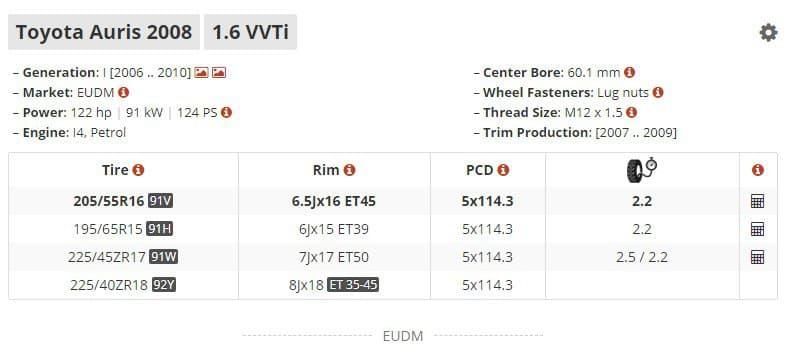

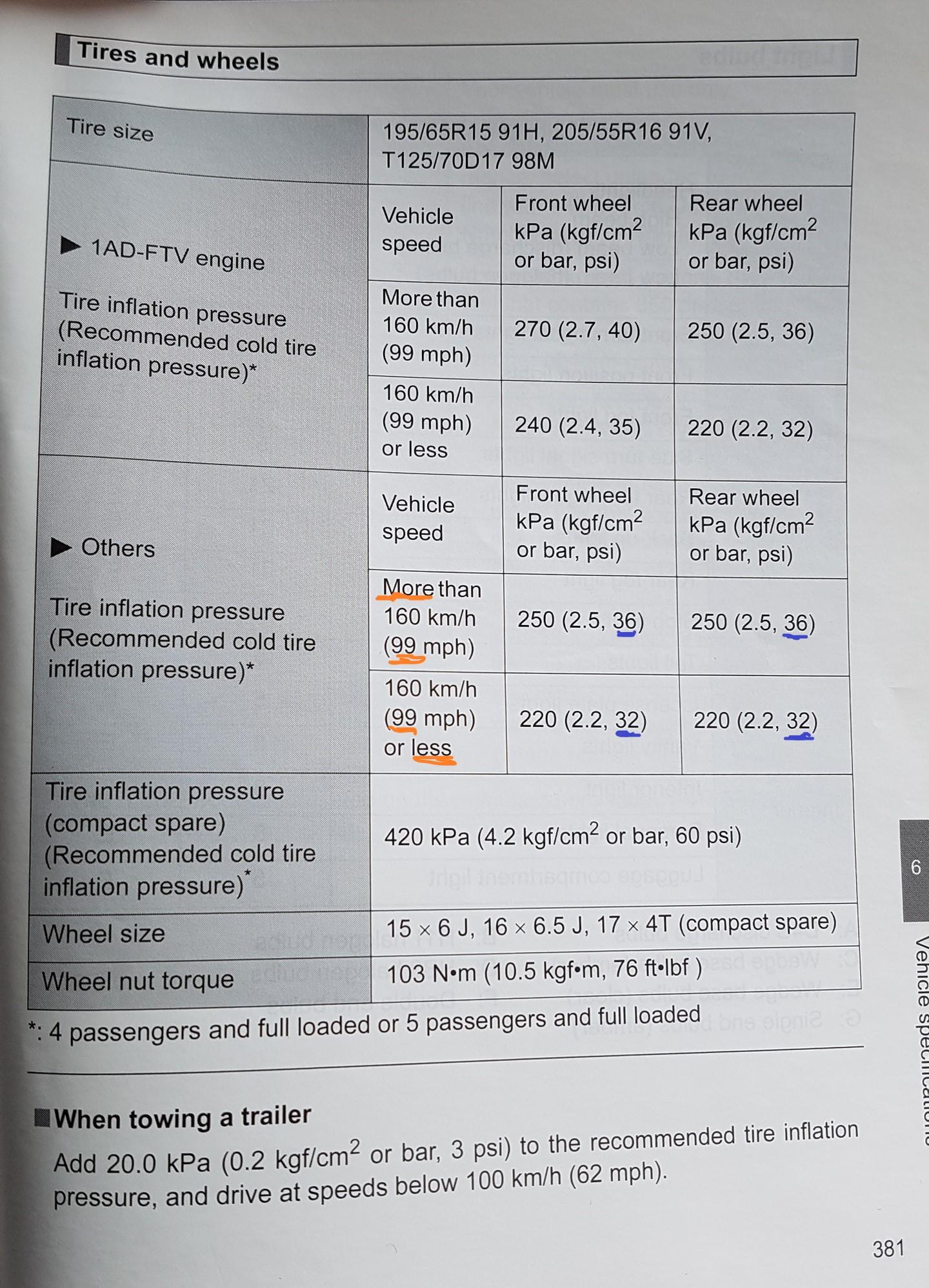

Merlin5 13 Posted July 14, 2020 Share Posted July 14, 2020 Hello chaps. 🙂 I pumped the tyres up yesterday to 32 front and 32 rear. My tyres are 205/55 R16 V 91. According to the manual that's the right pressure. But I've seen some places say unladen should be 35 front and 32 rear and another saying 33/33. Shall I stick with 32/32? There's also nothing I can see about what pressure when carrying heavier loads. Would you say 38 all round for laden?  Quote Link to post Share on other sites

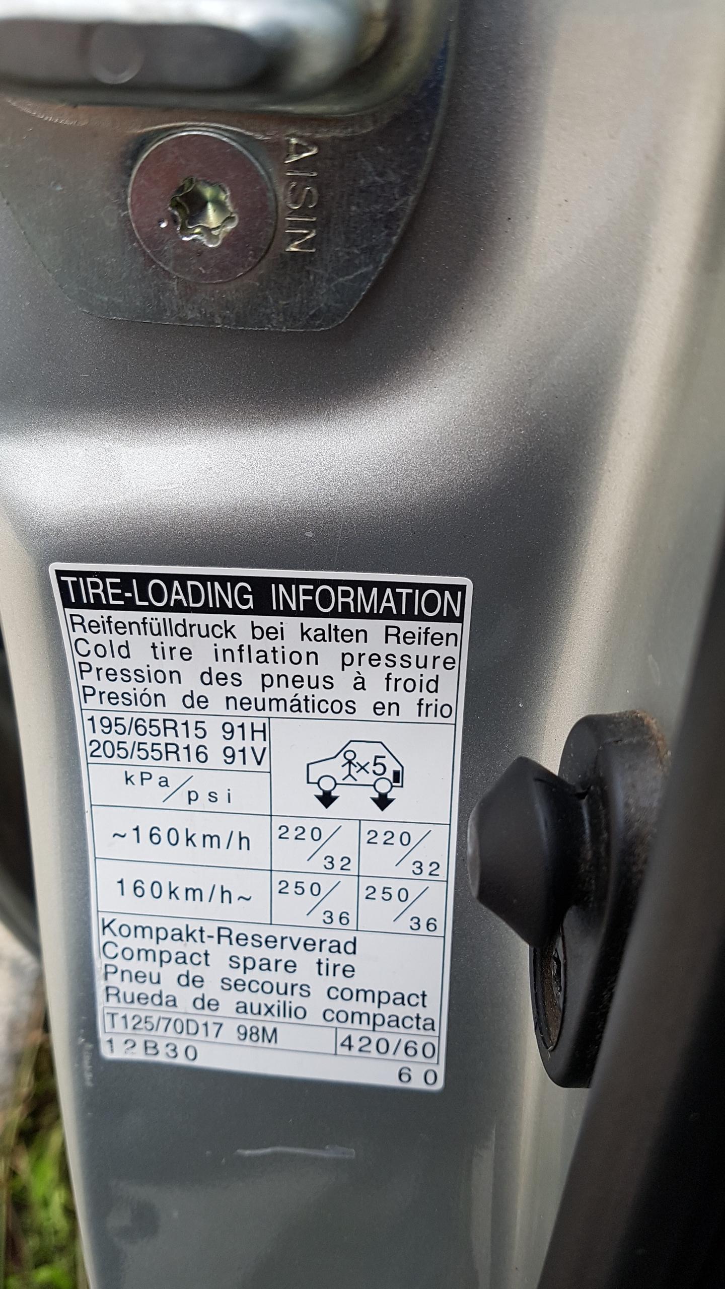

FROSTYBALLS 3,516 Posted July 14, 2020 Share Posted July 14, 2020 There should be a sticker/plate inside the driver's door opening on the B pillar whuch gives the tyre pressures including when loaded and at speed. 1 Quote Link to post Share on other sites
Merlin5 13 Posted July 14, 2020 Author Share Posted July 14, 2020 1 hour ago, FROSTYBALLS said: There should be a sticker/plate inside the driver's door opening on the B pillar whuch gives the tyre pressures including when loaded and at speed. Thanks, I looked at the other pillars and missed that one! Yes, matches the manual, 32/32 under 99mph and 36/36 over 99mph. Those pressures must be for unladen and laden because the little drawing shows the driver plus 5 passengers. And the only thing that changes it from 32 to 36 is speed.  Quote Link to post Share on other sites

eygo 242 Posted July 15, 2020 Share Posted July 15, 2020 i would measure your tread depth across the tyre width to get a iew on how the tyre is wearing @ 32psi if you find the centre has deeper tread then yes increase the tyre pressure if its equal then leave it at toyota's pressures on our 16 plate we run 35 / 35 1 Quote Link to post Share on other sites
