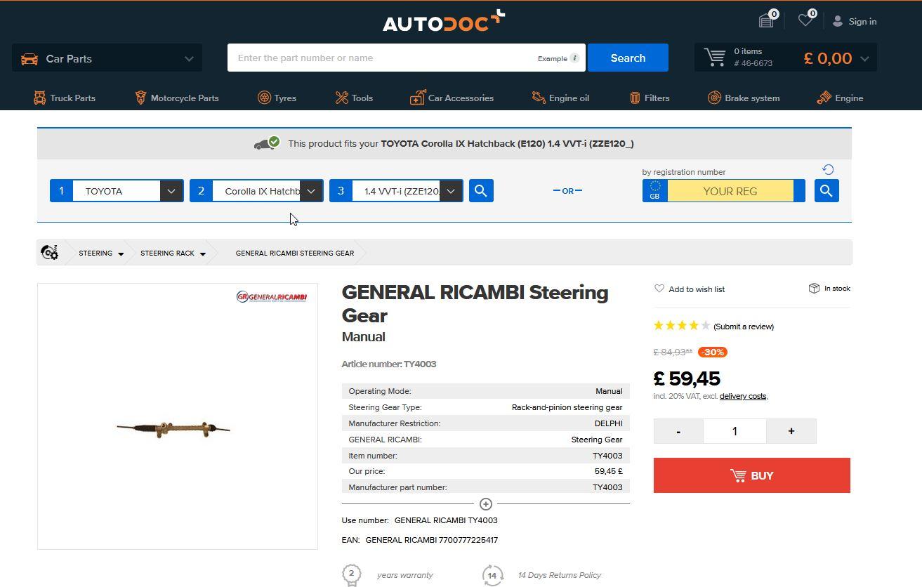

Theres a vast price difference in steering racks,  this place ,  EU supplier,  has them ranging from £60 to £1260 !
Might be better to fit a complete new one than trying a repair ..?
