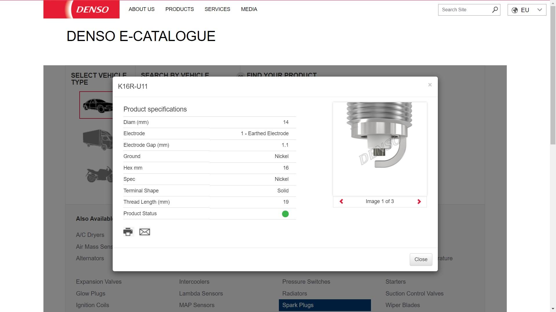

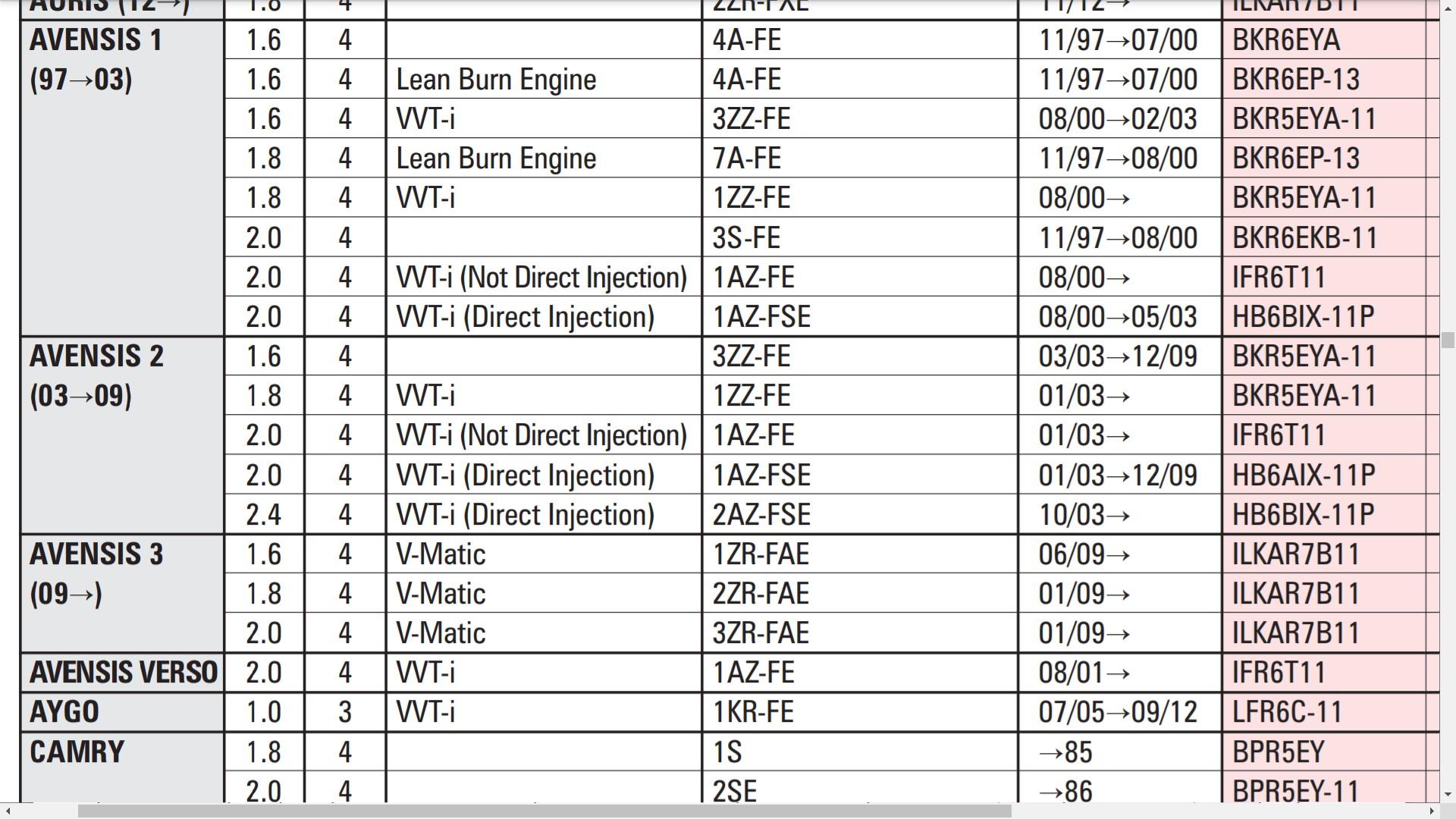

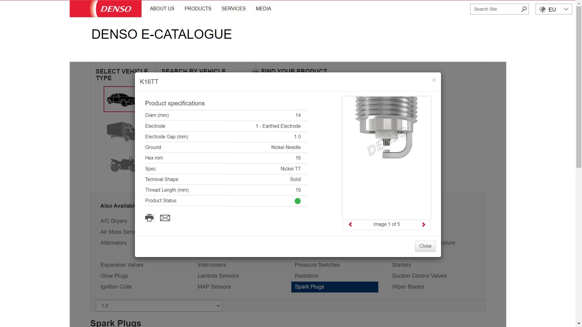

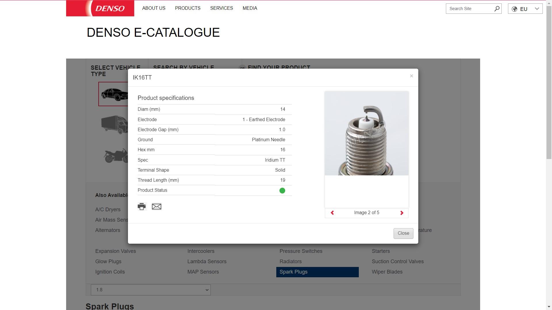

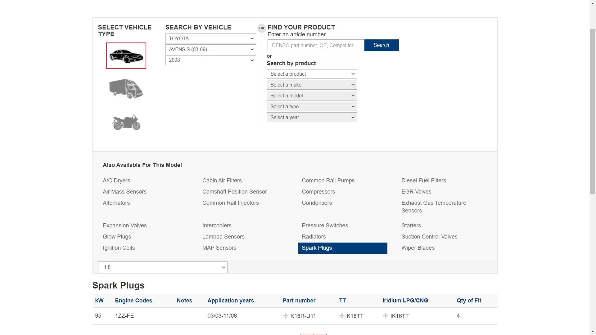

Konrad C 956 Posted November 16, 2020 Share Posted November 16, 2020 I checked the Denso catalogue and also the Haynes manual which is fairly accurate, and the Denso K16R-U11 is the recommended spark plug. This spark plug is not Iridium, and is the only 1.8 Avensis engine (1ZZ-FE) that didn't have Iridium as standard! Here is the specs from the Denso catalogue - Denso K16R-U11 https://www.denso-am.eu/e-catalogue/ The other options are K16TT and the Iridium option IK16TT. I looked up the NGK catalogue and only the BKR5EYA-11 was listed - So long as the spark plugs meet the specs, then any brand should be fine, though I prefer to use the recommended brand. Sometimes Toyota and Denso change the spark plugs, like my car used to have Denso SC20HR11, then they changed to SC16HR11 and discontinued the original SC20HR11. Quote Link to post Share on other sites
mrfixer 118 Posted November 17, 2020 Share Posted November 17, 2020 K16R-U11 is the factory-fit plug for this engine. Its a standard plug. Iridium is an upgrade.. Denso IK16 is the Iridium version. I have these in my Avensis. 1 Quote Link to post Share on other sites
