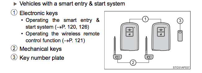

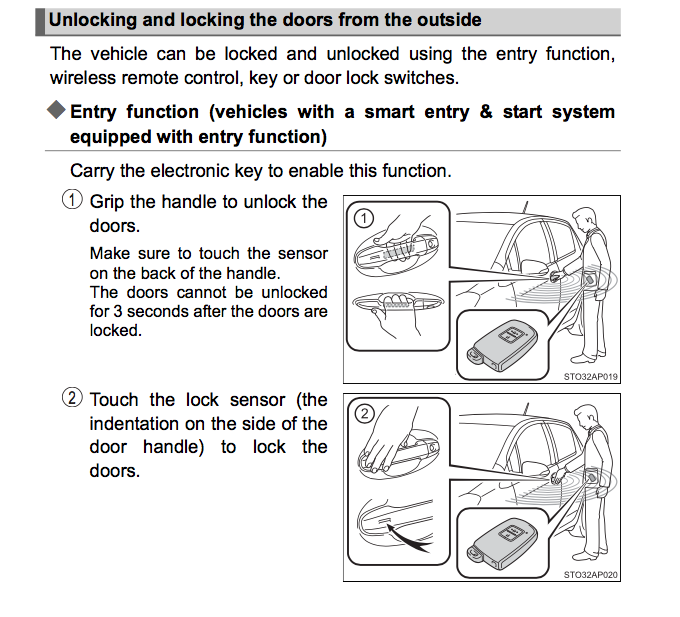

According to our handbook PDF, we have keyless entry, but we don't.
Tried your idea, and it doesn't work.

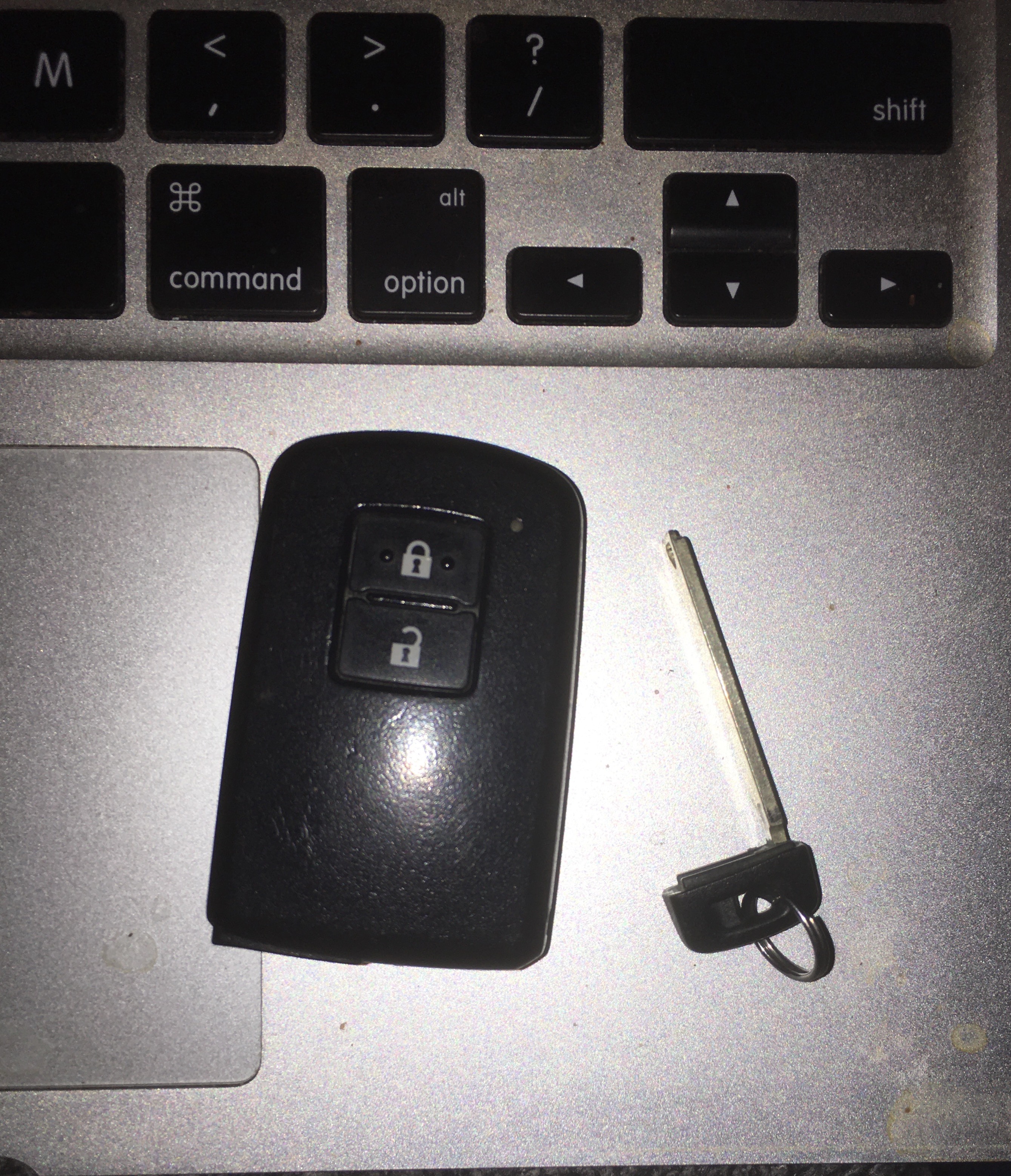

This is our key and we have two of them, and neither works for Smart Entry.

It was an optional extra and only on some top of the range cars, but it also depends on when the car was built (2014 was facelift change over year)
IIrc on my 2016 excel it was part of the premium pack

That key you have is the same as I had for my auris and is very similar to my corolla key. Smart entry was only available on the excel range of cars I believe. I gather from your question is that  maybe you thought that this function enables the smart entry function, what it does is that if you have smart entry it disables the the signal from the key and also puts the key into sleep mode.
possibly the feature of disabling the signal from the key on your vehicle was not available until 2015 which was the year when I bought the auris.
just because the handbook says that you have smart entry doesn’t necessarily mean that you have it as the hand books are not specific to each model range of that particular vehicle usually if you read to the bottom of the page it says usually says if equipped.
2 hours ago, Mick F said:
Ours is a Sept 2014 new registration and a top of the range Excel, so the changeover must have been very late 2014 or even 2015.
Mick.
That will be the first of the facelifts in 2014 as they did not use the Excel spec before then with the Yaris
It was still an optional extra even on the Excel in 2014 it was called the "smart pack" £395 extra
