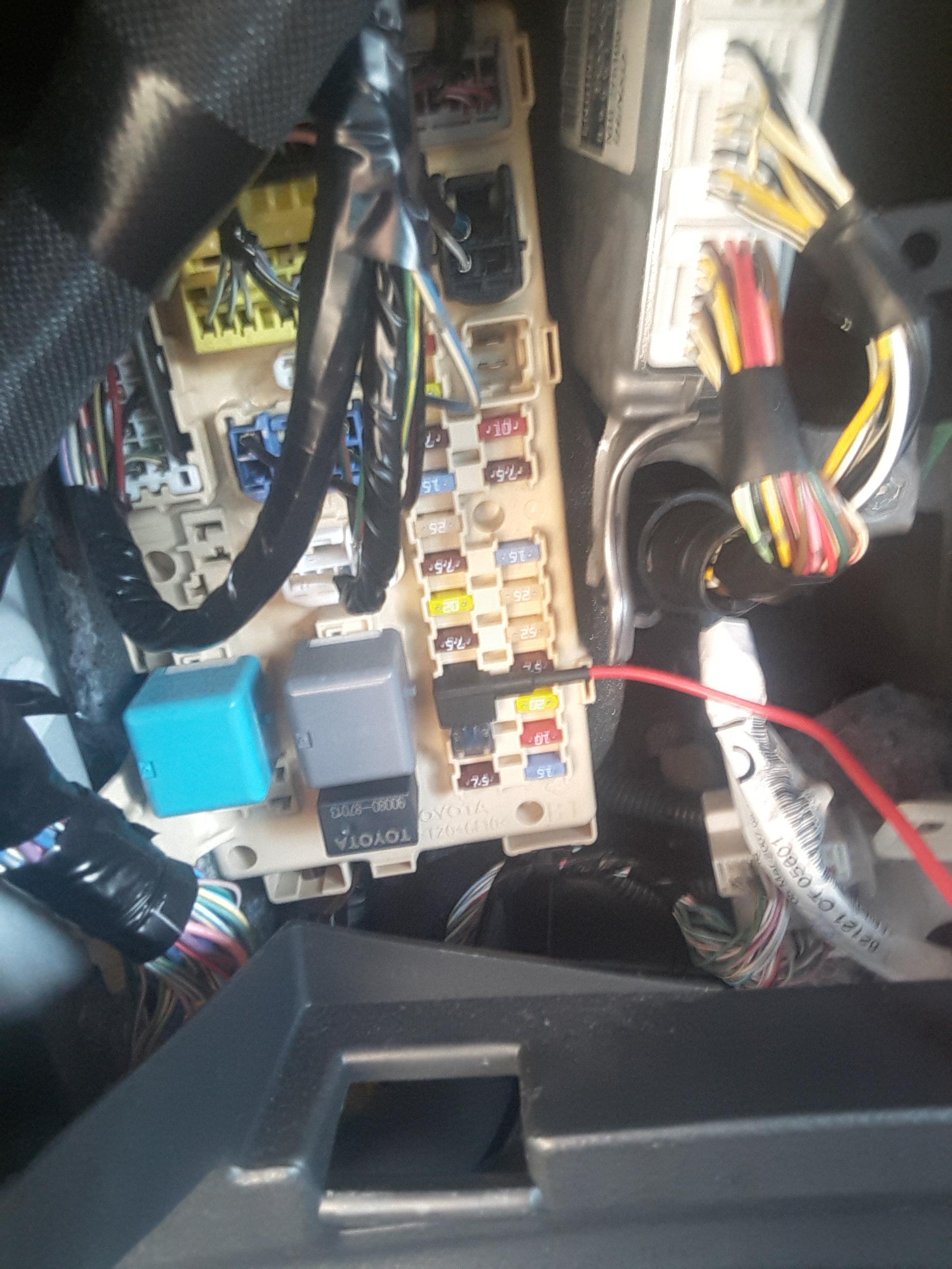

JohnnyR1 0 Posted January 2 Share Posted January 2  Hi, This is my first post here. Here is my story 🙂 Bought 322 few days ago. I was trying to connect through cigarette socket but no luck (no blue led o charger). I have checked in my friend's car - it worked well. So, next step, today I bought Nextbase hardwire kit. Found fuse box in my Toyota Avensis 2007. Removed power electric window 20 fuse. Vehicle's ignition on, windows works but camera is dead. No led indication on regulator. I have checked every fuse in the box but camera is dead, not charging. Cigarette socket does not work aswell. Any ideas? Thanks, Johnny. Quote Link to post Share on other sites

JohnnyR1 0 Posted January 9 Author Share Posted January 9 Hi Konrad, Thanks for reply. I found second fuse box (on the passenger side) and I have tried couple times but it does not work. Looks like hardwire does work but it does not charge my camera. Anyway, I exchanged bad cigarette socket fuse and now got power from there. I will keep looking and will post some updates later.    Quote Link to post Share on other sites
