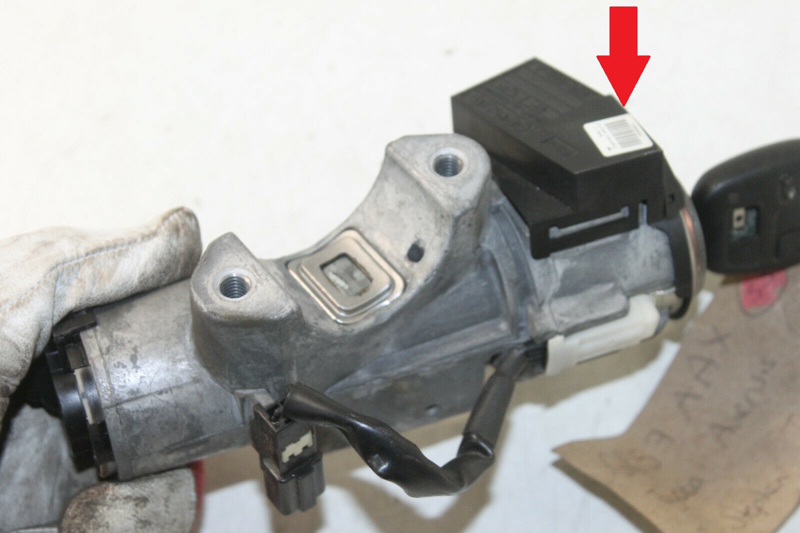

Gerg 371 Posted January 8 Share Posted January 8 21 hours ago, Lynnec said: No although a couple of weeks before this the engine kept cutting out and the diagnostic said it was an immobiliser fault. I changed keys and it ran fine until the battery went flat when I left the ignition on I have no great insight into a problem like this (unlike Kingo, above, who , as you can see, works at a Toyota dealer). But from what you've added above, I would imagine that: The immobiliser receiver/transmitter module that lives immediately next to the mechanical ignition key lock (black module pictured under the red arrow in this picture from eBay, of an Avensis lock for sale), is slowly failing to 'energise' the ignition key itself, because the internal electronic inductive element is 'going down', so the immobiliser chip code is not being generated, as the 'wireless generation' function is failing to get enough power into the key. So, I'm thinking that one key is marginally better (but still within the specification) at producing the code pattern at a reduced wireless power from the keyswitch module, this is the key you were using when the immobiliser module problem got worse, and both keys then stopped working, after your Battery went flat. The other key is the 'weaker' key, and was failing whist you were actually driving the car. But both keys, in this hypothetical scenario, are still good. I think that the module shown with the arrow, either has a poor connection, or has failed. Your leaving the ignition on is perhaps coincidence - this was going to happen anyway. Re-seating the connection to this module is fairly easy as the access is straightforward (but I don't know the Avensis - never owned one). So this is well worth trying first. And the part itself, from a breakers, looks reasonably priced (the one shown was ~ £20). The module arrowed just needs removing and fitting to your car to possibly fix the problem if it remains after its connector has been re-seated. I think that there would be no special configuring required, and you can continue to use your old keys. This could be finished in under an hour if there are no special security bolts to have to deal with (which there sometimes are around the steering column lock, but I can't see anything on the electronic module itself). But, all the above is conjecture(!), and I would be happy to hear from someone who knows better! Hopefully, you've got it sorted already.... Quote Link to post Share on other sites
