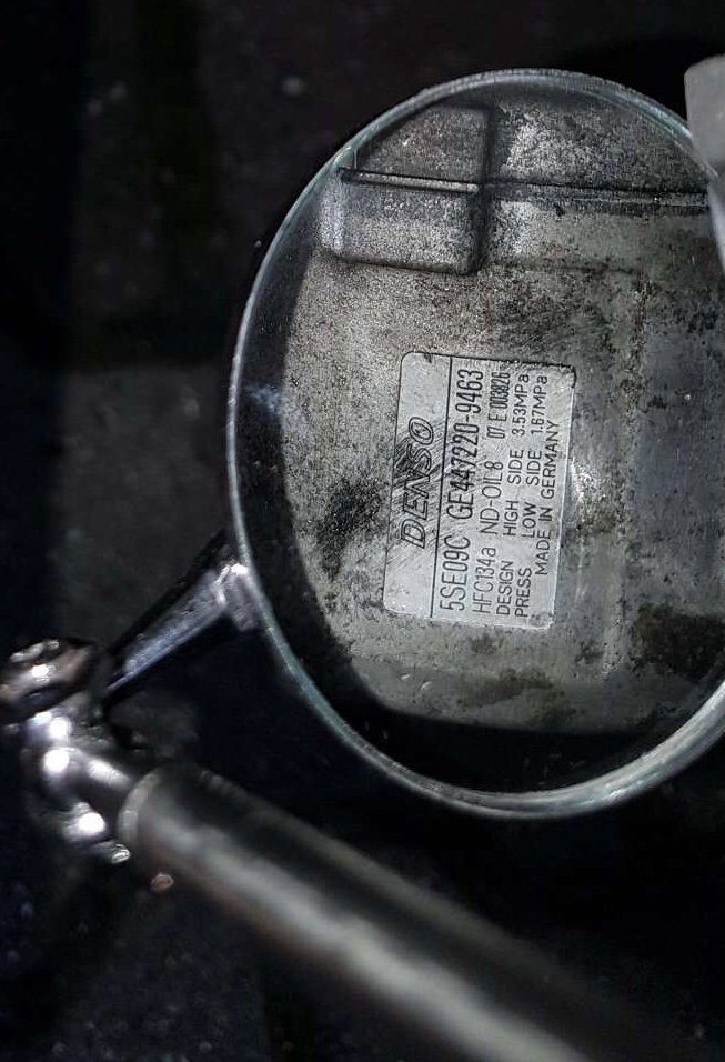

sara_x 0 Posted January 6 Share Posted January 6 Hi! I own a 2004 Yaris 1.3 petrol (64 kw / 87 hp) car, and the AC compressor has started to make a terrible sound. I was advised to replace it, but after 2 days spent searching I'm still confused about which one I should buy. I took a picture of the current one, manufacturer, compressor ID, etc on it. I found out that there are several different types of compressors for even one model. For example on mine the brand is Denso and the compressor ID is 5SE09C. On a webshop I also found one, brand is the same(Denso) but ID is SCSA06C. There are also some other types with ID 5SER09C. ? I hope that someone here can help me and tell me the difference or even the right choice. Thank you in advance! Quote Link to post Share on other sites
