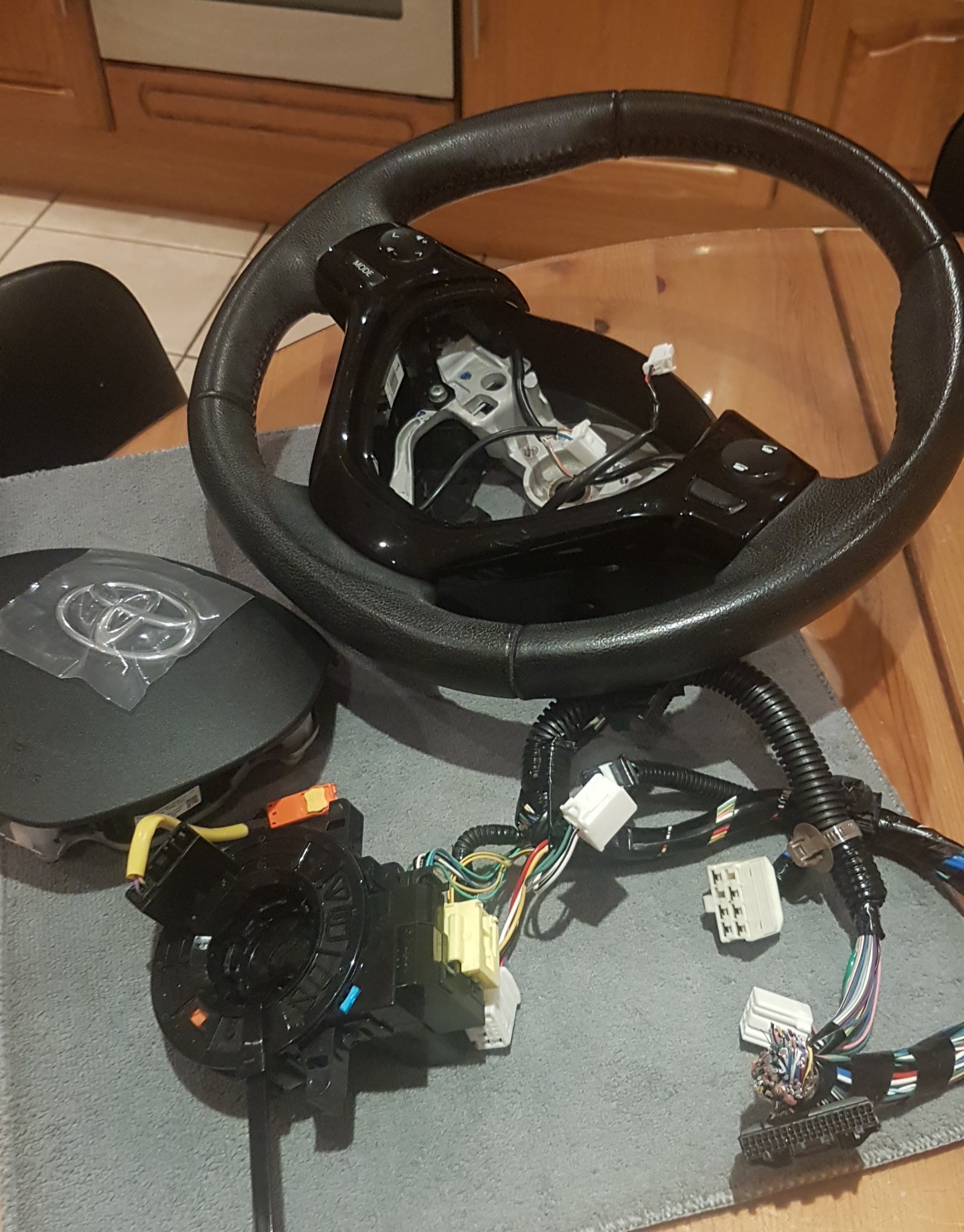

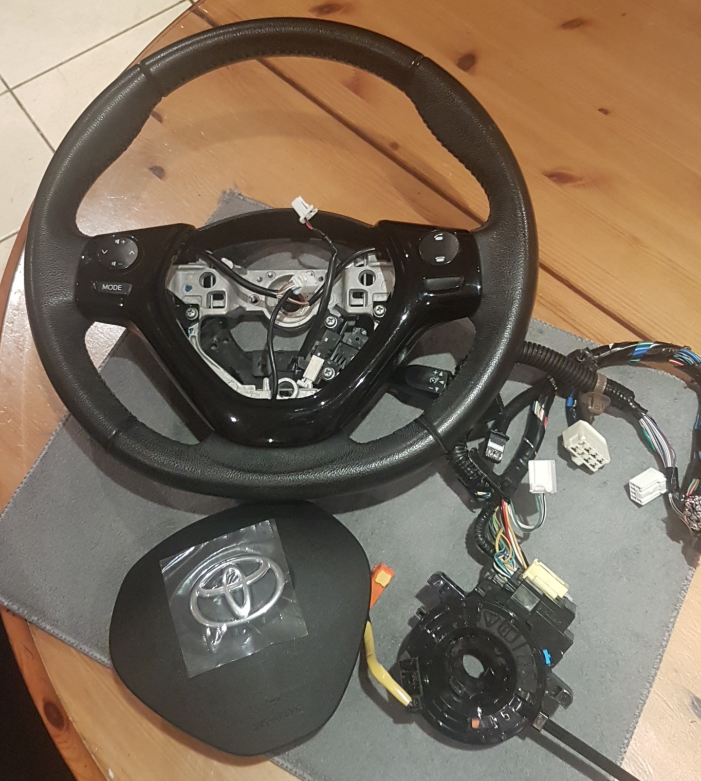

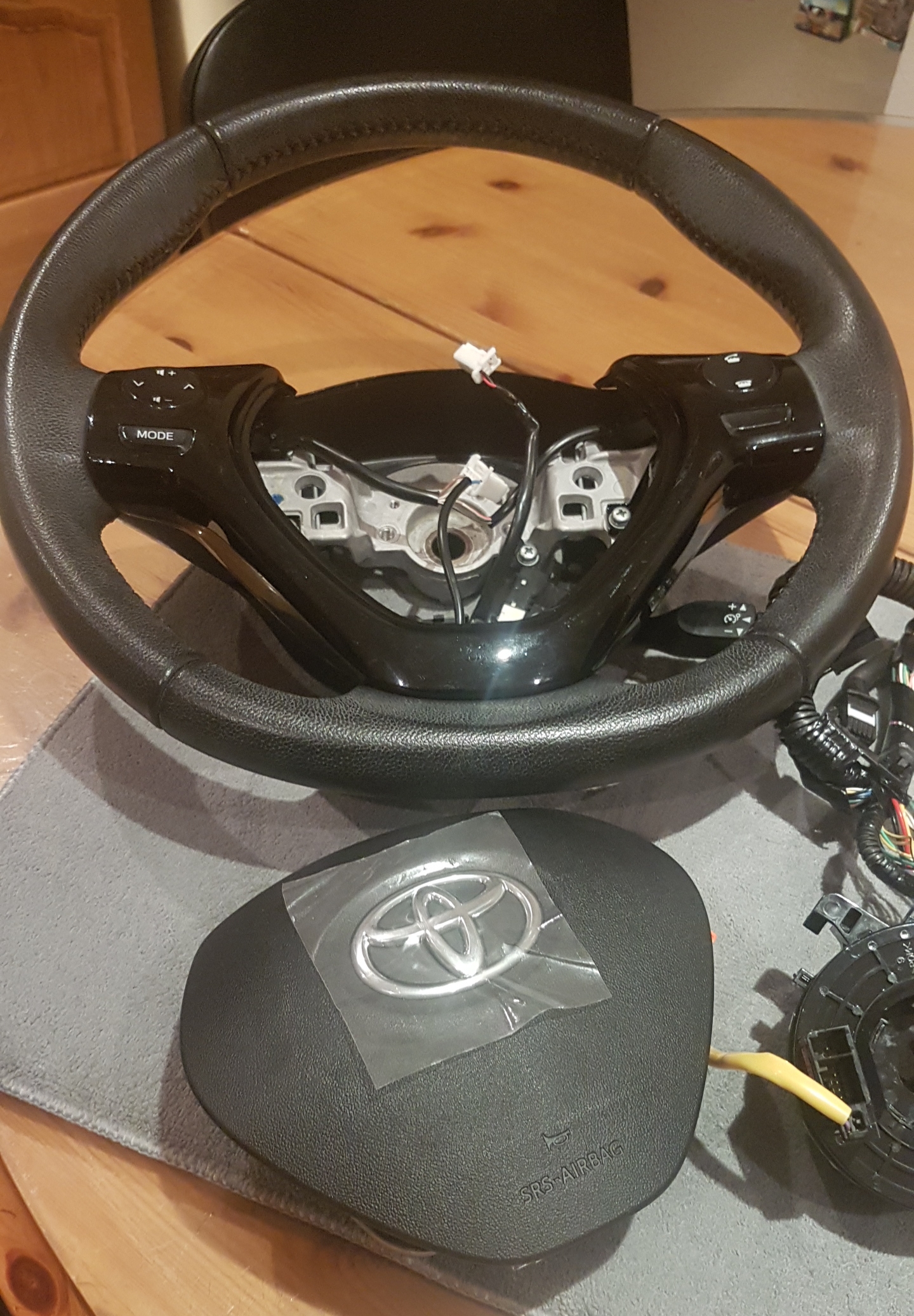

- A - Go - 7 Posted January 7 Share Posted January 7 Am looking to convert the Aygo MK2 steering wheel in to the Aygo MK1 with the multifunctional, managed and was lucky to get all in picture below for £100 and the airbag is also new 😎👍 its been done before in another Aygo and a C1 and spoke to the owner who was really kind and very helpfull in explaining the diagram.. once completed ill let ya guys know of how to if interested!! Cheers !! J Quote Link to post Share on other sites
Puglet 24 Posted January 7 Share Posted January 7 Nice, love mods like this, as you say think I saw pic of Mk1 C1 with one fitted, but no info on how it was done, so be good to see how it is done, good luck with it. 1 Quote Link to post Share on other sites

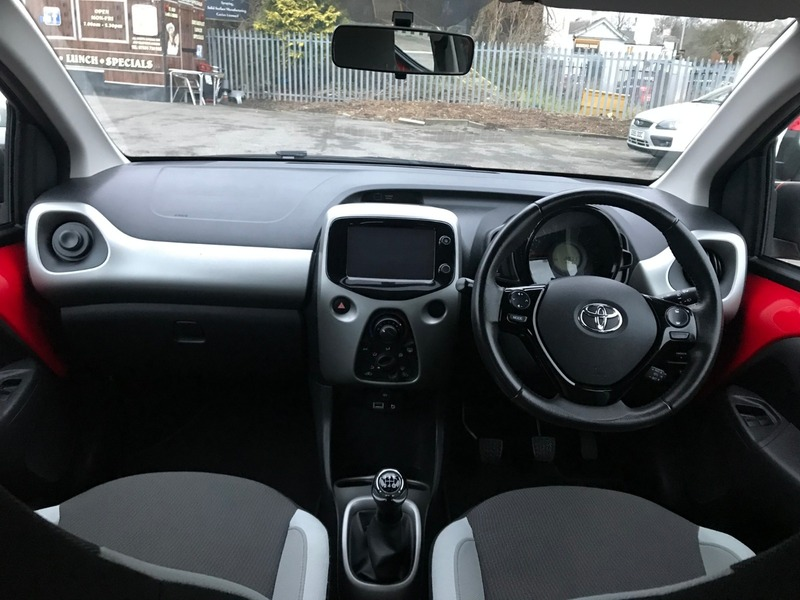

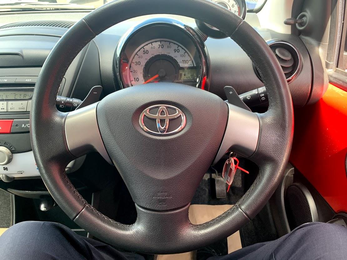

TescoExpress 1 Posted January 10 Share Posted January 10 What is actually different with the MK2 wheel compared to the MK1? The only thing I have noticed different is the lane keeping assist button? Quote Link to post Share on other sites
FROSTYBALLS 3,421 Posted January 10 Share Posted January 10 Not all generation 2 Aygos will have the lane departure alert as Toyota Safety Sense was an optional fitment originally. Quote Link to post Share on other sites
TescoExpress 1 Posted January 11 Share Posted January 11 2 hours ago, FROSTYBALLS said: Not all generation 2 Aygos will have the lane departure alert as Toyota Safety Sense was an optional fitment originally. So what is the difference then? Quote Link to post Share on other sites
FROSTYBALLS 3,421 Posted January 11 Share Posted January 11 Varies. Some models will have audio/bluetooth controls, some will be leather wrapped, some will be plastic, those models with TSS will have the lane departure button, etc. Depends on the trim level. All of the 2nd generation steering wheels will have a flattened rim at the base. First generation. Second generation - leather wrapped with audio/bluetooth controls. Quote Link to post Share on other sites
