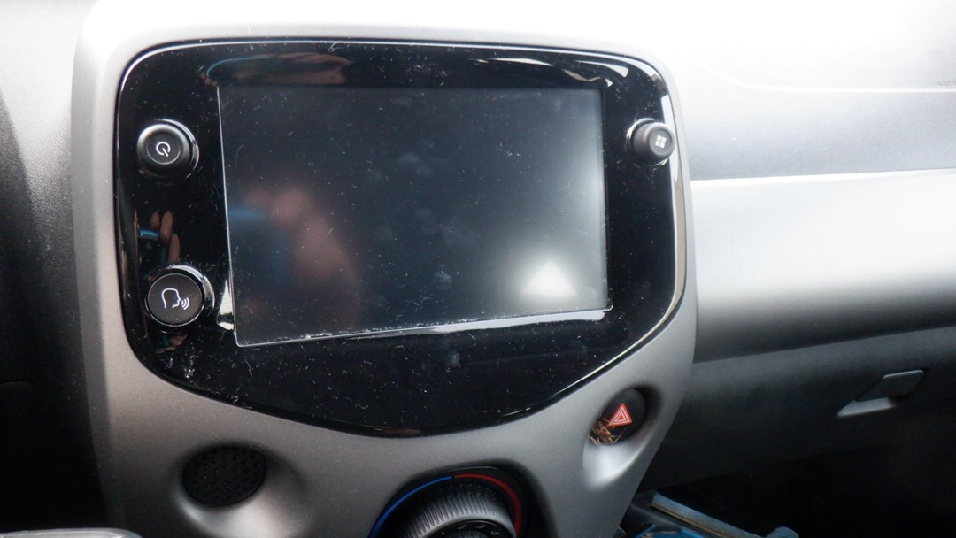

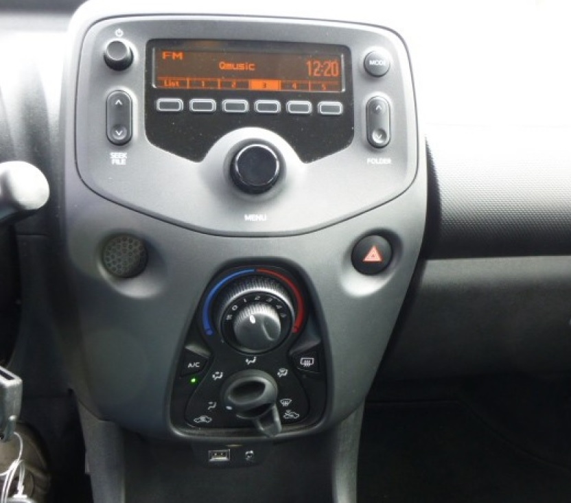

The only thing that's truely missing in the car is a nice head unit with android auto as right now the basic radio is installed (see picture attached). I've been looking at aftermarket head units to replace the stereo, but after reading this forum i've decided to go another direction and get me an OEM head unit with android installed. I've actualy managed to find one at a local breaker (see second picture attached) but i've got a question about installing the unit..
I know it's a perfectly doable straight swap with the navigation unit from the 2016 aygo's, but so far i've not been able to figure out if it's possible to swap the basic stereo with this head unit. Does anyone here know if this is a plug and play install?

"Just google for images of the back, dummy!", feel kinda stupid i didn't think of this myself -_-'
So it seems all should fit making this an "easy" swap.. Guess i'll give it a go. (managed to find one at €250)
