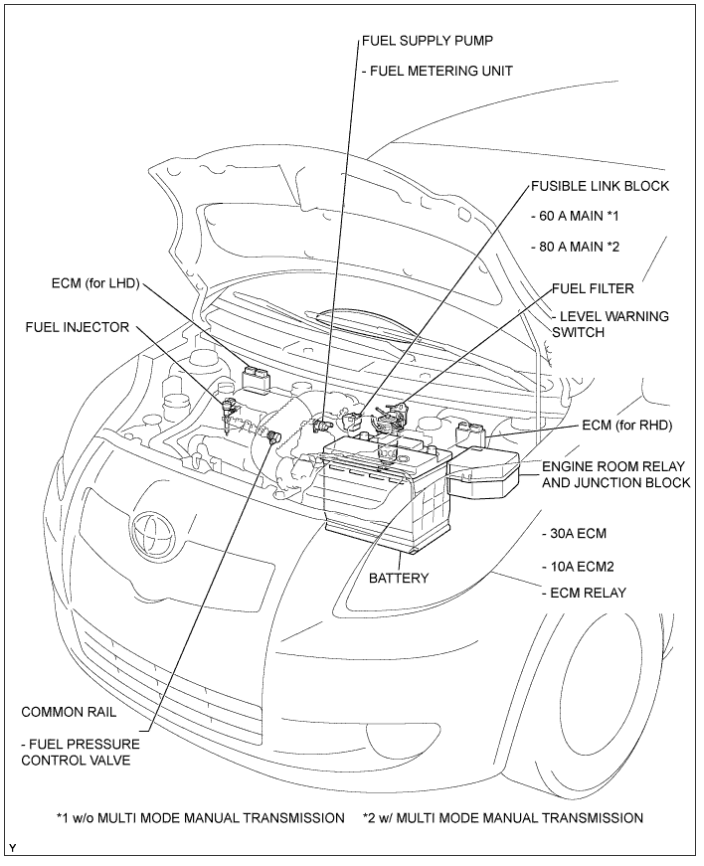

A 2006 Yaris will be a MK2 not a MK1 as pictured above and Toyota moved the filter, see:
