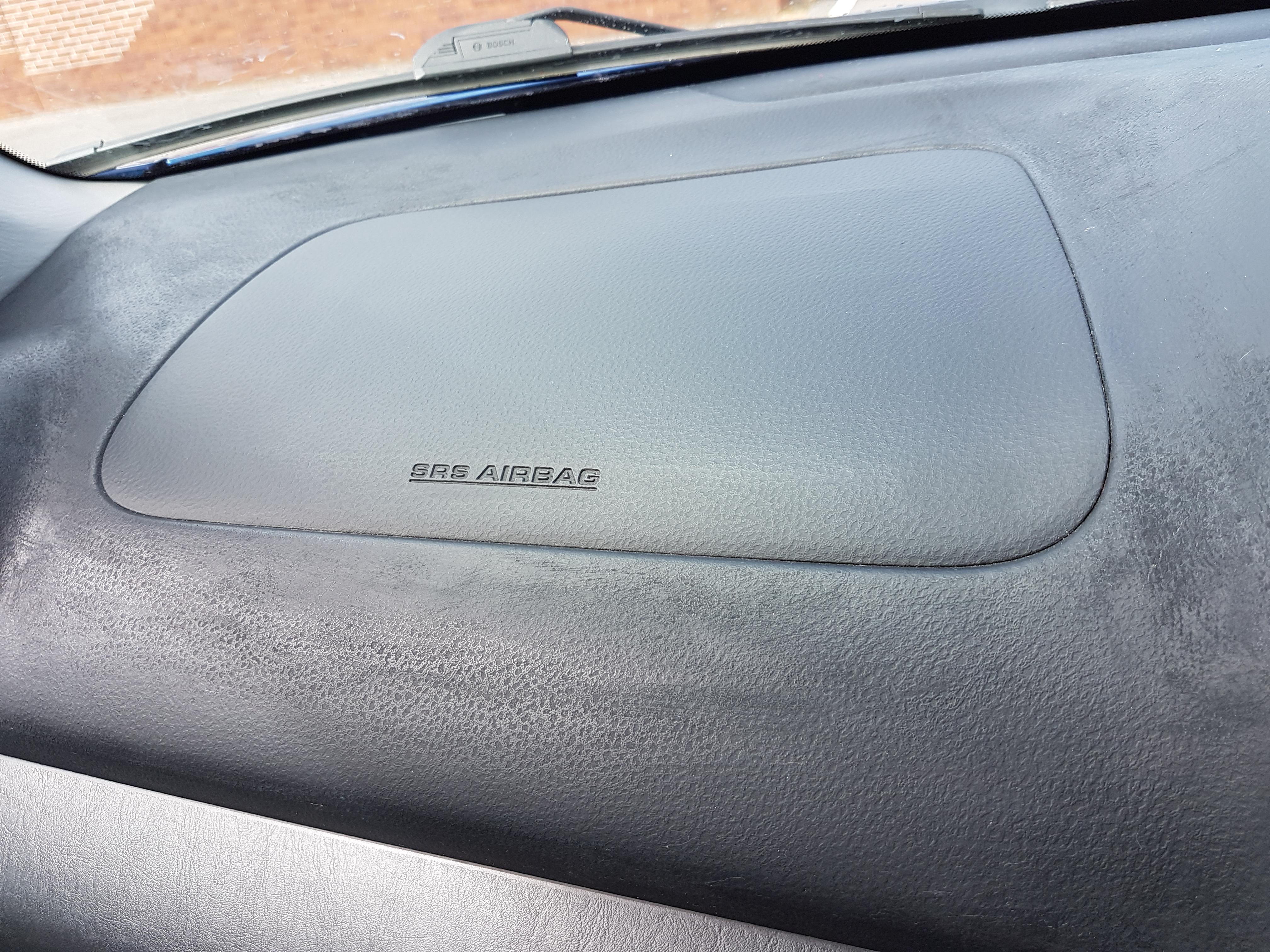

Whole dashboard is getting sticky, leaving marks and indents if anything touches it, even my fingerprint. I love this car, can anything be done to stop it please, return it to normal, or even replace it?
Try a microfibre cloth, very hot water and detergent. If that doesn't bring any surface contamination off then the plastics might have deteriorated (sun exposure or inappropriate chemicals/cleaning agents used in the past).
Thank you Mooly.  I have followed your welcome instruction, cloth now stained with black stuff, and dashboard is dull, streaky, but still tacky, so I assume the plastic is perishing.  The Air bag section is fine, still in full sun, but feels like it is harder plastic, as lower dashboard is.  I wonder if there is a sealant to protect what's left?

If the plastic actually feels sticky then that sounds like some deterioration of some sort has happened. I wonder if anything has been applied in the past that has caused a problem.

Hi, thank you for time. I have taken it to Toyota, they've never seen anything like it but guess the sun is reacting to a cleaning  chemical.  It's only had Mr Sheen!  They have a specialist interior detailer who will give me their view, and maybe fix it. Meantime I will continue with the hot washing. Thank you again.
