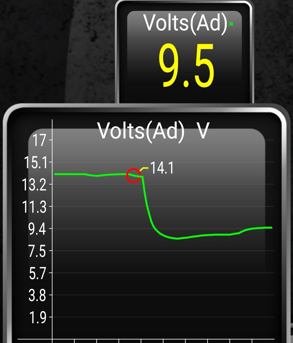

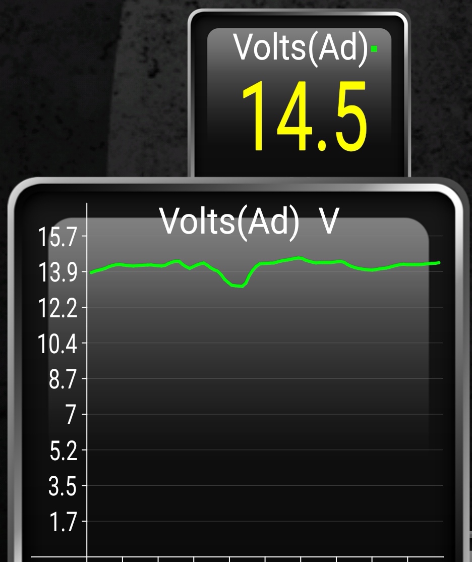

Alternator looks good while driving, but look what happens as soon as I kill the engine!!! 😲🤣
Your Battery is dead. The volts measured seem to crash after the car engine/alternator stops running.
new Battery...job done
id reccomend a 063 size varta...about 45£ posted on eBay , they perform very well
The Battery is goosed, if you're having to jump it - low voltage will make the ecu and other modules freak out
