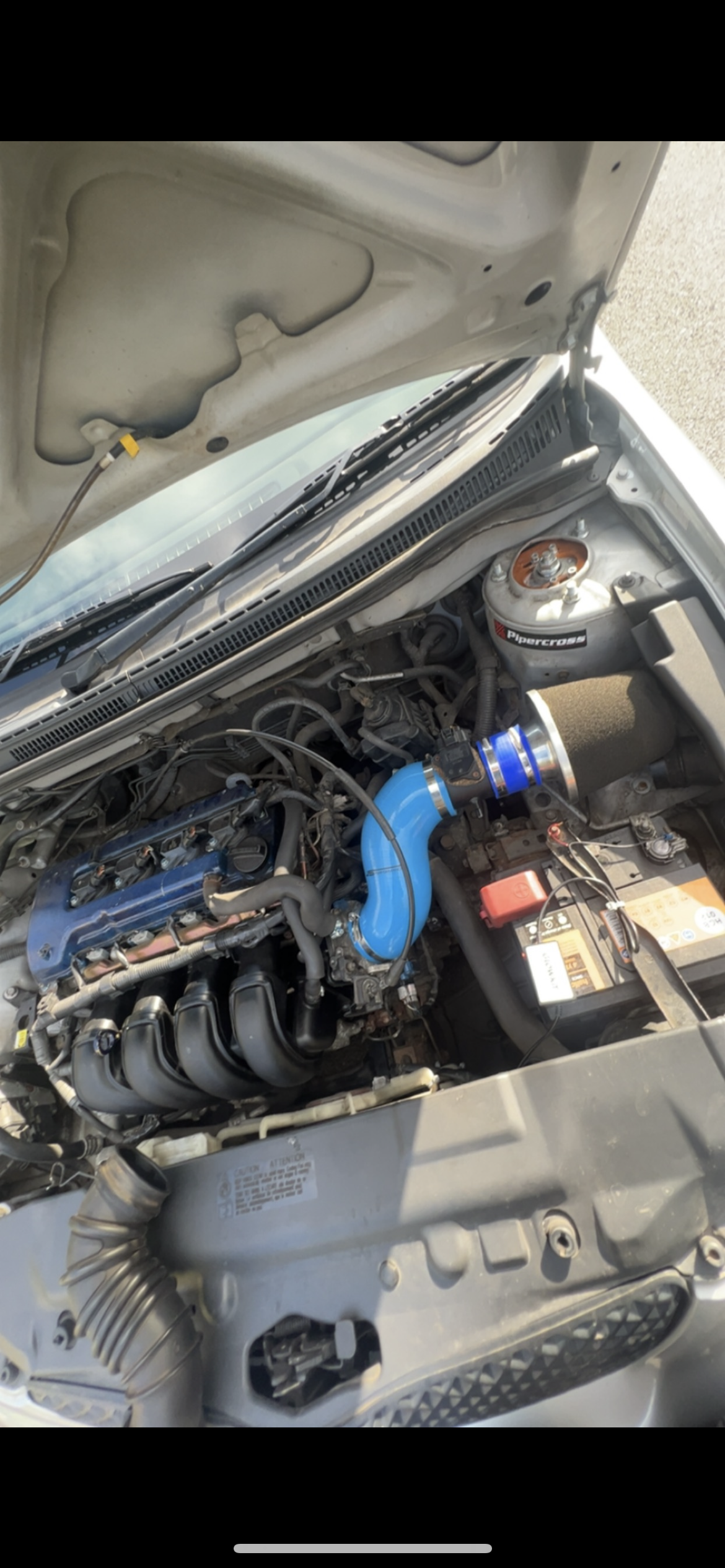

the car is now running 140bhp on the dyno with a full induction kit and fuel injectors, 1zz intake manifold and throttle body. Ignore the mismatched colours

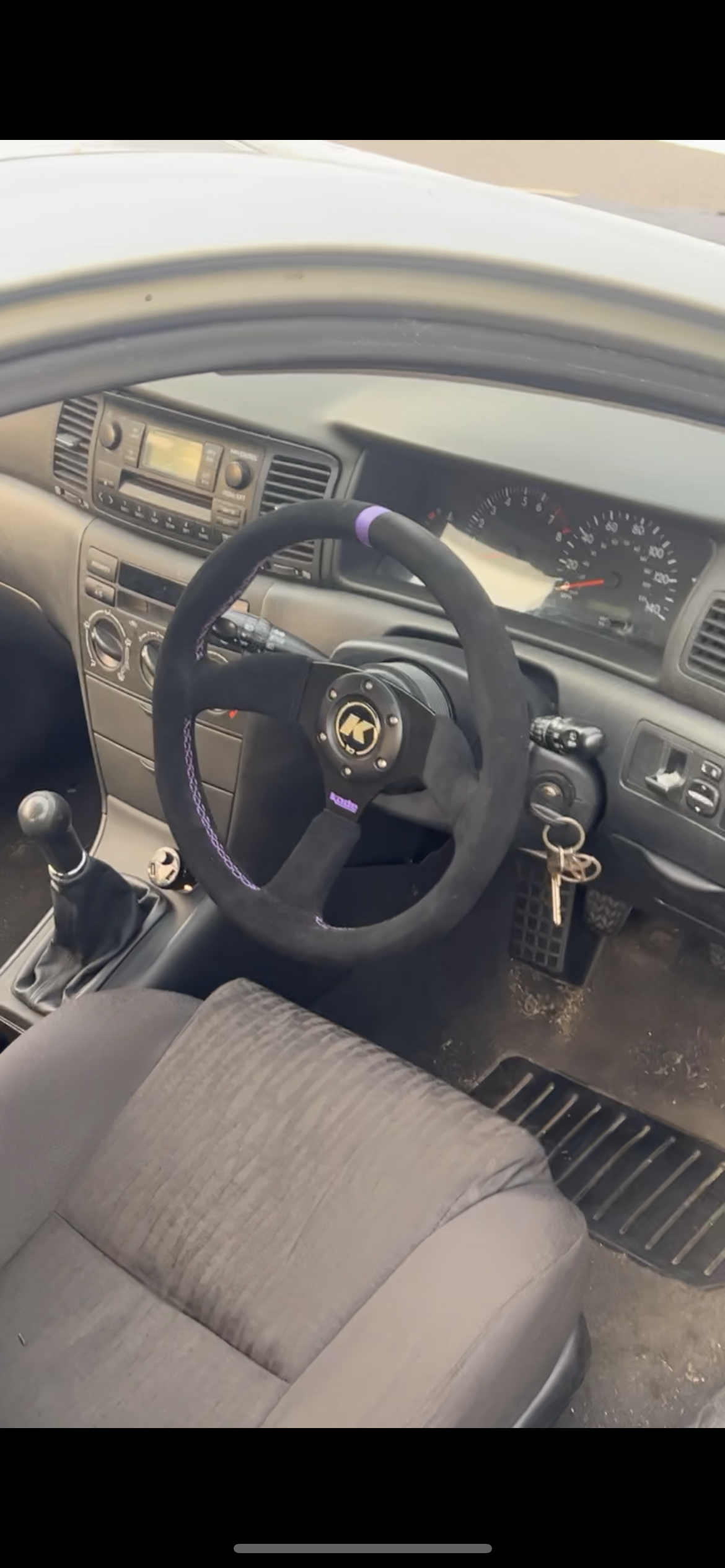

it also now has a nice aftermarket steering wheel
