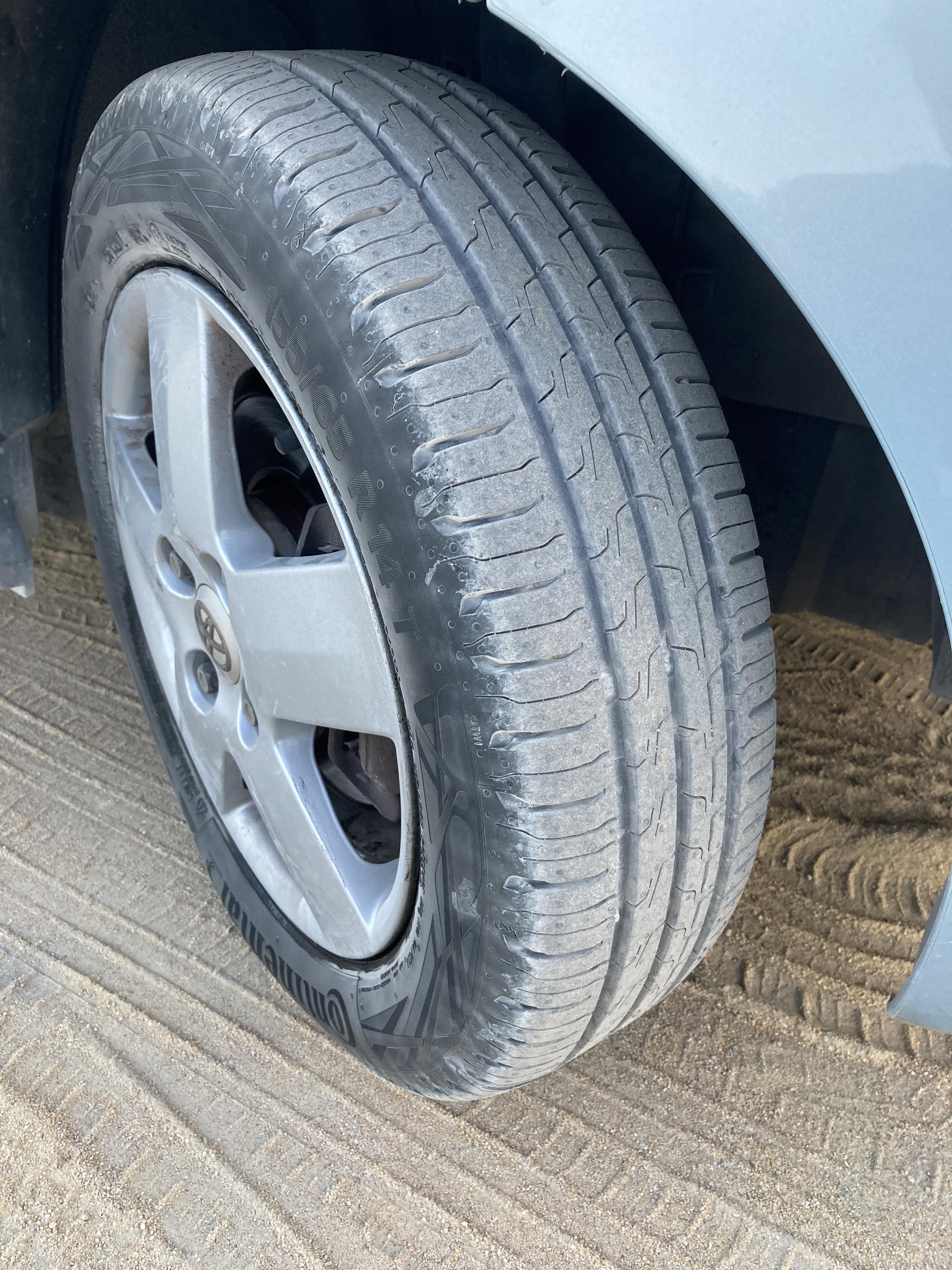

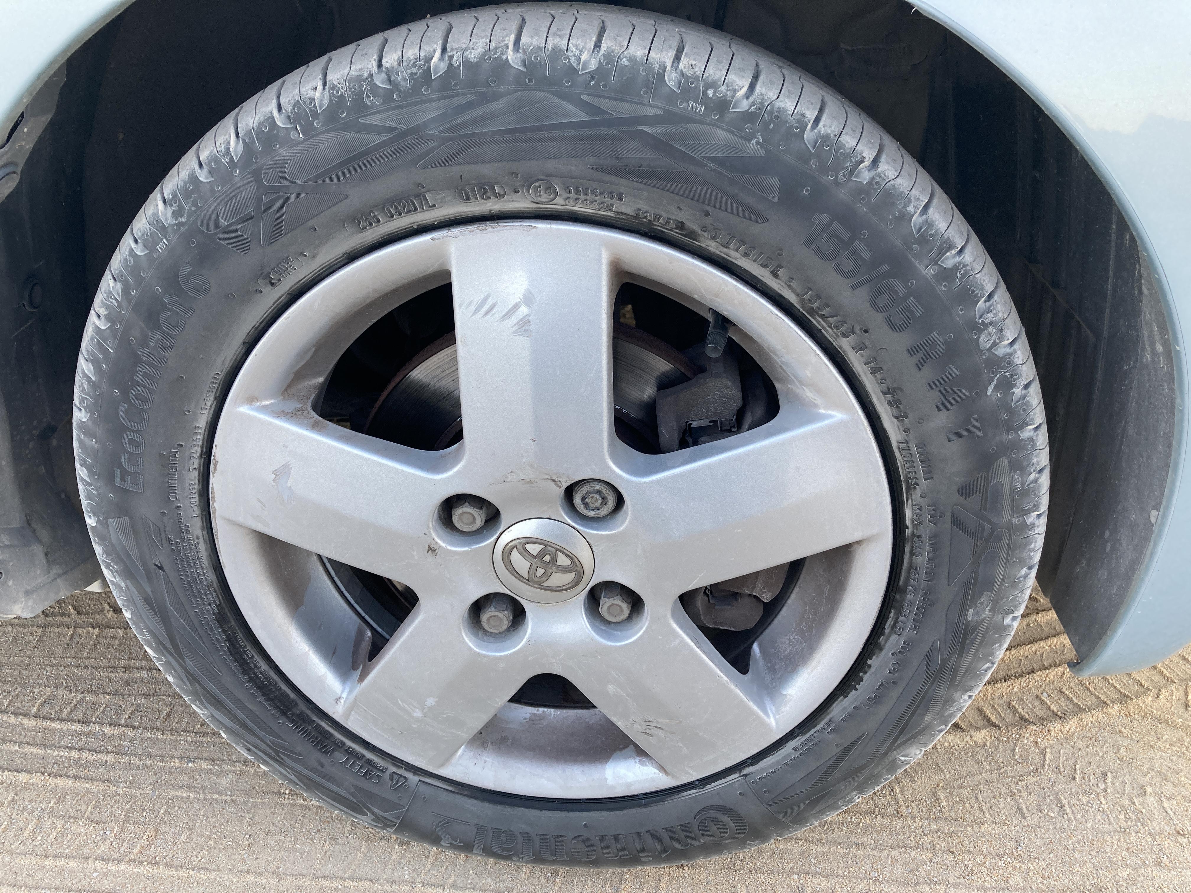

Hi,
From your description the way the car had behaved sounds like understeer., this can happen in very unexpected circumstances on dry roads and sunny days at relatively low speeds too. I had seen your front tyres from previous posts and they look lower on thread in comparison with the rear one and this can increase the risk of understeer by much, especially when driving on loose gravel or dirt roads., or going over metal drain covers., anything that is more slippery than dry asphalt. If you can and want you can swap front with rear tyres and drive the car like that for a while and see if this happens again, but you need to be careful as the risk of oversteer will rise up with worn out tyres on the rear. Best to buy all 4 new tyres and get your car checked for wheel alignment and suspension in a garage., if on the budget just buy two new tyres same or very close like the one you have on the rear. 👍 Here more about understeer and oversteer
