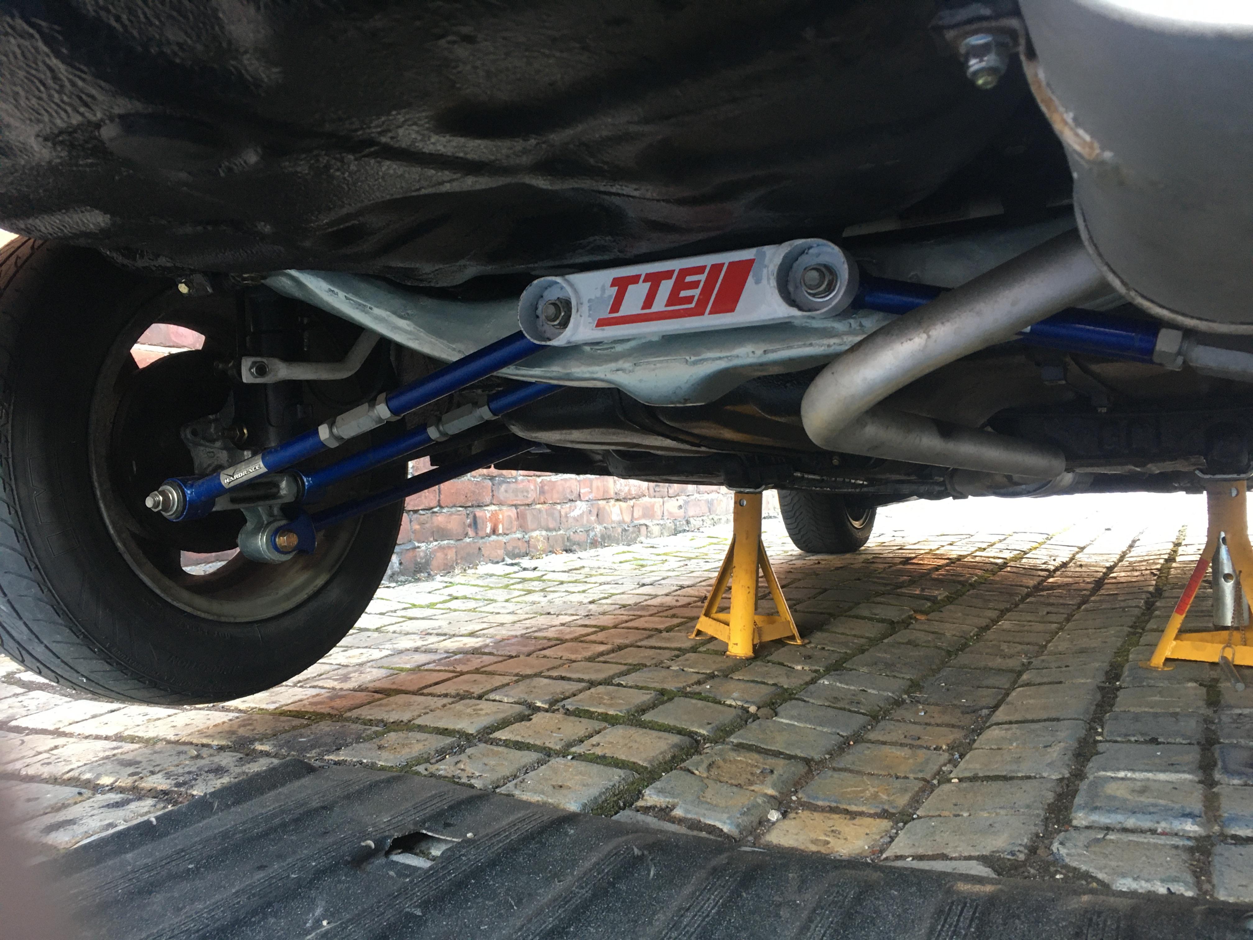

So , my little Japanese built Toyota Corolla got sorted over the summer , full tidy up underneath ,all rust treated and sorted and a coating of tinted upon raptor coating , all rails and cavities are also  waxoyled now , rear suspension fully overhauled with rear  crossmember and rear hub carriers shot blasted and painted , new hardrace control arm kit and an ultra racing rear anti roll bar and arb bushes to finish it off
The centre braces (bits with TTe logo on were fabricated by myself ) new rear drum backplates ( from Japan) and all the rear brake overhaul kit is here now ready
