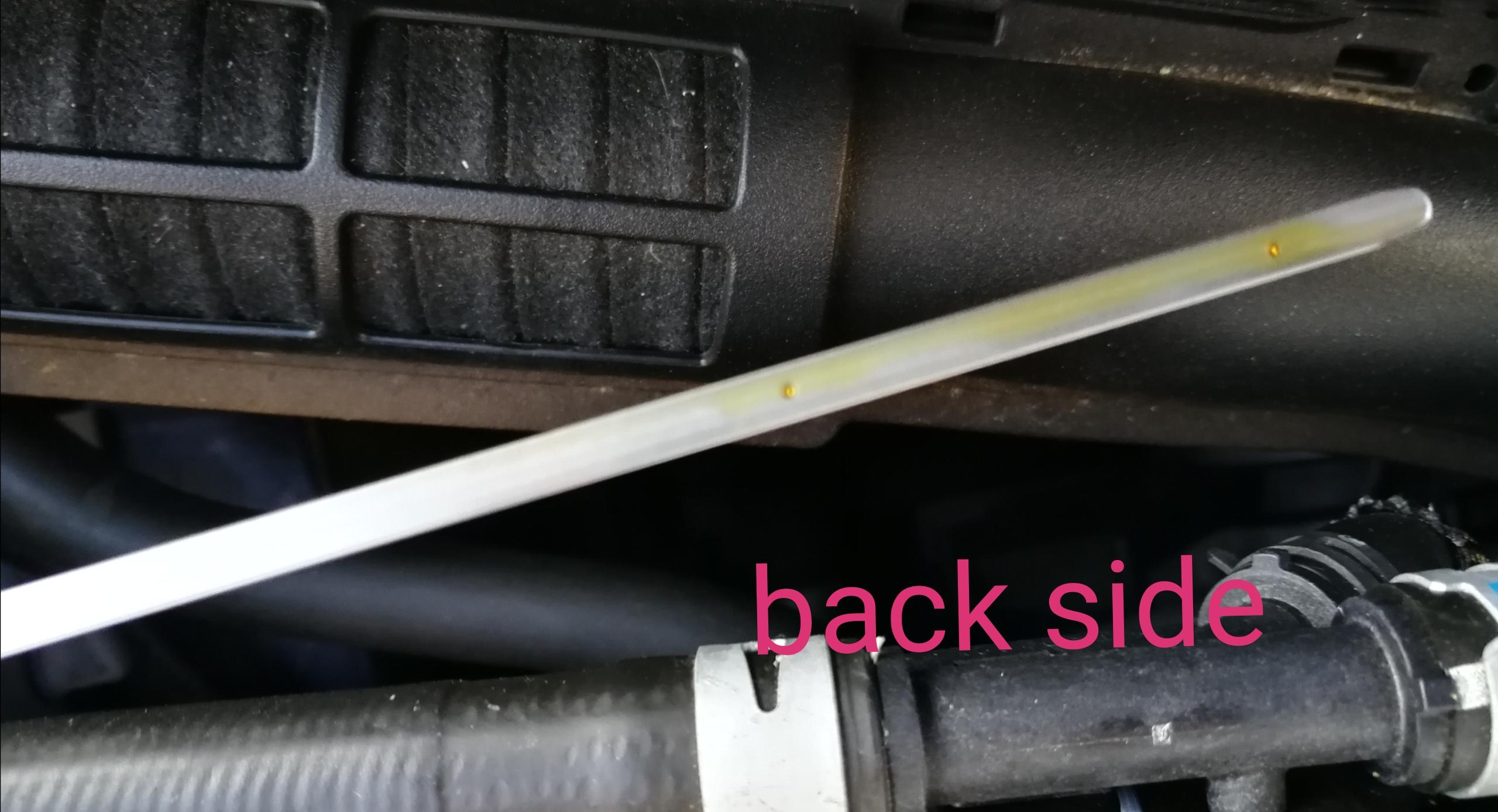

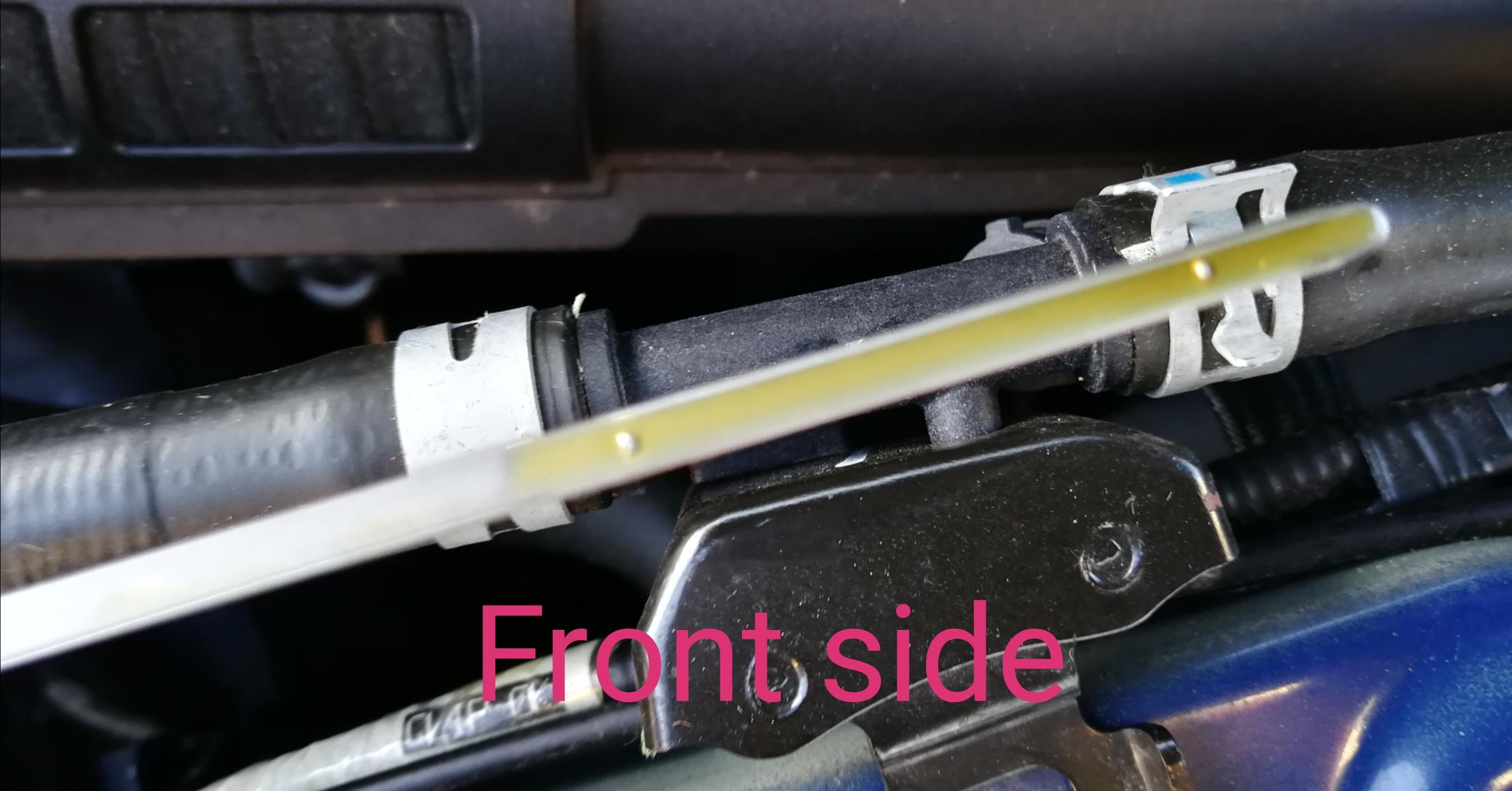

Hi, can anyone confirm me if the engine oil was overfilled? it seems to me it was, but i am not 100% sure as the oil level on both sides of stick is not exactly same, i checked the oil on numerous times in the morning without driving, the oil level on the front size of the stick was always over the Max, but the oil on the back side of the stick was not clear. I used to check the engine oil after service at my local garage for my previous car, and sometimes I did find they over filled the engine oil, but i never do  the check after the service at Toyota dealer garage. my car had an intermediate service on 2 April at a Toyota Jemca Centre.
Looks overfilled, but not by that much. I had a cousin who had 1L overfilled.
I'd just buy some cheap tubing and stick it into the dipstick hole, the longer the better, you dont want oil in your lungs when sucking on it.
That is, unless you have one of those fancy vacuum engines.
Maybe someone has a better/easier solution, but this one will work.
Looks like maybe 100ml overfill only.
As suggested, it does appear to be slightly overfilled. However, I find that the indicated level, like in the pictures, differs front and back!
It does need for the car to be on a level surface. Even a very slight slope, either way, does change the level on the dipstick.
I, personally, would not be concerned about those readings.

The car is parked on the drive (level surface), I checked the oil level on numerous times recently, the oil level was always like the photos shown. i guess the back of the stick touches the wall when you take it out because the stick does goes to the engine straight, i think the reading on the back is not reliable, it was ~1cm over the Max, and must be overfilled more than 100ml. I work in the lab, and know how much of 100 ml likes like😄
Update:  called Toyota Jemca service department, and was asked to pop up with my car. the service adviser checked the oil level, and  admitted it was overfilled but said it is ok and said just ignore it, I asked him to give me a report for what he has done and what he has said to me, he then said he was going to reset the engine oil level for me, however, after resetting,  he refused to give me a paper work, having argued with him for a while, he finally agreed to print out a service report for me. I just want some evidence in the case something happens to the engine due to the oil overfilling.
I have done about 1100 mile since last service on April, but most of the miles were done on motorway (~700 miles), I hope it didn't do any harm to the engine.

It is overfilled indeed, my calculations are 150 maybe a bit more since the difference between min and max it’s around 1000ml this looks like 1/5 of it , the advice with syringe and tube will be my choice of doing it. Not a big deal if you leave it too but you may find oil under the throttle body in the intake manifold and that usually happens when engine oil is overfilled or pcv valve is faulty, these engines has built in ‘oil catch can’ that catches probably nothing and a PCV valve low the engine block, and when overfilled it’s even easier oil to escape into the manifold. Your one not too bad but you can suck it out and tell us how much it was 😉👌, skip to 5:00 for the pcv info.
