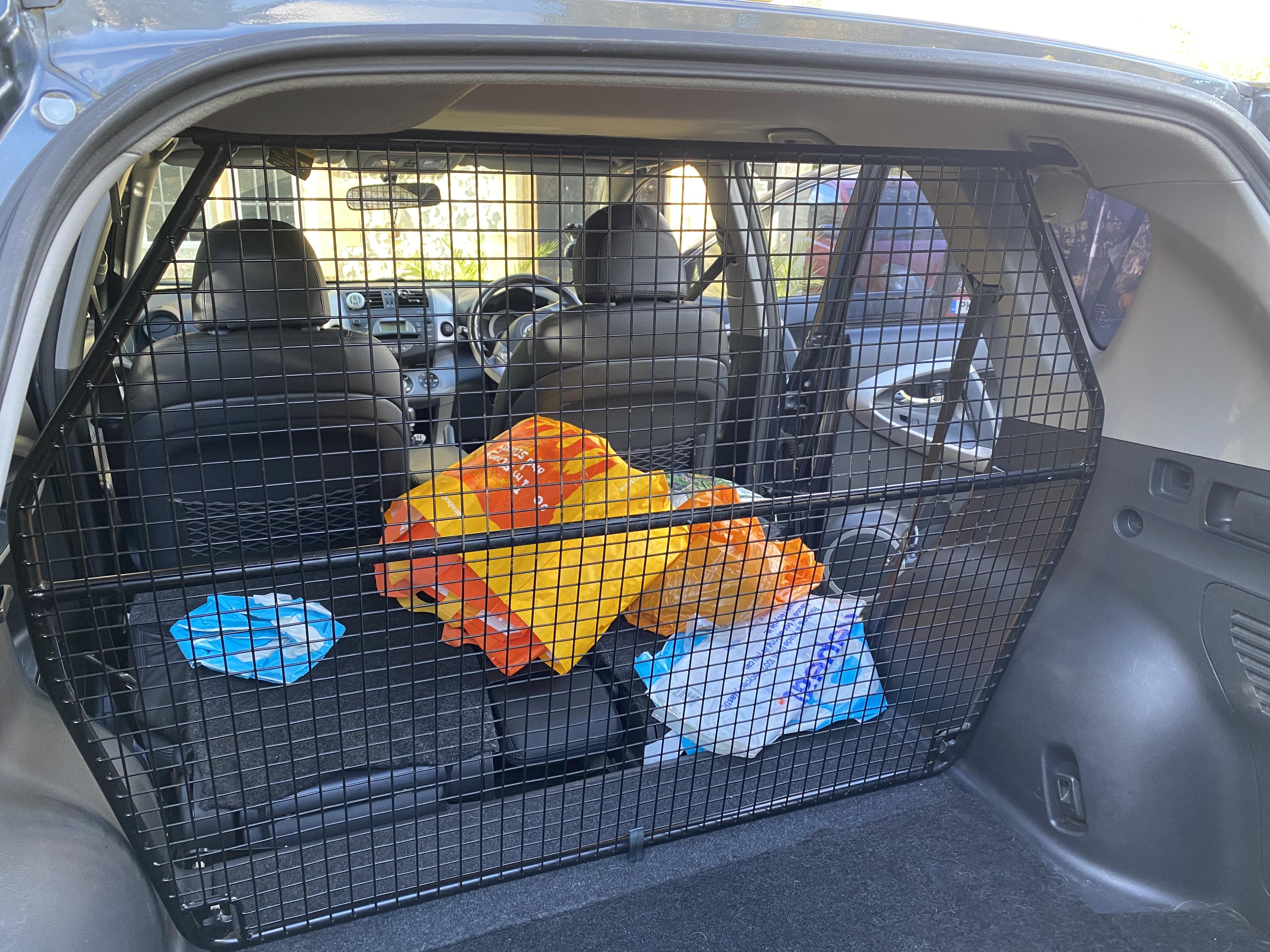

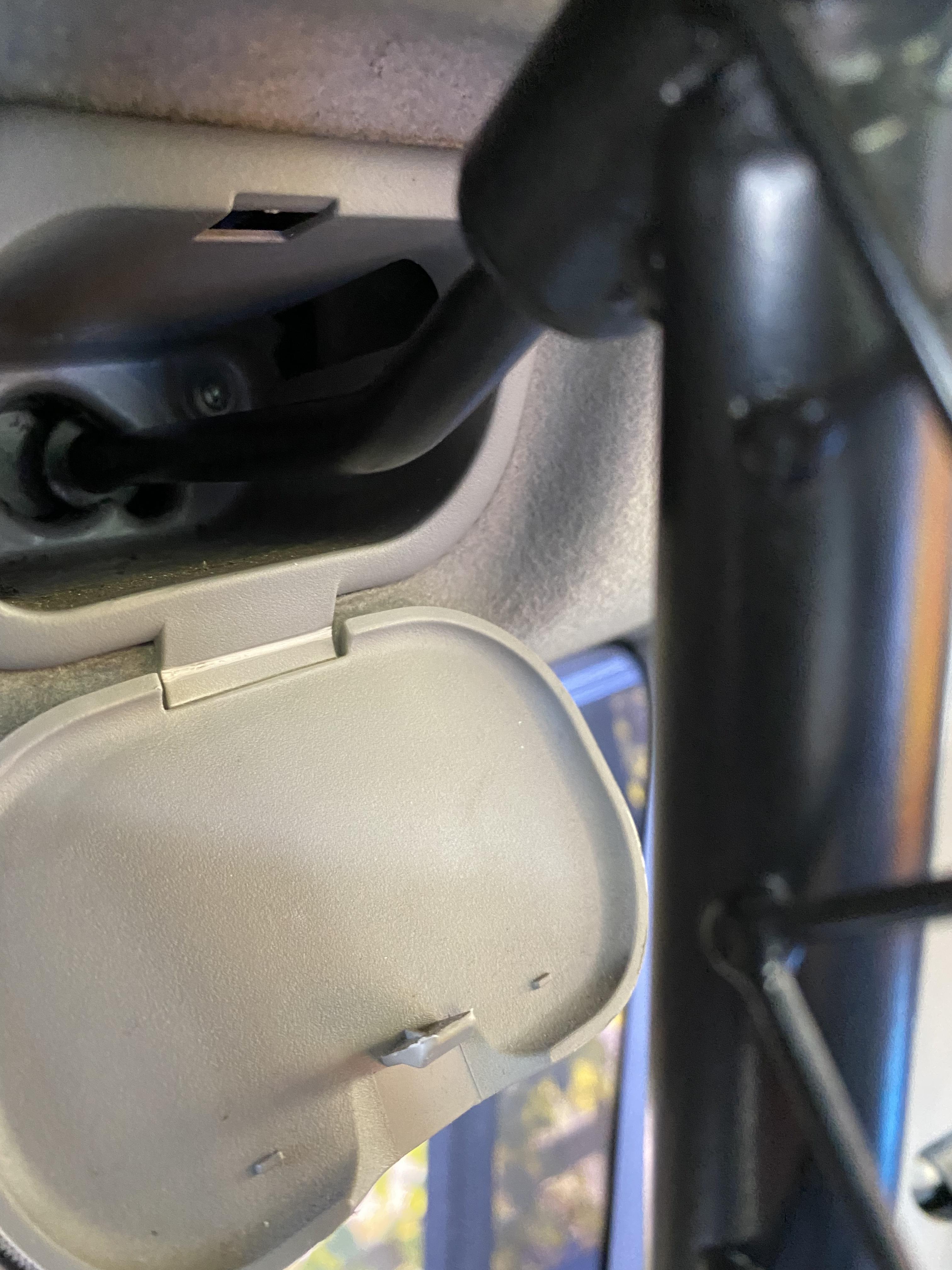

06 plate Rav 4 with a genuine dog guard that I have spent two hours trying to remove.
Please help as I can not release the spring loaded bars at the top to give me enough room to remove it!

Deep breaths needed ... and a picture of the problem might help those of us who have never seen one (while you await a response from someone with experience of the issue) 🙂

Different car, different type, but a counter intuitive technique. I had to push the guard towards the side I was undoing rather than pull the attachment.  This reduced the tension and enabled me to unseat it.

It is a bit fiddly but certainly doable, I now manage to put it in/take out in a few moments (only use the guard as a luggage compartment separator on my travels to Europe when the boot is filled to the roof 😂). You need to push both sides in after disengaging them from the narrow part of the plastic bracket and by twisting and turning them and the guard simultaneously you'd be able to catch just the right position for it to come out. Deep breath and a bit of patience is definitely needed. Good luck!
Pull the carpet out, lift at the bottom and push/pull forward and slide the top forward, so both parts are out of the key way, it should then be able to be released
