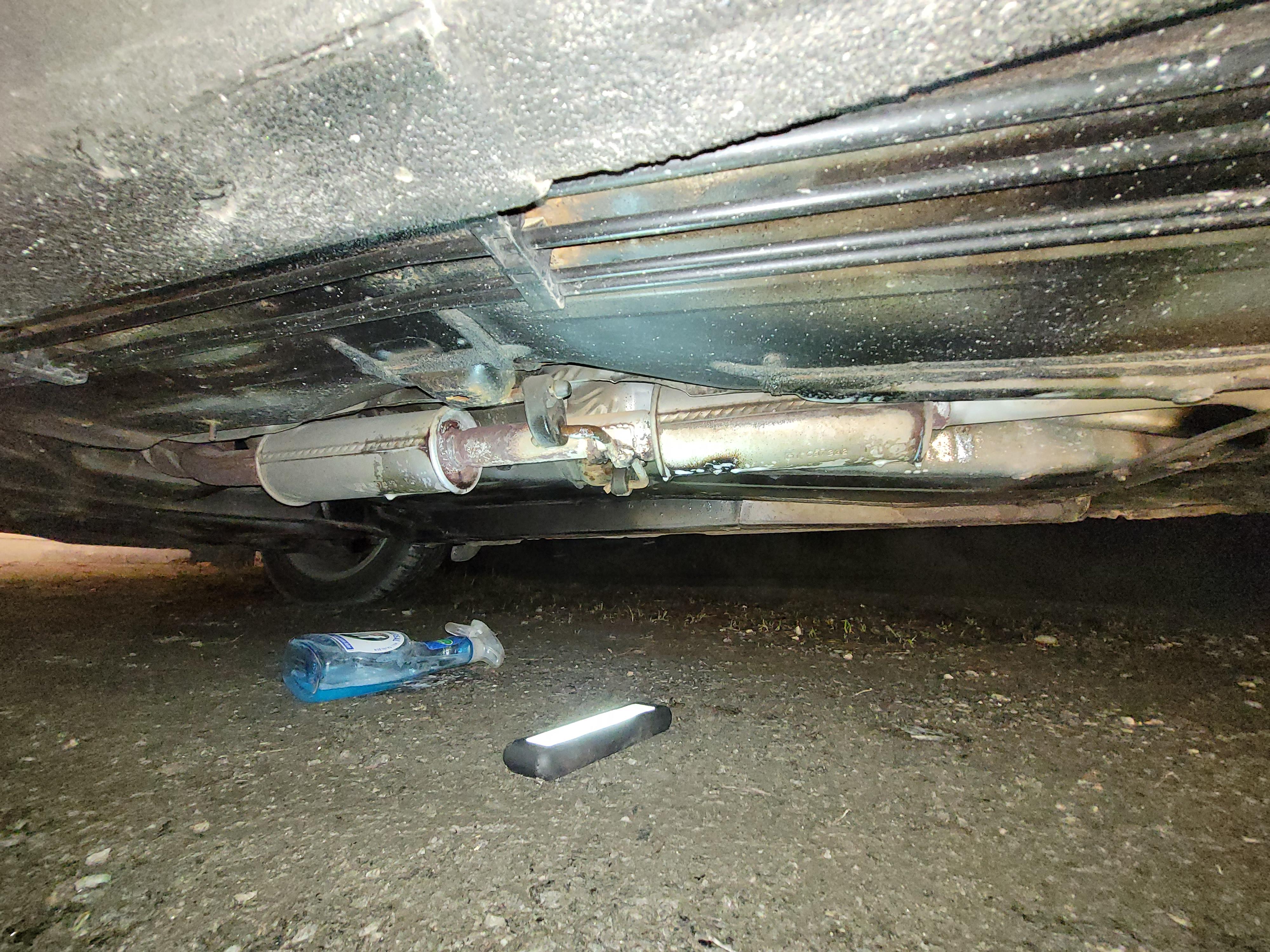

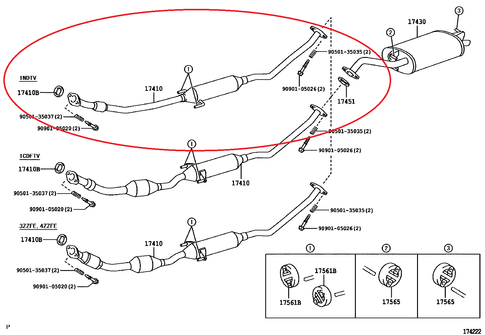

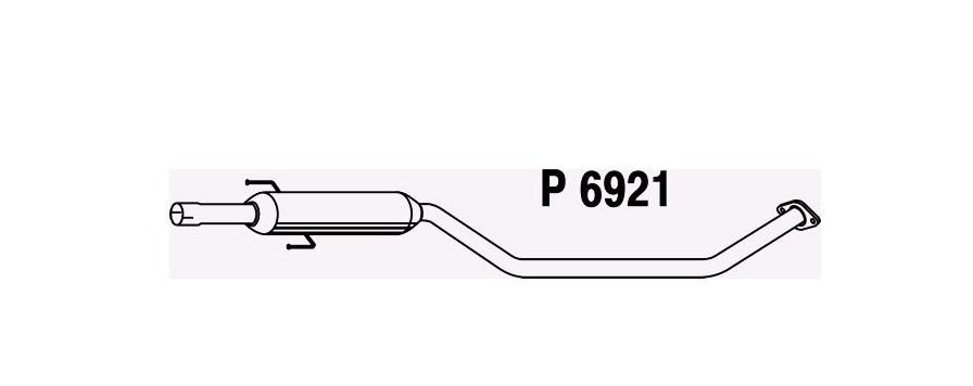

Hello.  And tnx for having me as a new member. Im trying to sort out a exaust leak. And dont find the right parts.   I think both of middle mufflers are non orginal, and welded on place.   Can i just use a back part, and delete the front midle muffler as the pictures says? and by this rear peace

Which model corolla is it that you have,the exhaust circled is for a 1.4 diesel second one is for 2.0 diesel and last one is for 1.4 and 1.6 petrol
Tnx i dident know that. i have 1.6 petrol.  It dident show on the website what part they actual meant was for my car. Just these 3 pictures.
It would be the bottom 1,
I think the 2 boxes on yours are just resonaters to keep the noise down
Tnx for all the responses Tomo. I dont find a OE part fitting, on the left resonator. Could i change it with some clamps and a generic one?

You could yes,
You could even put a straight pipe in place but it would give the car more of an exhaust note
