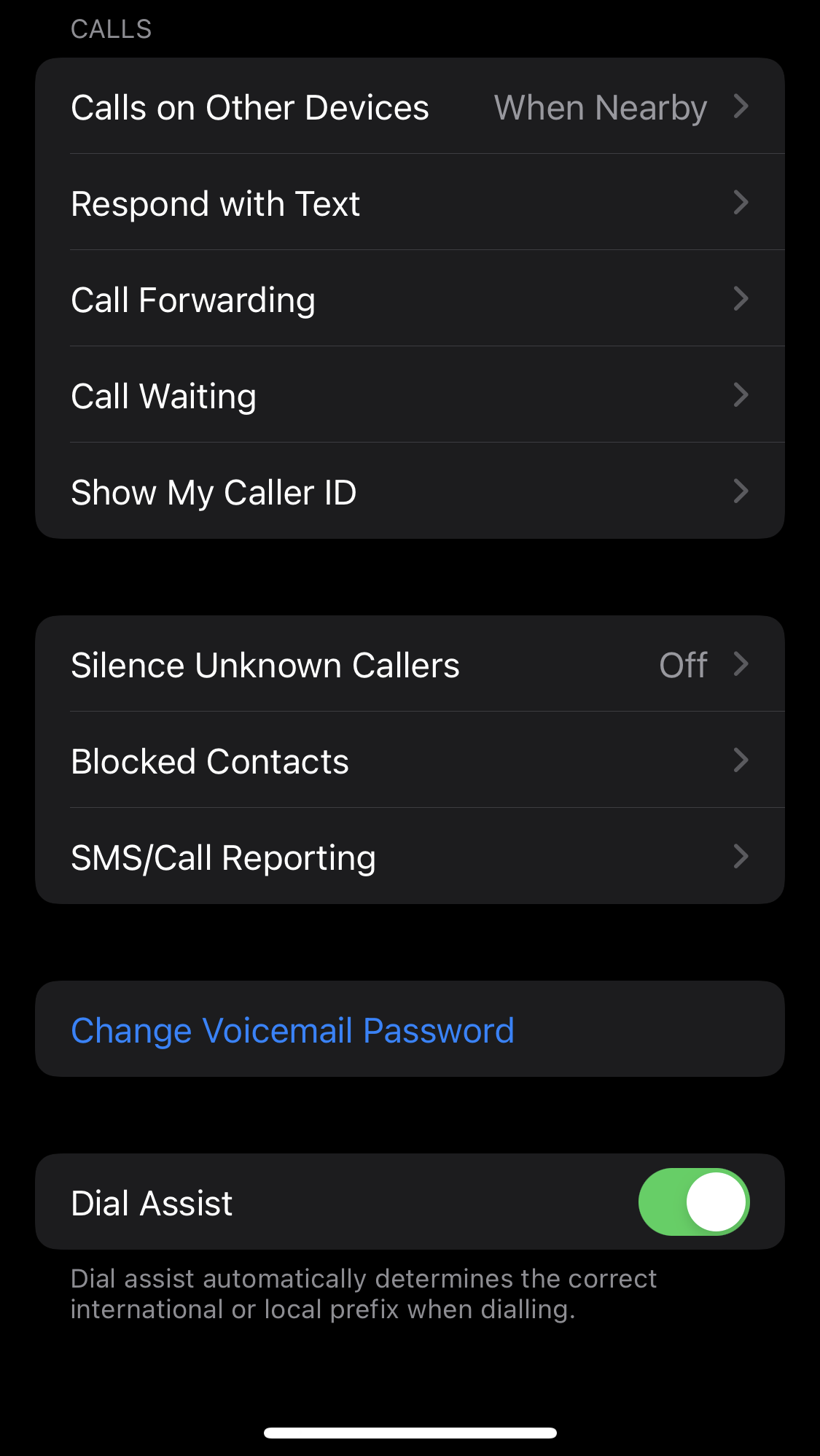

Just store all numbers without +44. I'm fairly sure Android phones have international dial assist which will automatically add the +44 and remove the leading zero when roaming.

Dial assist. I’ve been storing numbers in international format for years. There’s always the remote possibility that the phone will get the international code wrong, particularly when roaming near international borders and your phone switches from, say Switzerland to France, or vice versa.

Yes, I should have been more precise. it's an IOS 15+ feature, but for all I know has existed for some time. I've just recently switched from Android to IOS. TBH there's no particular advantage to IOS over Android, and some things on Android are better, like separate volume for ringtones and notifications. IOS is only a better choice if the rest of your world is Apple, IMO.

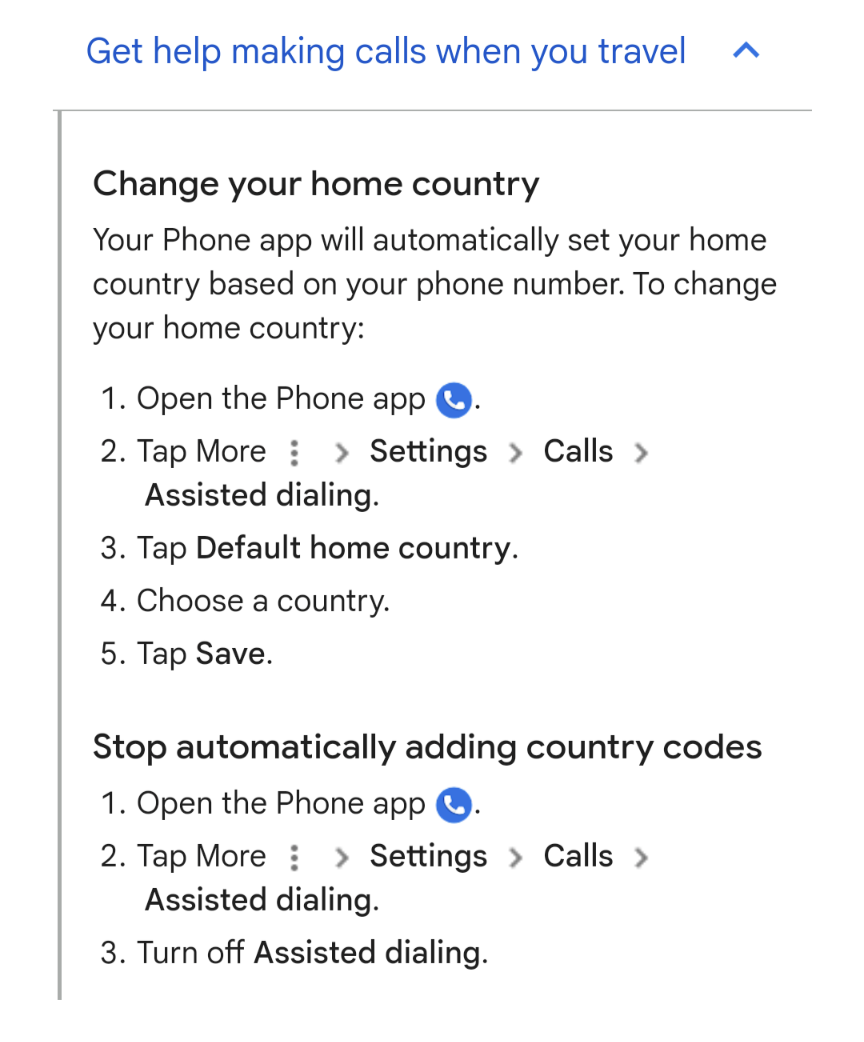

Try going in the phone app, press the 3 dot menu button, settings and it should be in there.
If it's on automatic, I think it changes for the prefix of the country you are in. You can set it for any country you want so set it for UK if you always want it to use +44.

My Android phone, Motorola e6play has assisted dialing. It's located on the dialing app (not the contacts app). Go to the three dots, settings, assisted dialing.
I've had a look at my phone, and dial assist is off. I'll turn it on and see if that makes any difference. As all my numbers are now stored in 07777 777 777 format I'll have to change a few and see if it works. Thanks Stopeter44.
