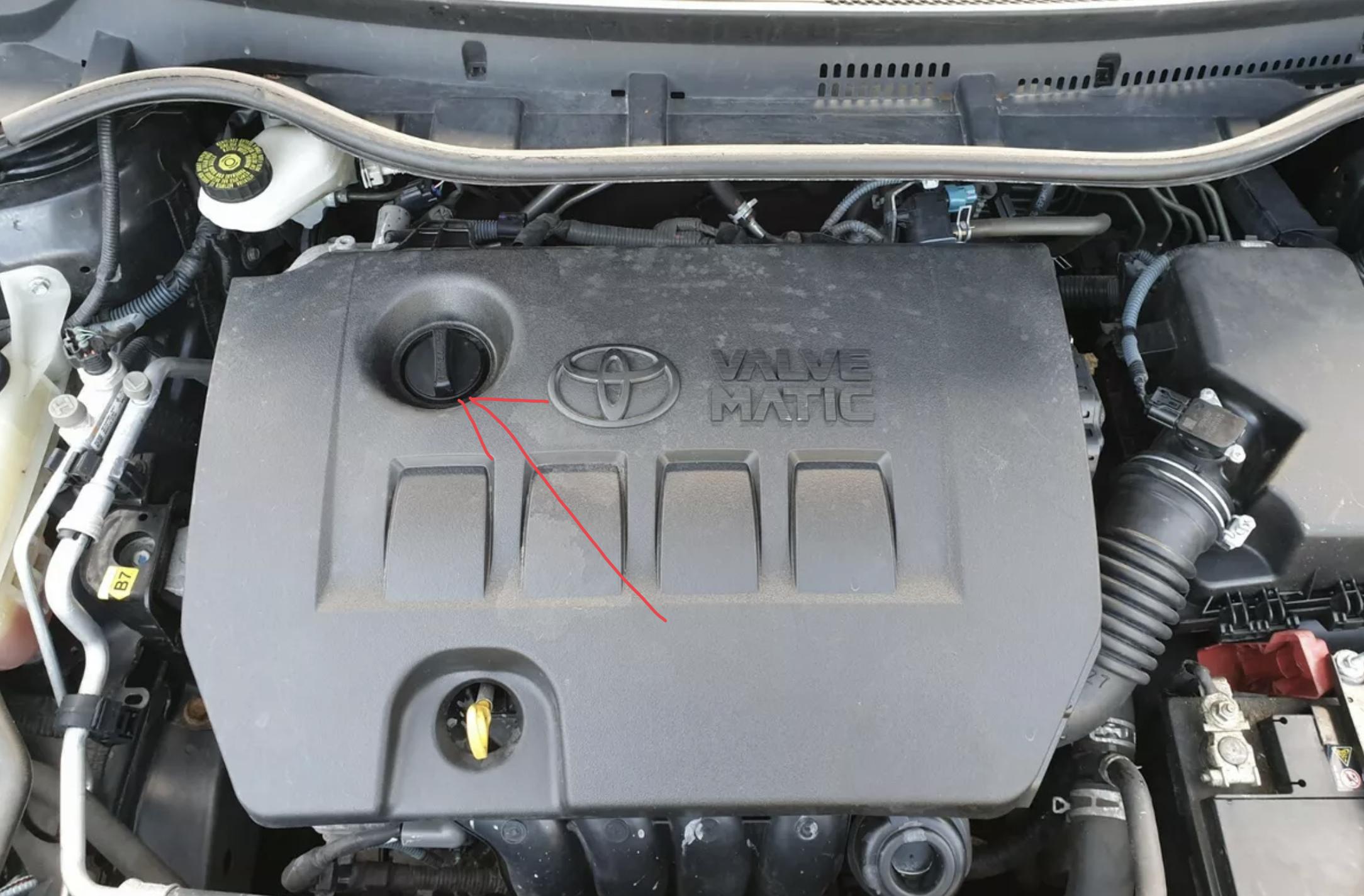

No, engine is very similar constructively to the hybrid one, no electric motors though. Check your oil filler cap it might well say what oil to use. Using a thicker oil grade to reduce oil consumption or provide better lubricating is simply a myth or nick named same as warped brake discs for example. 👍
