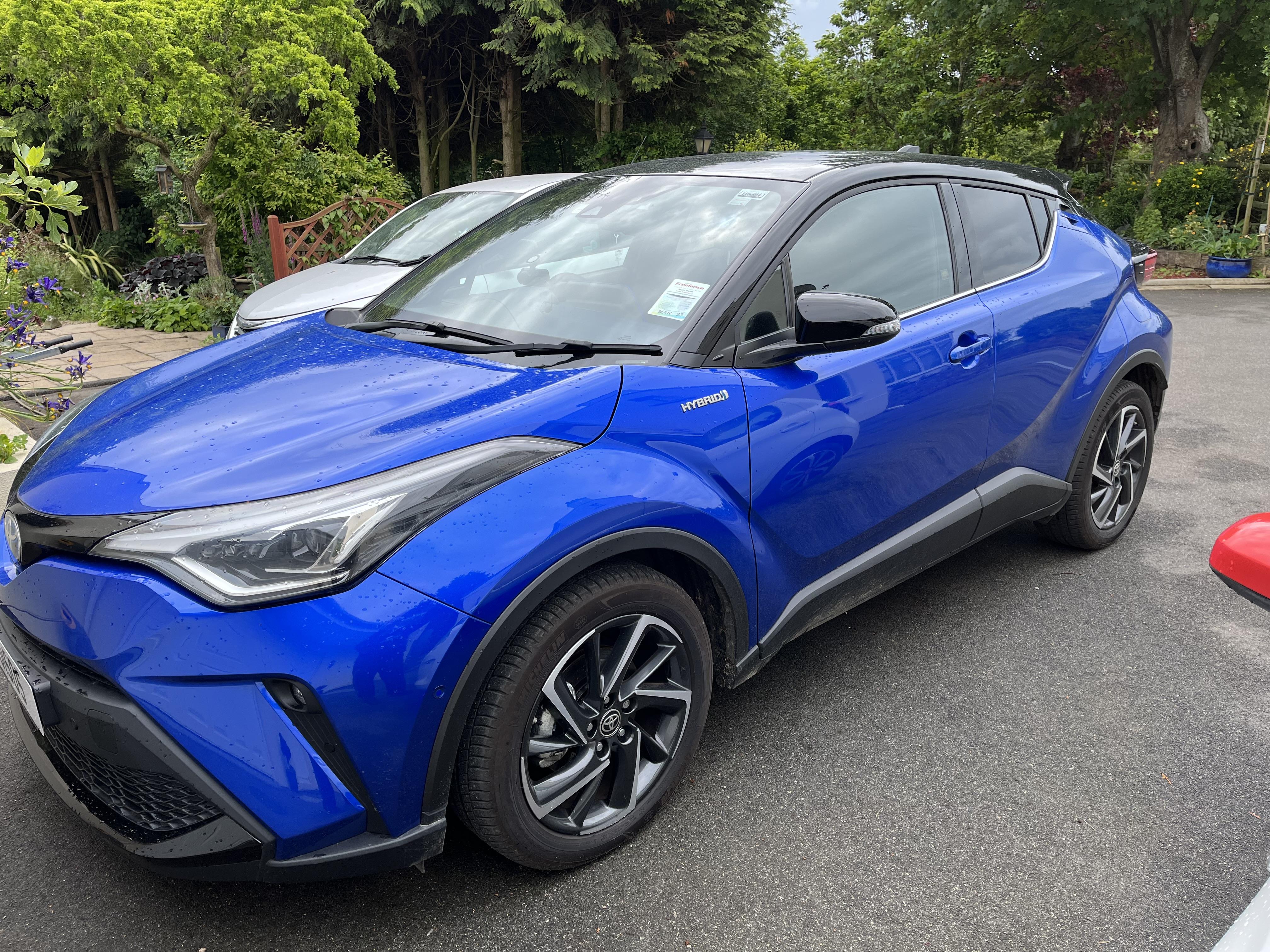

I think here where I am it is known as the C-LUB Bi Tone. I suppose some pictures showing the car and wheels may help with what you have.
7 minutes ago, GBgraham said:
I feel as though I would be rattled also if I got a 15month old car. What is it's registration date?

Not to worry, i have worked out where you are located even the dealer by your pic - it could have taken 3-6 months to land at your location especially if it comes in to the UK for processing then back out
