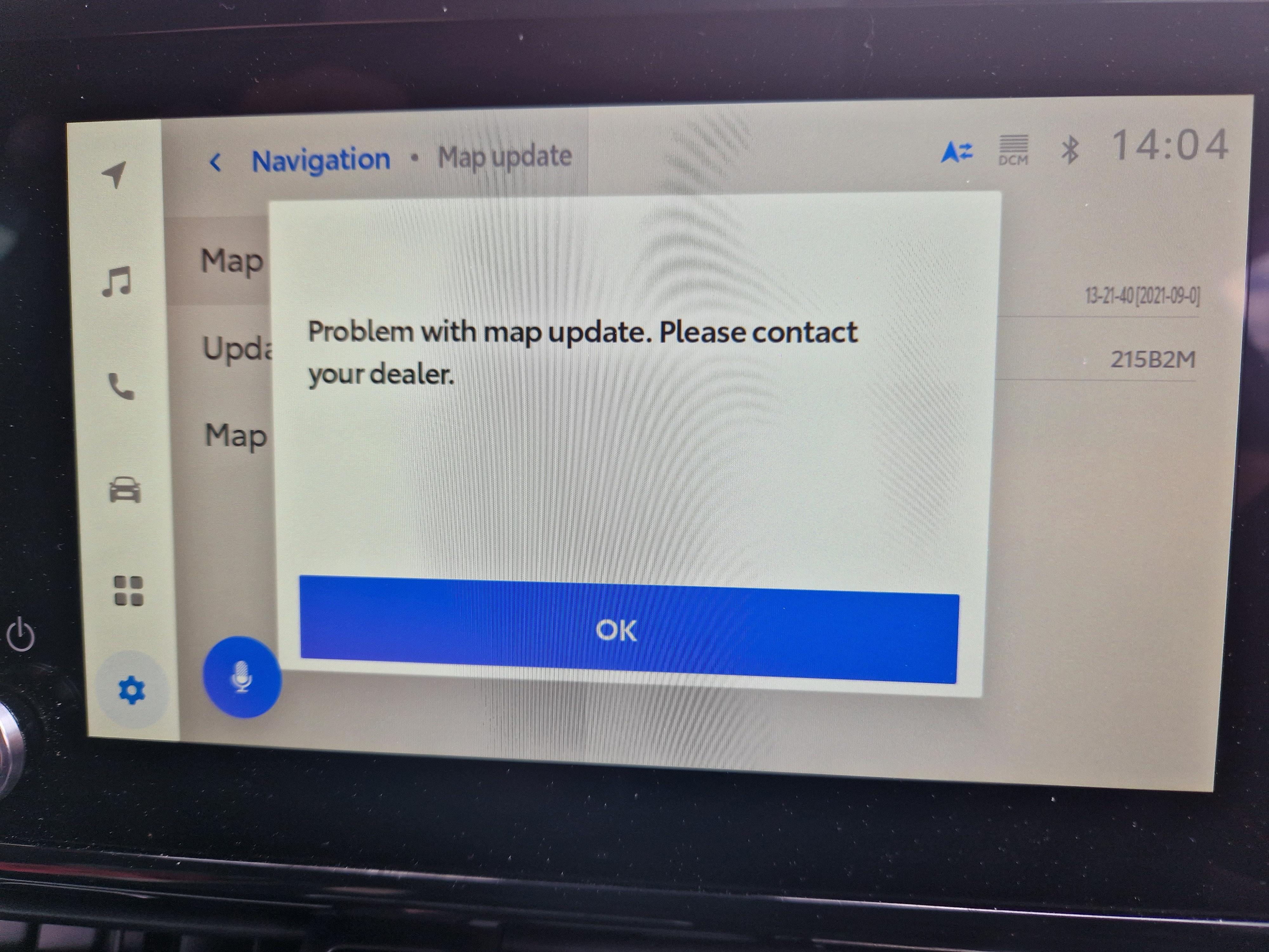

Anyone else getting this message?
Dealer does not know.20220527_140358.thumb.jpg.2e22e8e42a7d830211309fa6a0fbdc25.jpg
It's explained in the Smart Connect operators manual.
The system uses live mapping via the DCM so the maps are always up to date.
The only mapping data stored in the infotainment unit is the back up base map data that is used if the DCM doesn't have a data connection.
These base maps are the ones the dealer can update.
That message is perfectly normal.

Dealer had no idea and could not explain. Thank you for the reply.
