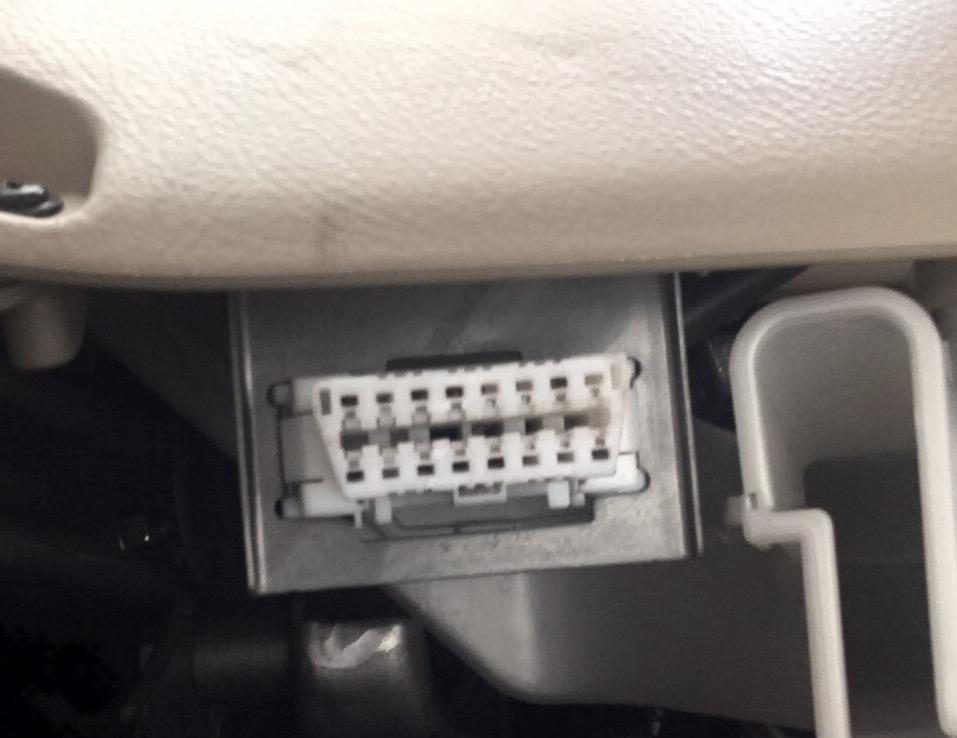

I assume this is it. Under the steering column.
The car is unleaded.
So, a garage should be able to do a test on it and see what the codes are.
Is there a site that once you have the codes, it will tell you what they mean?
Is this something worth buying?
Oh yes, don't know where the wrong connector info come from, codes can be an aid to diagnosis, yes you can look up codes freely but some are manufacturer specific and have their own means
post the code(s) on the forum, there are many experienced members
if you have a community website or Facebook group, you may find someone with a code reader that can help, as i know it's not cheap, quick nor easy to get items up on the islands
